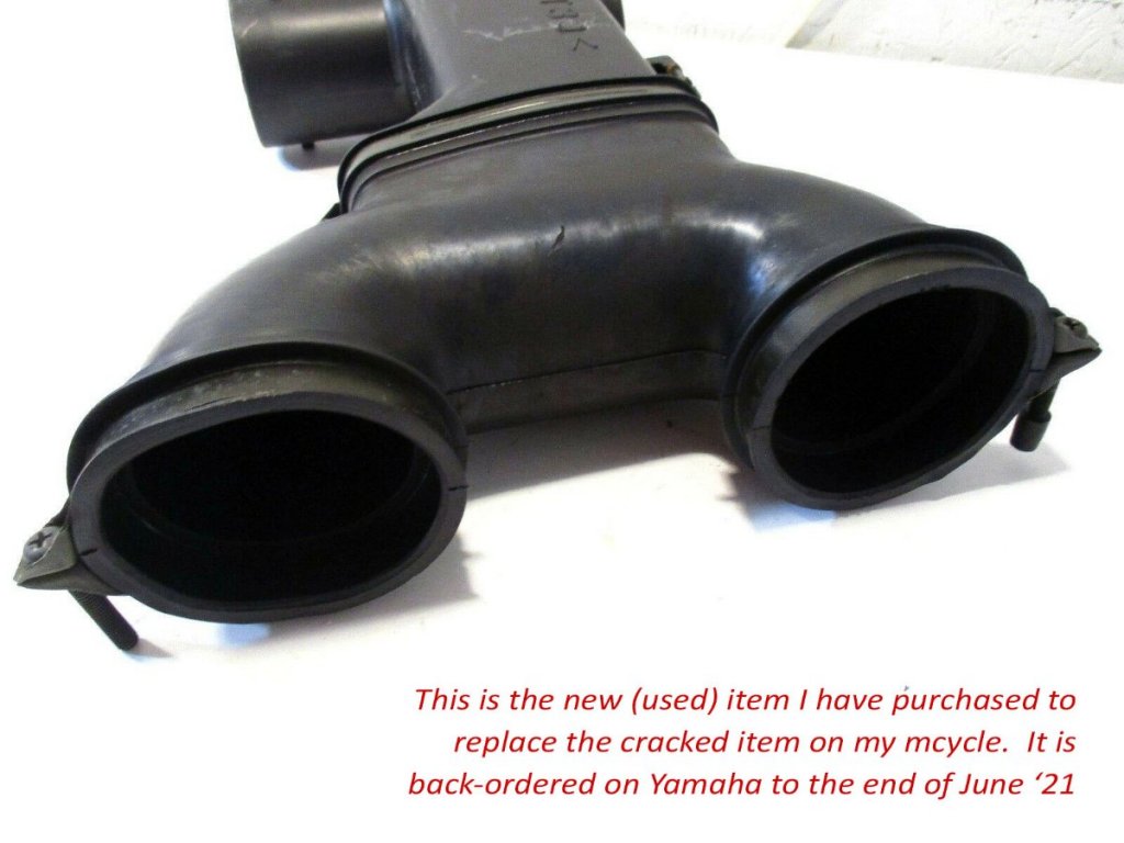

megablok Posted May 7, 2021 Author #7 Posted May 7, 2021 Based on the suggestions here, I took the carbs off and closely inspected them again. Found the following issues: The Joint Air Cleaner 2 (4XY-14463-00-00) was damaged. (have ordered a new part. Its coming in next week. Two of the four Joint Air Cleaner 1 (4XY-14453-00-00) were damaged. I have received the new part. Thank you @RDawson for the suggestion. The Stop Screw set springs (4KM-1490K-00-00) were damaged when I reassembled the carbs (ugh). I have received the new part. Thank you @Freebird for the suggestion. @RDawson, the choke enrichers feel mushy when I pull on the choke know. They are engaged fully. Is that what it feels like when cleaned? It used to be really tight before cleaning. @RDawson. I am replacing two of them (item 2) - I have included a picture. I am not sure if this is a problem. But since it appears worn, I am replacing them. @Marcarl, when I adjusted the sync screws before installing it on the mcycle, the butterfly on carb 1 seems more open than the others. I thought it will get handled during sync when the engine is running. I am going to separate the carbs one more time and reassemble them carefully and see if it works. Maybe I missed something. I plan to sync the carbs again next weekend after I have all the parts and post the updates again.
