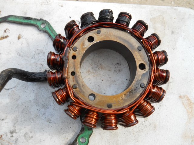

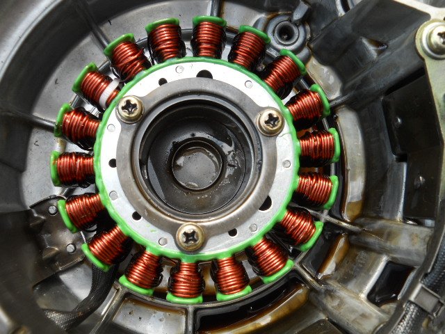

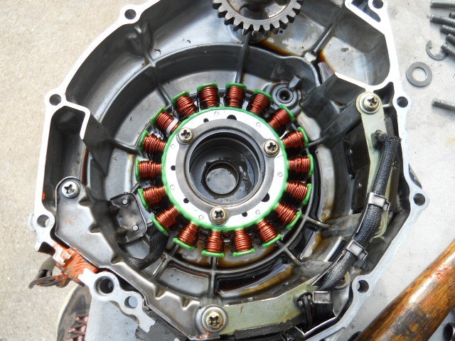

cowpuc Posted April 19, 2021 Posted April 19, 2021 Our weather has been just starting to warm to the point of actually allowing for prepping Tweeks for the upcoming summer without my fingers freezing to metal surfaces anytime I touch them and Tip is almost done healing from recent cataract surgery so I thought I would take a few minutes and begin the Stator install process. In the process of the install I did keep getting interrupted by neighbors showing off the new E-Bikes so I was doubly cautious about making sure I had everything ready to roll before completing the project. After removing the old stator that had gone to ground, installing the new stator in the case cover, cleaning up surfaces, reinstalling the starter drive gears in the correct positions I took one last glance at my work and noticed an opppsssy.. This is test,, can you see what I saw that I did wrong?

Pasta Burner Posted April 19, 2021 Posted April 19, 2021 It’s upside down and there appears to be a zip tie in there. 1 1
frankd Posted April 19, 2021 Posted April 19, 2021 I don't see any RTV sealant on the stator grommet. 1
cowpuc Posted April 19, 2021 Author Posted April 19, 2021 Nobody has it yet.. Keep looking LOL.. A hint,,, within a very short period of time I would have been replacing the stator again..
WildBill1 Posted April 19, 2021 Posted April 19, 2021 I’m afraid you got it mounted off centered used the wrong holes in the stator. Stuff happens when your distracted. 1
Marcarl Posted April 19, 2021 Posted April 19, 2021 Wire set isn't under the foot where it belongs. 1 1

Flyinfool Posted April 20, 2021 Posted April 20, 2021 (edited) Aren't the wires supposed be UNDER the protection plate instead of next to it? What is the purpose of that white tie wrap holding just one turn of the winding away from the rest of the coil. That sure looks like a wire that will want to overheat by no being in contact with any sort of heat sink or epoxied into the rest of the windings. If ya spent more time in chat we could have schooled ya properly. Edited April 20, 2021 by Flyinfool 1 1
cowpuc Posted April 20, 2021 Author Posted April 20, 2021 1 hour ago, Marcarl said: Wire set isn't under the foot where it belongs. WINNER WINNER CHICKEN DINNER!!!!! ATTA BOY CARL!!!!! Yep,,, went to button her up and noticed my, could have been catastrophic boo boo. That will teach me to, especially at my age, get distracted when doing a job even as simple and straight forward as a stator replacement.. Telling you guys,, things get complicated when get into grandpaville.. GOOD EYE @Marcarl!!

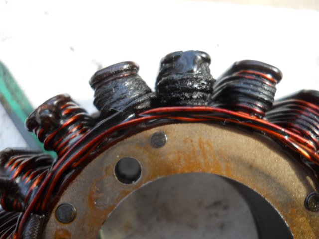

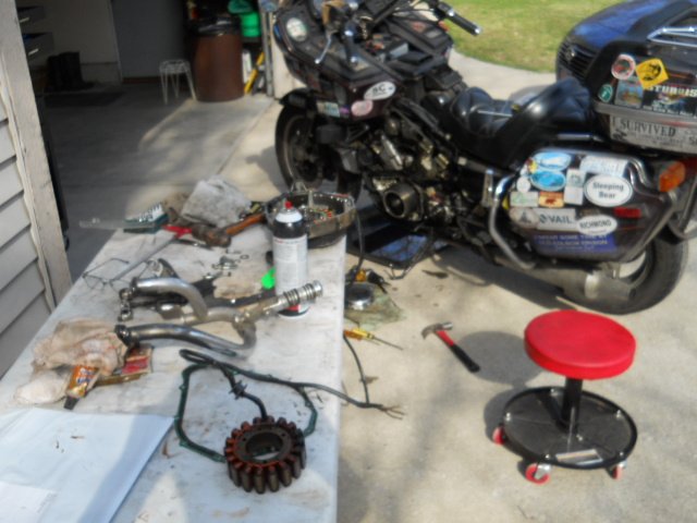

cowpuc Posted April 20, 2021 Author Posted April 20, 2021 (edited) 1 hour ago, Squidley said: Was that the Texas stator Puc? I just stepped out into the garage and snapped these just for you Squid!!! ONLY THE DOCTOR WHO DID THE JOB AND SIGNED HIS WORK KNOWS!!!! That burned out stator that I replaced with the new one is, indeed, the stator that you lovingly provided/installed for us down in Texas my precious Texas Hero @Squidley!! Sure hope this aftermarket stator serves as well as that Texas Stator did my brother, my money is on it wont happen,,, LOVE always wins!! Edited April 20, 2021 by cowpuc 1
cowpuc Posted April 20, 2021 Author Posted April 20, 2021 5 hours ago, Pasta Burner said: It’s upside down and there appears to be a zip tie in there. 42 minutes ago, Flyinfool said: Aren't the wires supposed be UNDER the protection plate instead of next to it? What is the purpose of that white tie wrap holding just one turn of the winding away from the rest of the coil. That sure looks like a wire that will want to overheat by no being in contact with any sort of heat sink or epoxied into the rest of the windings. If ya spent more time in chat we could have schooled ya properly. Hey you lop eared varmints,,, its a $50 Ebay special,,, you didnt really expect the kid putting them together in his garage to triple dip in the laminate coating to insulate the coils when he could skip to steps by holding them apart with zip ties did you!! LOL 1
