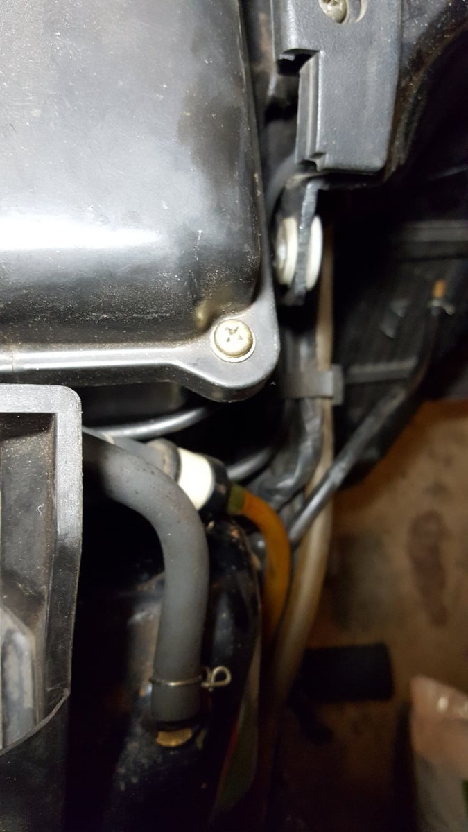

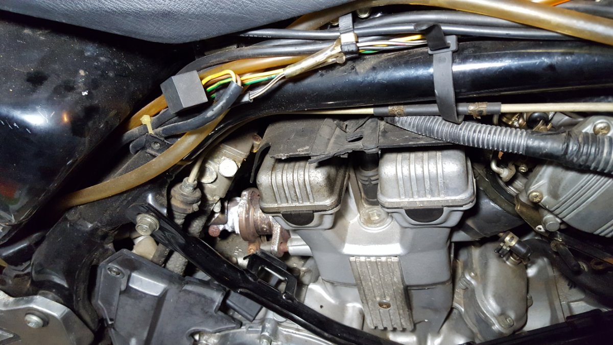

vulcanb822 Posted April 5, 2021 Posted April 5, 2021 After changing the oil, and getting ready to put side panel back on, I noticed a dangling rubber hose. Any ideas on what it is and more importantly, where is it supposed to be connected?
cimmer Posted April 5, 2021 Posted April 5, 2021 Can you tell where the other end is attached to as that would be a big help. With the bike running, do you have vacuum on the line or pressure? It is possible it goes to #2 carb vacuum port and then up to the pressure sensor for the ignition system. There might be another hose hanging down that this one connects to which would explain the tube it is connected to presently. If you dont have a service manual for the VR MK2, here is a link to it and that be of some help to you. https://www.venturerider.org/manuals/1986-1993 Yamaha Venture Service Manual.pdf Let us know if you have more question or what you find out please. Rick F.
saddlebum Posted April 5, 2021 Posted April 5, 2021 I agree it looks like the vacuum hose which goes to the vacuum port on cylinder #1. which is the second cylinder back on the left side of the bike. There should be a second short hose going from the fitting in the hose in the picture to the tube on the carb. If you look at carbs 2,3 & 4 you will find the same tubes on those carbs have a black rubber cap on them which is not used on cylinder #1 because the hose goes there instead. Often times you will see this hose connected to cyl #2 which is the forward cylinder on the left side because some mistakenly think the front cyl is #1 . But to be honest I can,t say that whether it is attached to #1 or #2 that it made any real difference in the running of the bike.

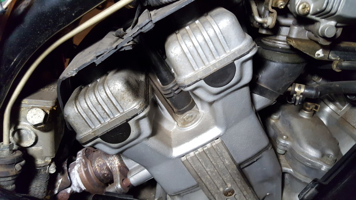

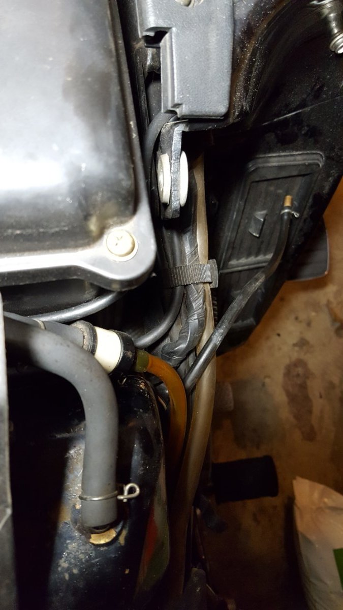

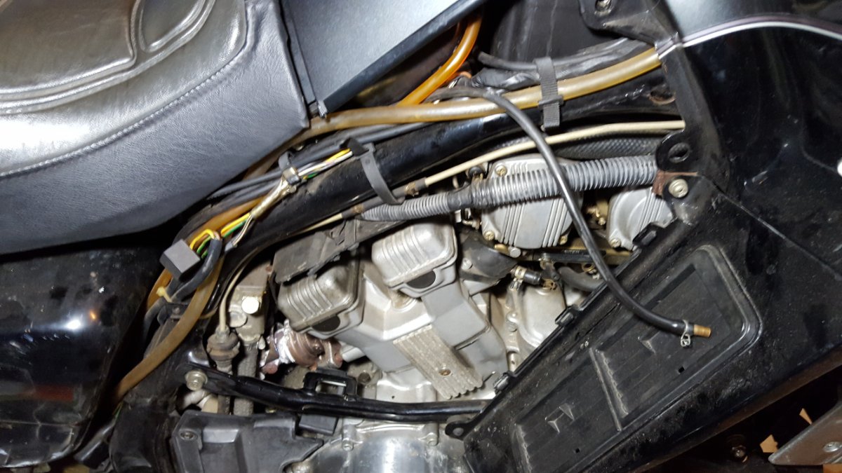

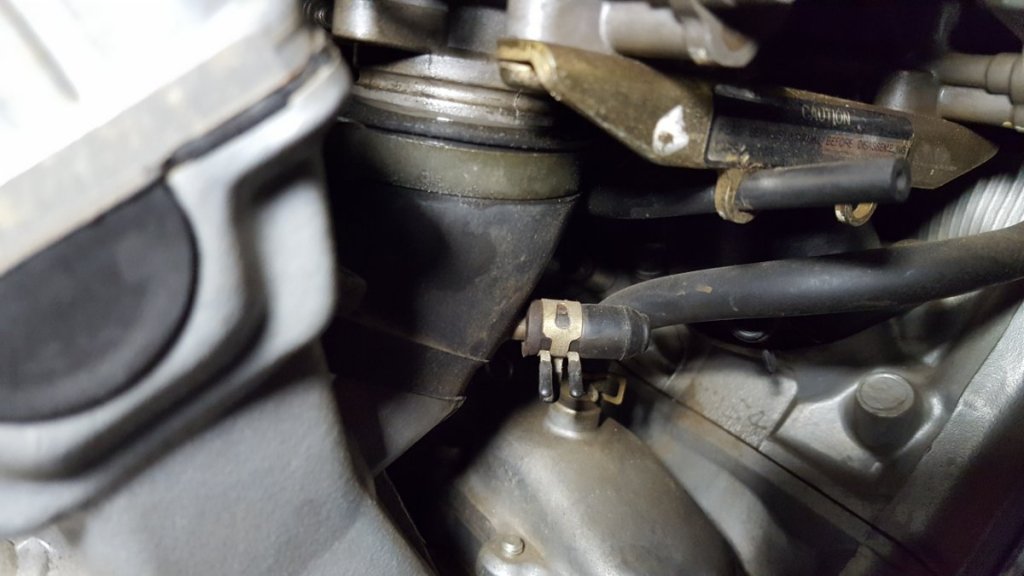

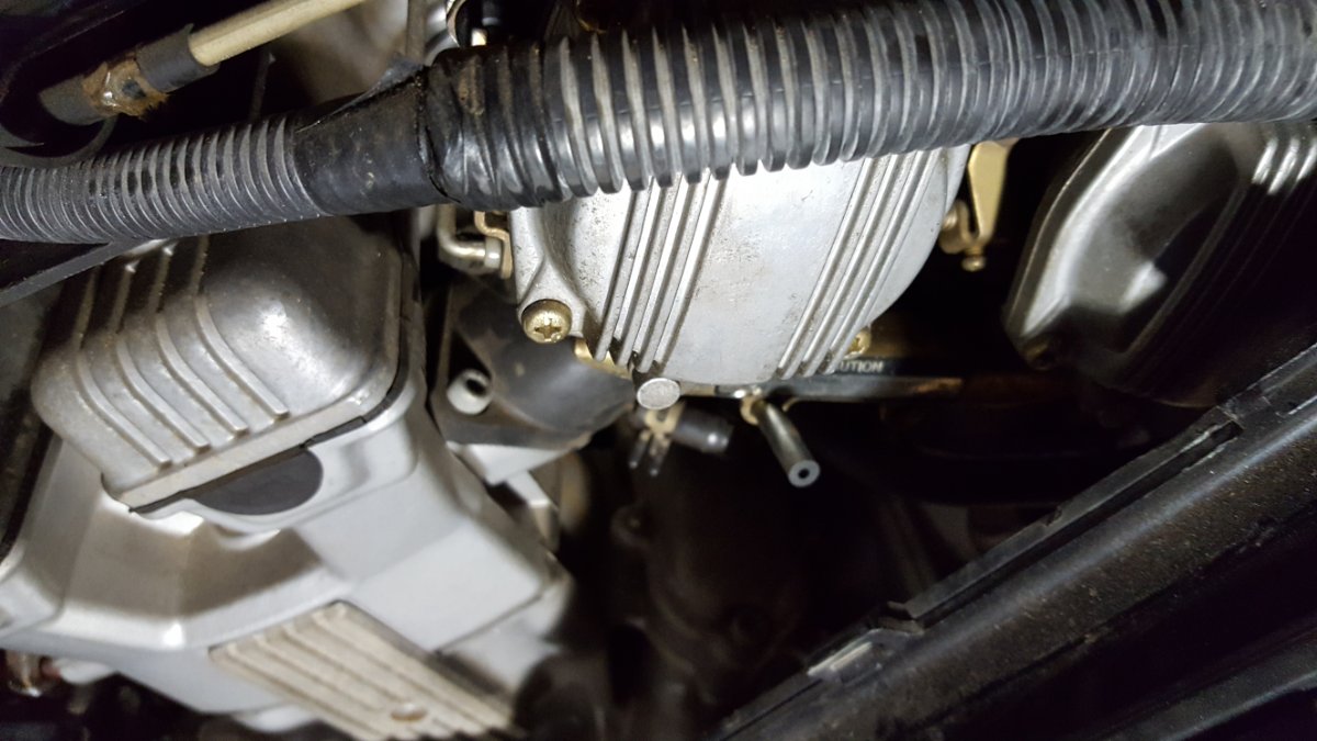

vulcanb822 Posted April 8, 2021 Author Posted April 8, 2021 I got a chance to look this evening and I couldn't see any obvious hose or missing connection. I can't really see all the carbs. Do I need to take off some more parts to get a good look? I have attached some more pictures. The hose is running from the back of the bike.
luvmy40 Posted April 8, 2021 Posted April 8, 2021 I assume we are talking about the black hose with the wire clamp and nipple on the end. That is, more than likely the coolant bottle overflow drain line.

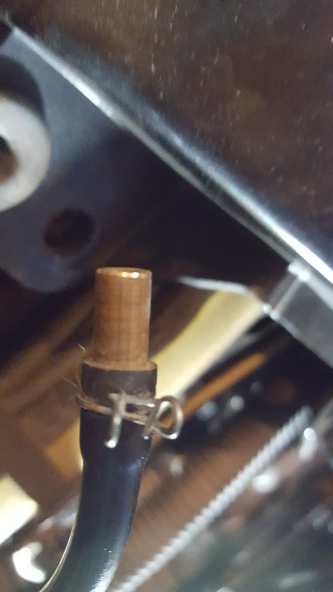

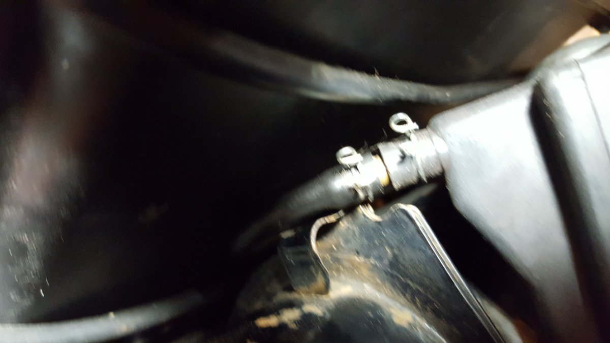

vulcanb822 Posted April 8, 2021 Author Posted April 8, 2021 This picture is the errant hose. Also, not sure related to hose but after running engine for a few minutes, when I cut it off bike backfires.
saddlebum Posted April 8, 2021 Posted April 8, 2021 (edited) @vulcanb822Now that I can see it is on the right side of the bike running along the frame you can disregard my previous post since I assumed the initial picture was of the left side. It is not the coolant overflow drain line as that is the clear tube in the picture. That black hose most likely connects to the bottom of the rubber boot around your fuel tank filler neck. Its a drain tube in case you overflow the neck while refueling. You will find the nipple for it at the bottom left front corner of that boot. Edited April 8, 2021 by saddlebum 1
vulcanb822 Posted April 9, 2021 Author Posted April 9, 2021 Thanks to everyone for your help and patience. It was in fact the hose that connects to the rubber boot around the fuel tank filler neck. Here's the reconnected hose. Thanks again. 1
