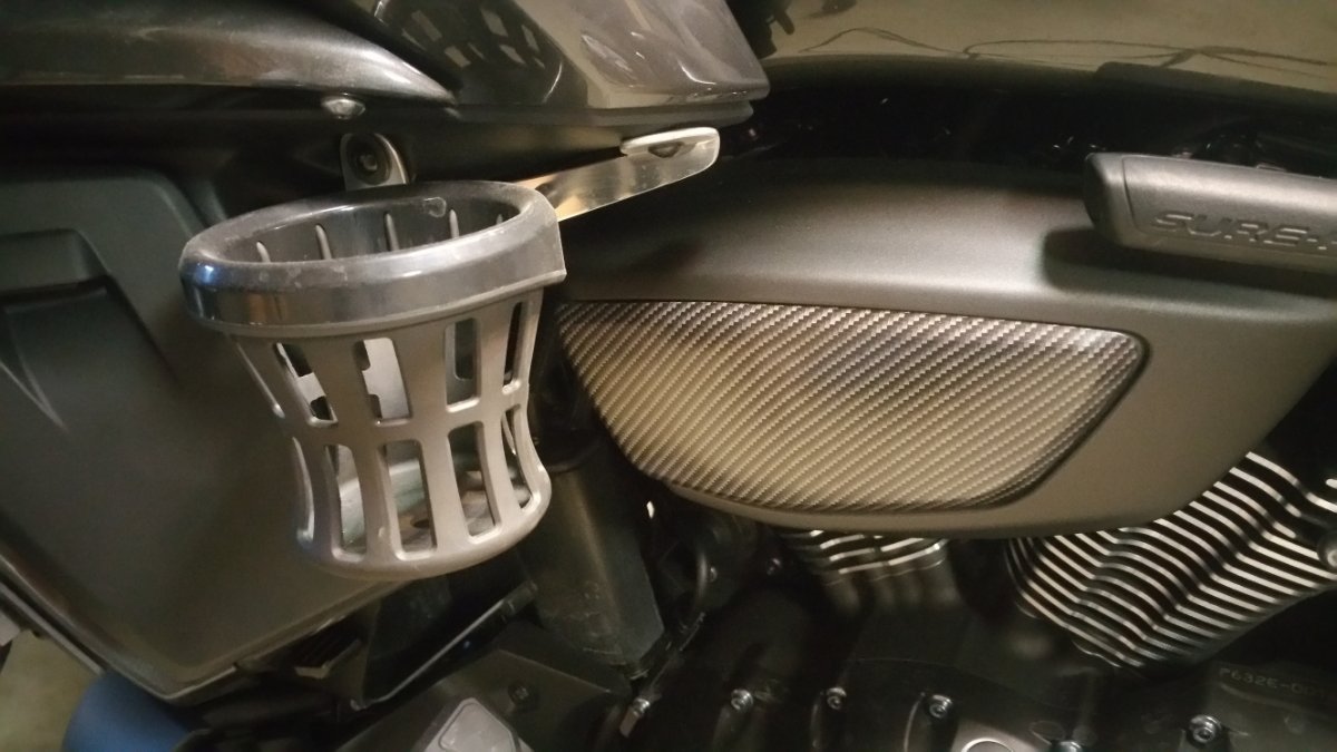

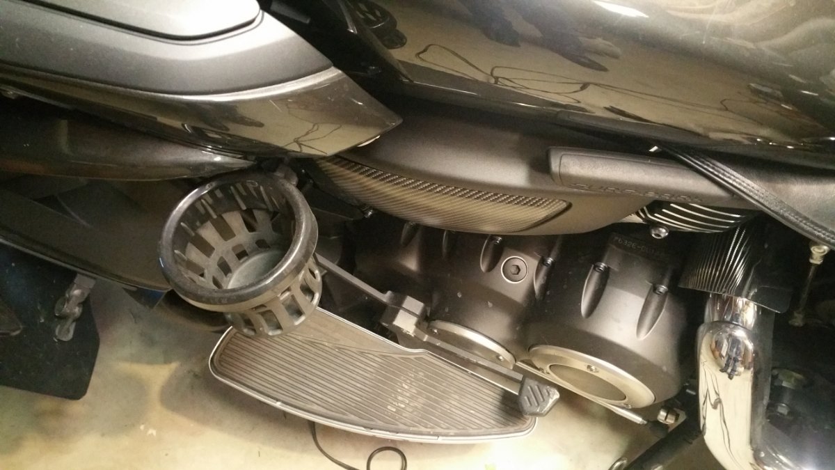

darylbandy Posted February 21, 2021 #1 Posted February 21, 2021 I decided to put a drink holder on the Venture and did not want it attached to the handlebar, so I made an aluminum bracket that uses the factory screws and mounting holes for the side fairing cover. Using a piece of 5052 aluminum sheet .092 thick. 5052 aluminum will bend and not crack like 6061 will. I polished the sheet metal but will probably hydro dip it carbon fiber now that I feel comfortable with the dipping process. Purchased a CIRO DRINK HOLDER WITHOUT MOUNT part #50003 and a CIRO ECONOMY PERCH / UNIVERSAL MOUNT part #50132. I really like this cup holder and it will hold a one quart water bottle with no problem. I am thinking about producing a few of these if there is any interest. 2
bpate4home Posted February 22, 2021 #2 Posted February 22, 2021 Interesting. Does the storage door still open without interference from the holder? It also looks from the Pics that a cup may rub the side of the bike?
