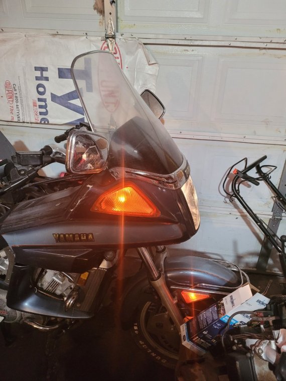

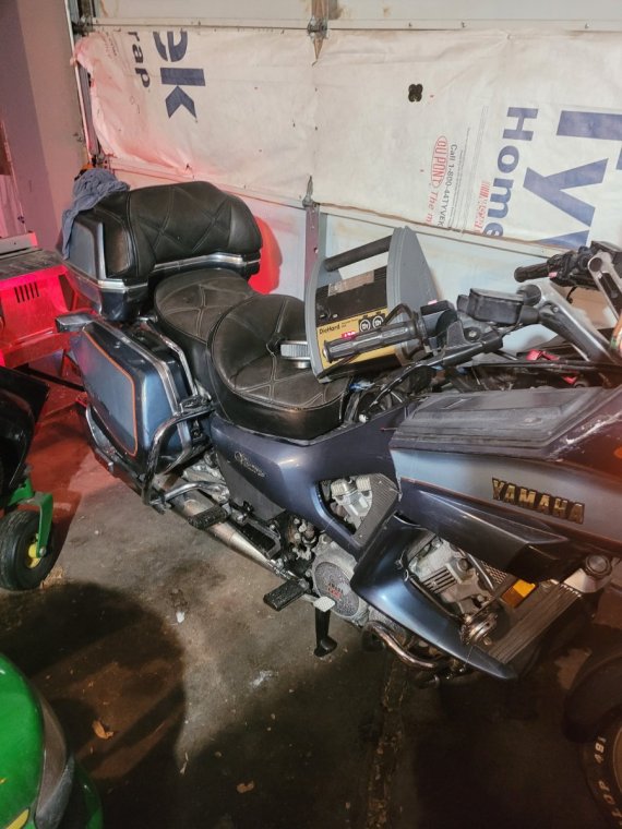

David Cruz Posted February 9, 2021 Author Posted February 9, 2021 Saddlebum, Grateful for your reply need to find some replacement tube there's a couple missing. so should I cap off the three port for sync on carburetor itself like three on joints just using #1 cylinder connected? Do have a used service manual coming kind of hard fixing or putting back to factory what someone else has done have no guide on repairs like the missing hardware on side cover and fairing look like factory screw was used with gourmet from pictures I've seen. Bike has good bones she needs a lot of TLC . where's a good place for rebuilt kit for carburetor? besides ebay ? I'm going to post picture of my bike I'm a newbie with all of this doing little at a time right now 6 below here in Fargo for weather so have time . Thanks for having me
Marcarl Posted February 9, 2021 Posted February 9, 2021 Nice lookin scooter hope you can make it work and have lots of good rides on it as far as the carbs are concerned work away at them and if you have problems then ask away you will probably need more info so don't be afraid to ask we will try to give you answers that work.
