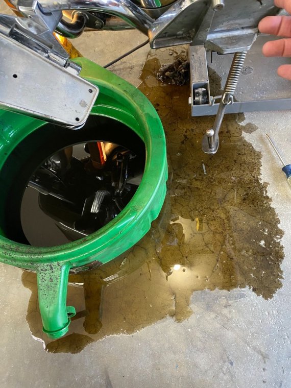

So here's my question.
I have had my bike serviced at a bike shop. Oil change only and when I pick it up after service the oil is perfectly clear. How do they do that? Now that I change my own oil, I can never get it that clear. What is the secret?

Are you draining it when warm/hot?  You’ll typically get more out if the engine isn’t cold.  I did this change cold but the sight glass is fairly clean looking after warming it up a bit.
I do not generally worry much about it as you will never get all the dirty oil out of the engine since there are areas where oil collects and mixes with the new oil once you start the the bike.
However  if you drain the oil and remove the filter while it is hot and then leave it sit with the plug out and filter off until it stops dripping you tend to drain more of the old oil out plus  sediment which would still be  suspended in the oil. If the the bike is cold or has sat for a bit a certain amount of the suspended sediment in the oil will settle to the bottom and not drain out with the oil. Also make sure the bike is upright and sitting so there is good flow in the direction of the oil plug. If you you really want to give it a good clean add a bottle of seafoam to a full crankcase of oil and let it idle for 10 to 20 min (DO NOT RUN HIGHER THAN IDLE) then immediately drain oil and remove filter while hot and wait until it stops dripping before replacing oil and filter. I

I always have engine hot before changing the oil. I think I will try letting it sit for some time before I add the new oil.

I always have the bike on centre stand and engine hot when starting an oil change.

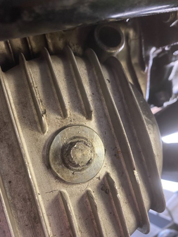

Something I forgot about until tonight while working on the bike. The transmission shaft cover on the left side is held on with a bunch of Allen head bolts. The bottom one has a copper washer and when you remove that bolt an extra 1/2 cup of oil drains out. If I being fussy with my oil change I will remove this bolt to drain the extra oil but most times I don't bother and that is why I probably didn't think to mention it earlier.
That’s actually great to know!  That area is one I was focused in on looking for my phantom leak.

Check your clutch slave mounting as well you may have to remove that cover pictured in my previous post to get a better look at it but make sure you have a gasket on hand for both first to avoid downing your because you have to wait for a gasket.
