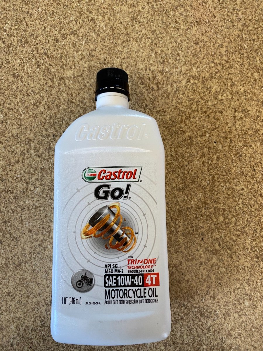

Pasta Burner Posted April 10, 2021 #11 Posted April 10, 2021 Ended up with this cause well it was cheap and looks like it’ll do the job. I think anything is better than the sludge currently in there. 1
saddlebum Posted April 10, 2021 #12 Posted April 10, 2021 Castrol is a top quality oil I have used it for years on most all my engines from trucks to bikes. It is actually one of my preferred oils. 2 1
