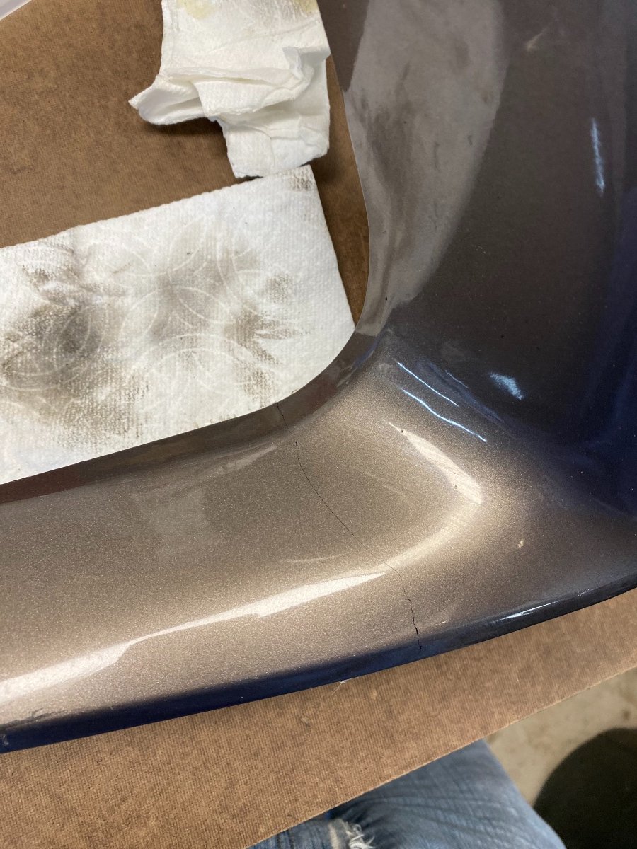

Pasta Burner Posted January 27, 2021 #1 Posted January 27, 2021 Hey Strangers! Been a while since I checked in, fall came and I checked out. Hope you all had a great holiday season and are keeping busy in the off season, which brings me to my topic. I have no idea when why or how but as I was working on cleaning the garage this past weekend I noticed the horizontal part of my fairing has a complete clean break in two. The horizontal location of the piece that goes from the lower behind the radiator and up where the vents are. My first instinct is to fiberglass it back together. But any suggestions are encouraged. I’m still dumbfounded on what caused it and when. Rock maybe?
RDawson Posted January 27, 2021 #2 Posted January 27, 2021 Several posts regarding this. Search in the library. It’s ABS plastic, you can make a putty with ABS and MEK for patching, I used ABS sheet and ABS plumbing glue to fix a broken saddlebag. There are commercial products available Plastex being one. Fiberglass really isn’t the answer. 2

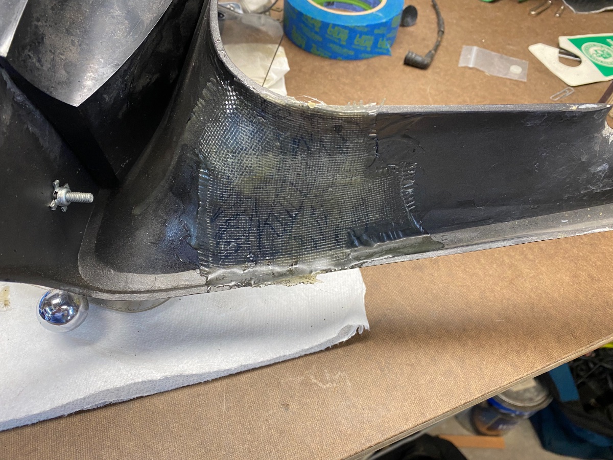

Pasta Burner Posted April 18, 2021 Author #12 Posted April 18, 2021 In the interest of time and not committing to a paint job I decided to fiberglass the backside for now. I will be investing some time into plastifix though because there are a lot of tabs broken off on this thing.
saddlebum Posted April 19, 2021 #13 Posted April 19, 2021 (edited) 6 hours ago, Pasta Burner said: In the interest of time and not committing to a paint job I decided to fiberglass the backside for now. I will be investing some time into plastifix though because there are a lot of tabs broken off on this thing. You can also use the plastifix with the fiberglass cloth. when replacing missing tabs I use multiple layers of fiberglass drywall tape and plastifix. Edited April 19, 2021 by saddlebum 1
Marcarl Posted April 19, 2021 #14 Posted April 19, 2021 I can't really tell if you did, but, when using anything, plastifix, fiberglass, abs powder, what ever,,,, it is super important to remove the 'glaze' on the surface of the original piece. If you don't, things won't stick for long.
Pasta Burner Posted April 24, 2021 Author #15 Posted April 24, 2021 (edited) On 4/19/2021 at 6:37 AM, Marcarl said: I can't really tell if you did, but, when using anything, plastifix, fiberglass, abs powder, what ever,,,, it is super important to remove the 'glaze' on the surface of the original piece. If you don't, things won't stick for long. I didn’t remove all of the glaze, if you look close you’ll see a bunch of black squiggle tar snake looking marks under the patched area. I did that intentionally to make this only a temporary but hopefully make it through the season patch. It’s not a structural piece so it shouldn’t have much other than wind stress. I spent a handful of summers fiberglassing boat repairs in my teens so it’s often a go to product for me. Wish I had done a little more looking around on ABS repair last year before I decided to fiberglass my trunk cracks when I first got the bike 🥴. Edited April 24, 2021 by Pasta Burner
