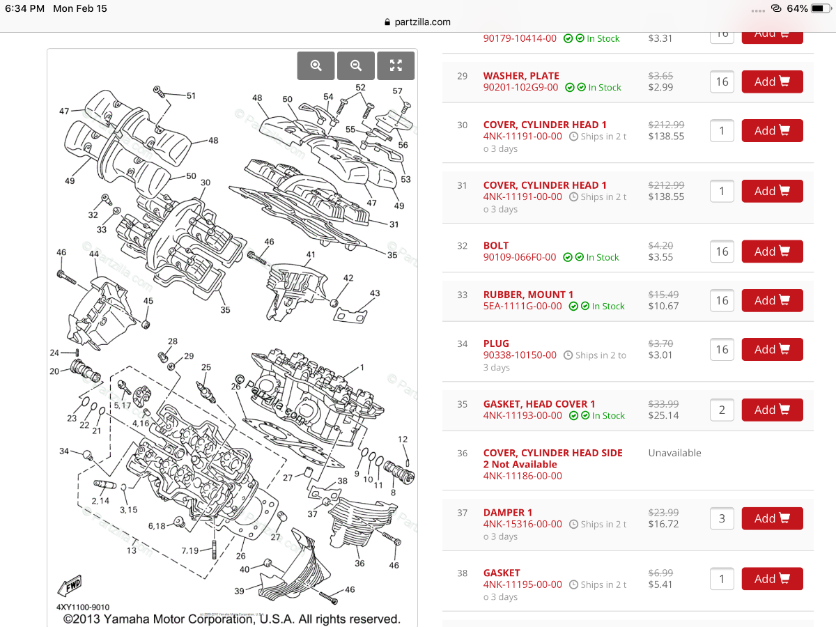

RoTorKev Posted February 12, 2021 #59 Posted February 12, 2021 Alright dumb question time. Are these the bolts with the rubber seals that have been mentioned? bottom picture with the arrows?
sleepy2 Posted February 12, 2021 #60 Posted February 12, 2021 Yes those are the 16 bolts with rubber seals! On my 2012 they are mounted on the bolt itself but on XV1100SE's 2009 they are separate. Also Don parts are paid and he going to try and ship today!(gaskets and bolts)
RoTorKev Posted February 16, 2021 #62 Posted February 16, 2021 Follow up dumb question, does anyone have the part number for the valve cove bolt seals for the 1999 RSV. I’ve been searching the net and still unclear. thanks
RoTorKev Posted February 16, 2021 #63 Posted February 16, 2021 (edited) Ok just found this on partzilla, looks like 1999 is a separate bolt and seal. Bolt: 90109-066F0-00 Seal: 5EA-1111G-00-00 Also, partzilla appears to have the best price at $10.61 ea for the seals. Edited February 16, 2021 by RoTorKev
sleepy2 Posted February 16, 2021 #64 Posted February 16, 2021 @XV1100SE has same bike. He could tell you. Found this in previous post of his. I'm impressed with Performance Cycle! I didn't realize that there was a difference in parts for the 2012/2013 RSV but apparently there are differences. For "up to 2011"... there is sealing rubbers 5EA-1111G-00-00 @ $16.31 that goes over bolt 90109-066F0-00 (didn't ask for price). Cost of the rubber is $16. For 2012/13 there is 5SL-1119E-00-00 (which are bolts with rubbers). The 2012/2013 bolt/rubber is $5.95 but back ordered. I don't know if these parts are interchangeable as no part numbers are listed as replaced by another. Thru Performance Cycle I have ordered : - sealing rubbers # 5EA-1111G-00-00 up to 2011 $16.31 quantity 16 - valve cover gasket # 4NK-11193-00-00 @ $44.71 quantity 2 1
RoTorKev Posted February 16, 2021 #65 Posted February 16, 2021 Thanks sleepy, I actually saw that post and for whatever reason it didn’t click that it said up to 2011.
sleepy2 Posted February 16, 2021 #66 Posted February 16, 2021 I got my parts from Pioneer Motor Sports Chaffee NY (check website) with a Venturerider discount (I think it is 10%) I talked to Chad Armstrong.(owners son)
WIZ Posted February 16, 2021 #67 Posted February 16, 2021 I just googled part number 5EA-1111G-00-00 and found them on e-bay for $47.00 for all 16 seals. Only took about 2 weeks to get them. Wasn't in a huge rush so saved about $150 by waiting. Ron
