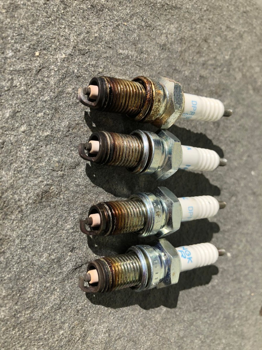

circa1968 Posted November 16, 2020 Author Posted November 16, 2020 Thank you Patch. I understood your procedure perfectly and will follow it. Unfortunately, I did not track the plugs when I removed them, but have a few miles on the new plugs, so will pull them & get pics to see if that is of any use. I will also take pics of the old plugs, for what that's worth. I'm pretty mechanically inclined and have an engineering degree and a quick study of most things that come along. I like challenges, just have zero experience working on engines or carbs and don't want to screw anything up. But that said, I've learned a lot already and each new step leaves me wanting to learn/do more. Fascinating stuff. I did get out for a ride yesterday. the cooling issue seems to be much better. I noticed it getting warm a couple times when in traffic, but out on the twisty road had no issues. Of course it was also in the 60's vs. 90's when I first got the bike and noticed the heat. At the end of my ride, the radiator was reading ~200F, a little warm, but seems mostly normal. #1 & #3 (two back) were reading 400+ on the exhaust pipe (#3 was not this high previously). #2 & 4 were reading ~200ish but I can only check those on the mounting flange, not the pipe itself. For what its worth, when I check the mounting flange on #1 & #3, instead of the exhaust pipe, they are also 200ish. Again, I sincerely appreciate the help and information! 1
Patch Posted November 16, 2020 Posted November 16, 2020 36 minutes ago, circa1968 said: Thank you Patch. I understood your procedure perfectly and will follow it. Unfortunately, I did not track the plugs when I removed them, but have a few miles on the new plugs, so will pull them & get pics to see if that is of any use. I will also take pics of the old plugs, for what that's worth. That would be very be very helpful to the boys: I'm pretty mechanically inclined and have an engineering degree and a quick study of most things that come along. I like challenges, just have zero experience working on engines or carbs and don't want to screw anything up. But that said, I've learned a lot already and each new step leaves me wanting to learn/do more. Fascinating stuff. This is good to know, so expect that the boys here have made enough mistakes to walk blindfolded thru traffic on the 401, just ask Carl I did get out for a ride yesterday. the cooling issue seems to be much better. I noticed it getting warm a couple times when in traffic, but out on the twisty road had no issues. Of course it was also in the 60's vs. 90's when I first got the bike and noticed the heat. The rad temps work on a different scale it will at first spike as a result of the Tsat opening then down from there. Later on as you live in a warm climate consider adding some bite to the rad flush. I would be more inclined to add a 1/2 can of seafoam to the crankcase the the fuel tank as well. At the end of my ride, the radiator was reading ~200F, a little warm, but seems mostly normal. #1 & #3 (two back) were reading 400+ on the exhaust pipe (#3 was not this high previously). #2 & 4 were reading ~200ish but I can only check those on the mounting flange, not the pipe itself. RIGHT RIGHT ON, as I was expecting, very good feed back! So answer yourself this question, what changed that could make that difference? For what its worth, when I check the mounting flange on #1 & #3, instead of the exhaust pipe, they are also 200ish. Again, I sincerely appreciate the help and information! As do we for bringing the challenge forward! Take a look at the quoted area its how I work best over the net:

circa1968 Posted November 16, 2020 Author Posted November 16, 2020 16 hours ago, cowpuc said: Seeing I got summons here (thanks @Patch) I thought I better join in on the fun and share some more, maybe it will help - maybe it won't back yard wrench spinning free advice.. Noting now @circa1968 that you have been taking your temp reading off different spots on both the front and rear jugs changes the dynamics a lot IMHO. Taking the reading right off the header itself on the rears and off the clamps on the front should actually read about what you are describing.. The headers are way thinner than the clamps and are also in direct line of fire for exhaust flames,, to me what you are saying makes sense. Also, those front jugs are directly exposed to air flow with the rear jugs getting no where near the exposure. I ran/rebuilt/tuned/modded numerous HD air cooled over the years and being air cooled - one of the things I did was ran dual carbs (or later injected with a race tuner was even easier to do this) and then run fatter on the rear jug to keep it cooler.. Lean = hot IMHO. I always found the following advice a little easier to do on a single, or even a twin cylinder scoot but with a little focus on my part I can usually adjust by ear a multi jug, multi carb in the following way too. Another way besides the following is with either a sniffer or a Color Tune (so you can actually look into the combustion chamber and adjust for the blue flame) but again, I have found following to work well. If lean does equal heat than it may be possible that you are seeing a lean condition.. That would not surprise me because it seems like for many years bike manufacturers have been actually outputting scoots that run extremely lean since new, maybe due to EPA regs,, maybe not.. Maybe I am even wayyyy off base with that comment but it seems that way to me.. I have noticed lean idle circuits also causing erratic idle and also stumble right off the bottom when you crack the throttle,, a bog so to speak.. The way an idle circuit works, at least in my pea brain, is that with the throttle plates closed meaning your throttle is twisted at all and your throttle cable has slack in it, vacuum forms behind the throttle plate and fuel/air mix is drawn into the throat of the carb thru that set of little holes you will see back there. One of the ways I always used, right or wrong it worked for me, to know that my low speed jets were correct size and that I used for setting my air screws with NO sniffer or carb tune was by ear tuning. Simply run your air screws down to bottom lightly and back them out a turn, start your bike and let it warm up so it is no longer needing choke, set your idle at 1000 rpm, now adjust the air screw and adjust it out till it reaches top r's - there should be a point where it reaches top rpms and if you keep unscrewing it will falls off again, then screw it back in till it reaches top r's again, now screw it in farther and it will fall off again. The "sweet spot" of top R's on the air screw is where I always found the perfect idle circuitry tune. Now if you run the screw back to bottom and note the turns it takes to get to a soft bottom - if the turns equal between 1 and 3 turns out you have the correct idle/low speed jet in that carb. If the top r's are below 1 turn your low speed jet is to small, higher than 3 turns out and your low speed jet is to high. Make since? If so, and I have used this method for years in tuning, than you can now see where you could use that logic in diagnosing whether you are dealing with a lean low speed circuitry caused by crud buildup in one of your carbs or not simply by tuning them. Right off idle and up to WOT (wide open throttle) and the tapered metering rod hanging off the slide into the emulsion tube and the main jet at the bottom of the tube take over. I spent a couple years doing final tune on small 1 pot Hondas at a Honda dealership and 90% of the final tune work on those brand new bikes right out of the crate was moving the E clip on that jet needle hanging from the slide to get em to run right.. Most of the time this meant fattening em up so they didnt bog when I wacked the throttle. Because our V-4's carbs do not have E-clips I am running shimmed metering rods in mine right now. Shimming them out gives you a fatter off idle/mid range/WOT,, lowering them will lean er down.. Why do I mention this? Because,, IMHO, you could - for very little money - fatten up a jug or two and see if your temps drop.. If they did, again IMHO, this could indicate a partially blocked main.. Make since? I know,, getting long winded,, dont blame me, blame @Patch lol Thank you Puc! I'm looking forward to digging into the carbs more and learning how they work. I looked on ebay for a used set, just to play around with and explore how they work. Oh my, that's an expensive toy, $300+ for a set of used carbs! 1
Patch Posted November 16, 2020 Posted November 16, 2020 those plugs look too me as low mileage yet the top one way lean, bottom lean ish, the second and third down are better but the third looks spot on. Will be interesting to see the ones in there now. remember after you set the plates, do not reassemble the slides, we'll go a bit further before doing that.
