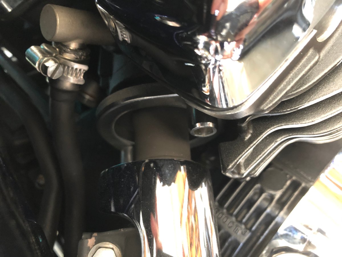

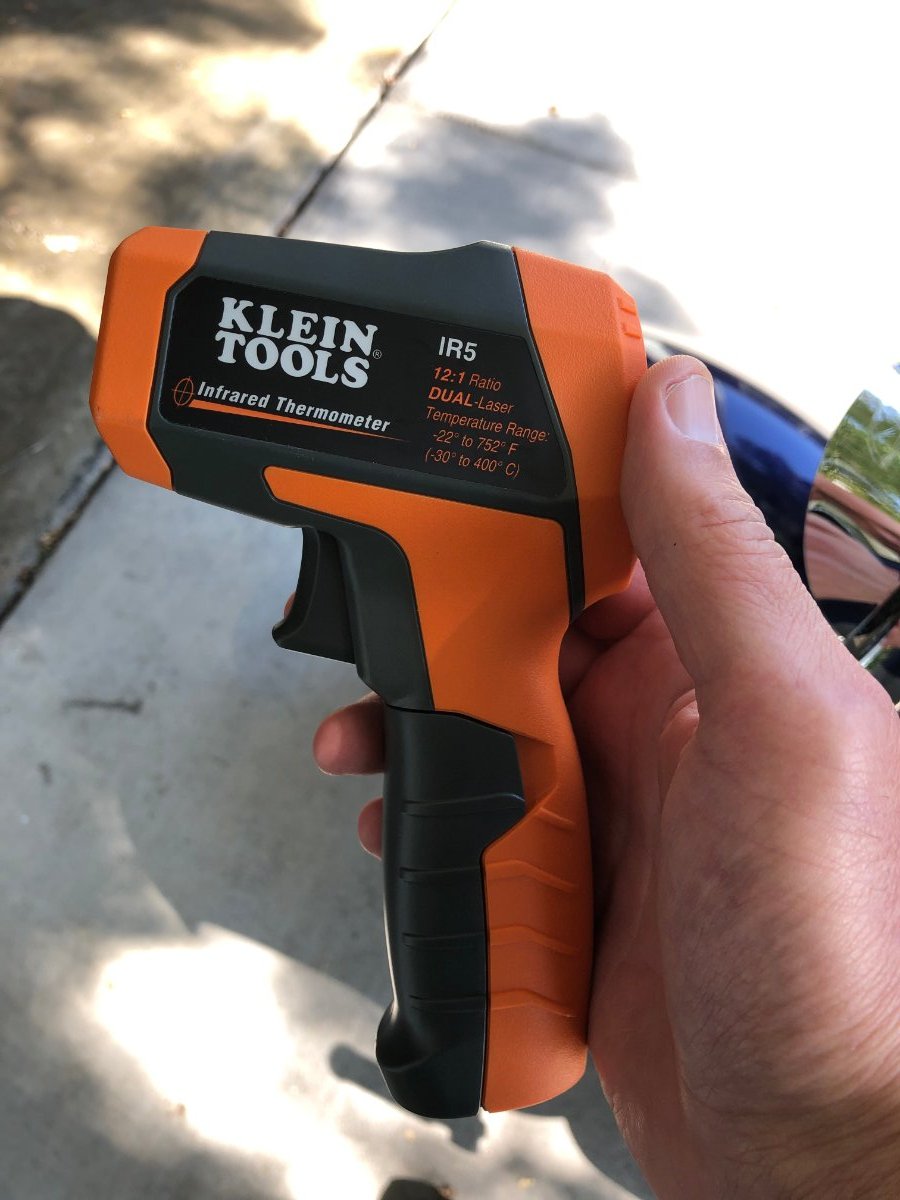

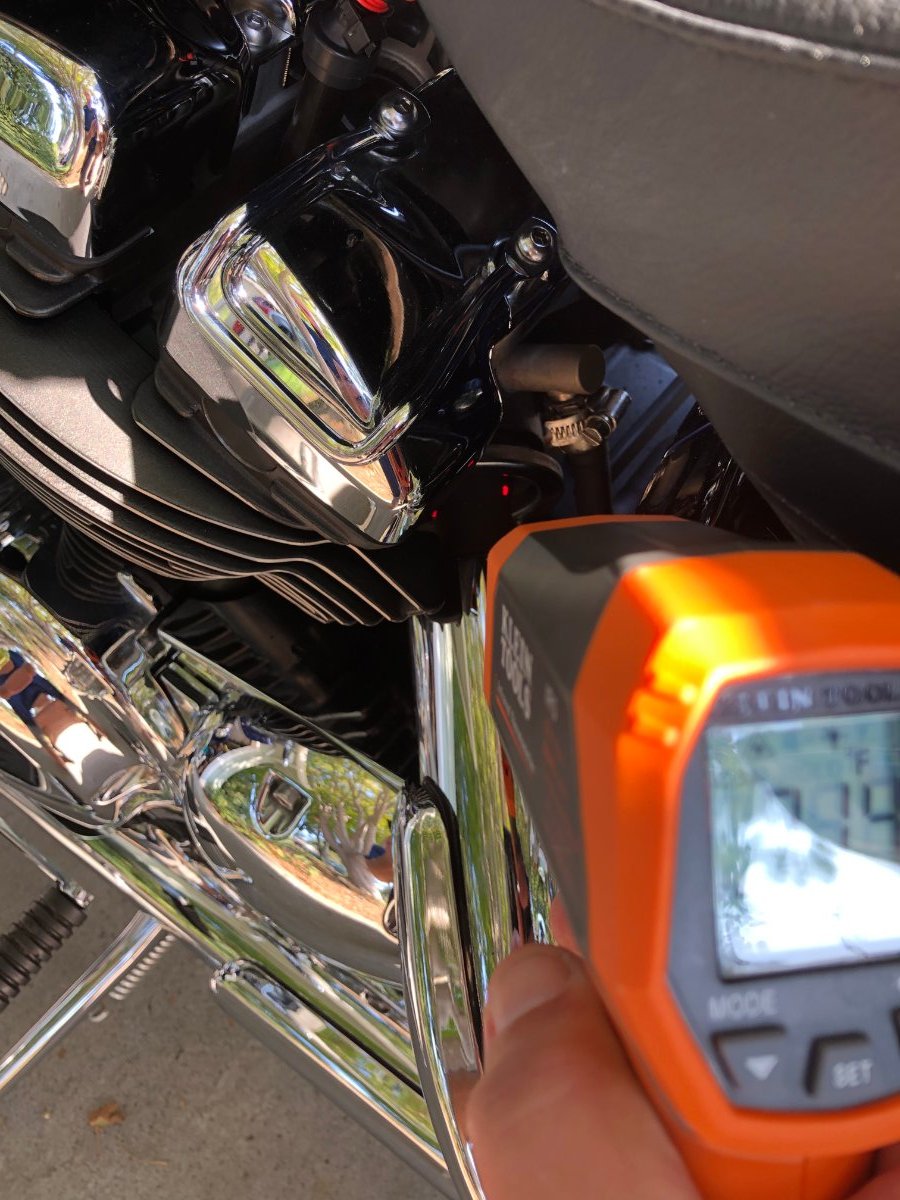

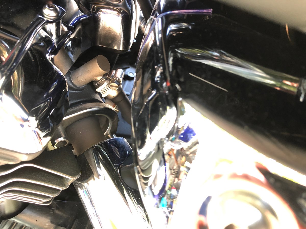

circa1968 Posted November 2, 2020 Author Posted November 2, 2020 Puc, I'm using an IR thermometer to measure the header pipe as it comes out engine. There is a ~1" gap between the heat shroud & the engine. I've attached a few photos showing the two rear exhaust. Is there a better method? I've gotten consistently high readings off the 1 cylinder exhaust, tried different angles, distance, etc and still the same results. I can get to the two front ones as well. Three cylinders are consistent & #1 is always ~200 deg higher.
cowpuc Posted November 2, 2020 Posted November 2, 2020 Geo, are you making the check during riding/stopping to check it or monitoring it during start up/warm up before riding it? NICE lazer temp gun!! Side note, I took my temp gun (similar to yours) with me out to Sturgis back in 2017 when Mom Yam released the new Venture cause I wanted to take some heat tests on the rear pipes/heads while there cause Mom Yam had said she had conquered the heat issues normally associated with Air Cooled bikes (I been into HD's for years and was amazed to hear someone had found a way to mitigate those hot leg issues Big Twin riders had suffered with for years) and I wanted to document what they had come up with.. They absolutely forbid me from "shooting" the new one with my lazer temp gun, they must have heard of the accuracy of those guns cause now I have heard of many new Venture owners are not being happy with what ever method Mom Yam had come up with for heat mitigation. In the old days it was common to "spit check" our headers to accomplish the testing task,, YOU are definitely on the right track IMHO!! GOOD STUFF!!

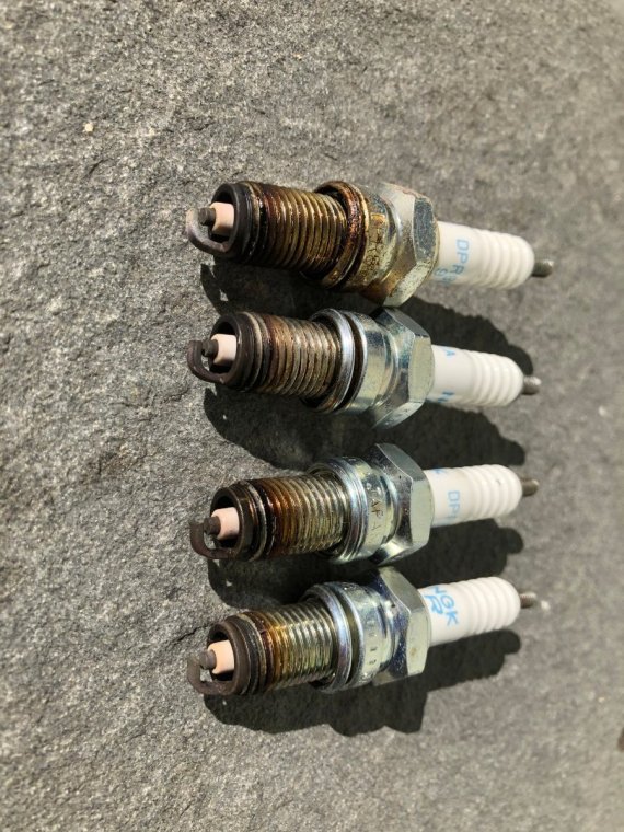

93 venture Posted November 5, 2020 Posted November 5, 2020 what about coolant temp, have you used your temp gun to check it. i wonder if the coolant system could have a air pocket causing a hot spot ? the manual says it hold 3.7 qt. Or possible water pumps isn't moving coolant. even if it had a lean cylinder being a water cooled engine one would think it could take the extra heat away except what comes off of the header pipe. what did your plugs look like did you take any pictures of them?
