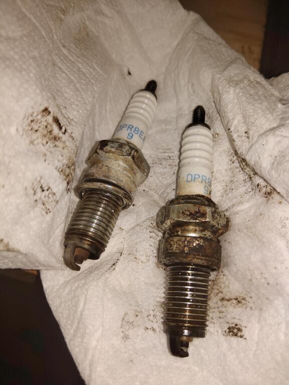

imranh101 Posted September 4, 2020 #1 Posted September 4, 2020 Hey all, been getting really, REALLY bad performance and had to put choke on about halfway to get the bike from my apartment to my new house without it dying in neutral. I figured something was up with the ignition because it felt like I was missing two cylinders. Pulled spark plugs and sure enough it looks like I've got oil on the threads on the two plugs for the cylinders closest to the front tire of the bike - the back two look okay albeit a bit carbon fouled. Can I get a point in the right direction on where to go from here? Where is the oil most likely to be coming from and how would I go about repairing See image - left plug is one of the back two plugs, right is one of the front plugs - you can see how much oil is in the threads on it Thanks as always!
MiCarl Posted September 4, 2020 #2 Posted September 4, 2020 Oil on the threads isn't the running problem. Your valve cover gasket is leaking and oil is pooling around the plugs. Oil gets on the threads as you remove them. Needing choke to run is a symptom of a fuel system issue. Check for vacuum leaks. Put in a good dose of carburetor cleaner (Sea-foam, gumout etc.). Ride it like you stole it, that might clear up the issue.
Patch Posted September 7, 2020 #3 Posted September 7, 2020 Not sure you will see this but I can add a bit... MiCarl is correct the gaskets are leaking. The rear plug show signs of light recent carbon only the redish is fuel type for the most part. The business end of both look fresh enough. The front ones tho show cold so is where I would start! First check voltage at the coils, looking for close to battery volts, 12ish. Then check for spark you - can gap test or, if you have an old timing light use it on the front ones... Note: the spark testing method @Marcarl suggests is part of his therapy and NOT supported my the membership! If the spark test taste good then check carbs
Marcarl Posted September 8, 2020 #4 Posted September 8, 2020 So Marcarl now suggests to warm the engine, remove air cleaner and inner tower, and then spray a bit of cleaner into each intake. If the front 2 respond with better running, then I would look for a fuel issue. Just for kicks, squirt a bit into each of the rears and see what response you get from that exercise.
Patch Posted September 8, 2020 #5 Posted September 8, 2020 So Marcarl now suggests to warm the engine, remove air cleaner and inner tower, and then spray a bit of cleaner into each intake. If the front 2 respond with better running, then I would look for a fuel issue. Just for kicks, squirt a bit into each of the rears and see what response you get from that exercise. Eh WOW Carl, Marca is really getting good at troubleshooting!
