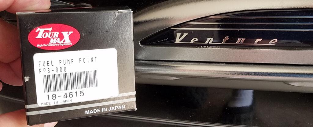

mike042 Posted August 24, 2020 Author Posted August 24, 2020 You know about just replacing the points on the factory fuel pump ...right? https://www.venturerider.org/forum/attachment.php?attachmentid=119513 Ya i do but i prefer to just replace with oem and not worry about it again

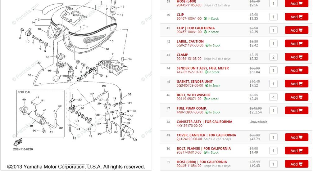

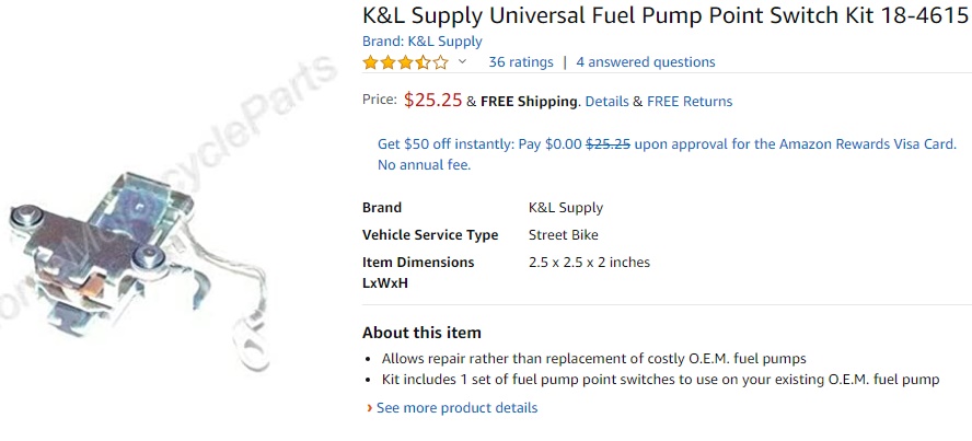

Du-Rron Posted August 24, 2020 Posted August 24, 2020 Ya i do but i prefer to just replace with oem and not worry about it again Points are about $25.00 From Partzilla a Yamaha Fuel Pump is about $250.00

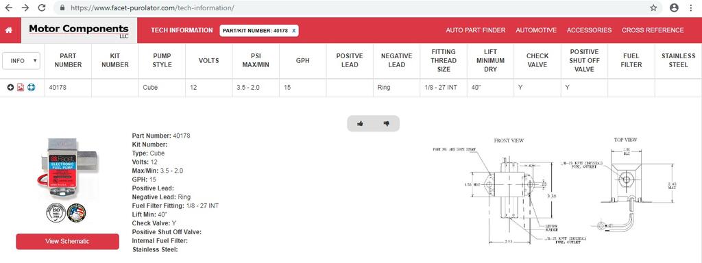

Du-Rron Posted August 25, 2020 Posted August 25, 2020 ET Rider has a new 40171 Facet for sale it is a buy Well...if you dont want to replace the points, and OEM is not a requirement like he wanted above, I prefer the Facet 40178

RedRider Posted October 19, 2020 Posted October 19, 2020 Get the points as shown above. Easy to replace. 99% chance that's your issue. Take the black rubber end cover off your current pump and you will see the points. Look at the contacts. They should be clean and cross-hatched. If yours has burns on it, replace it with new points. RR

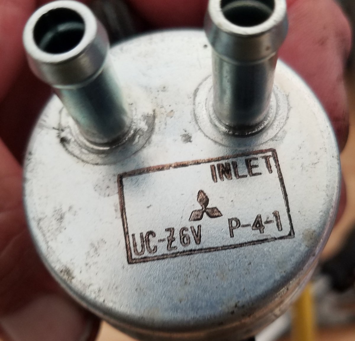

Barnacle442 Posted November 13, 2020 Posted November 13, 2020 (edited) Hold my beer,... Just a word of warning here regarding fuel pumps and fuel pump points. If you decide to go the $17.00 Fuel Pump points route: The package does not include instructions. There is a black wire that requires both unsoldering and re-soldering. Make sure that the points assembly is all together in one piece because there are no instructions. Do not remove the old points before you have the new points because there are no instructions. Take many photos because there are no instructions. If, after you learn all these lessons, you decide to give up and go with the $215.00 Fuel Pump Replacement: The package does not come with instructions. The OEM pump is neither marked "Inlet" nor "Outlet." The OEM fuel pump replacement, when installed upside down, looks almost identical to the OEM fuel pump when installed right side up. The OEM pump is neither marked "Inlet" nor "Outlet." (This is important.) With the OEM fuel pump installed upside down the bike will run only until the float bowls are empty after which it will not run at all. The only way for the OEM fuel pump replacement to be upside down is if the points are installed upside down. Reversing the inlet and outlet fuel hoses is much easier than rotating the points. I took neither photographs nor video. Had I done, it could not have passed the censors. My baby now runs like a champion. I hope this helps. Edited November 13, 2020 by Barnacle442 2
Du-Rron Posted November 14, 2020 Posted November 14, 2020 21 hours ago, Barnacle442 said: The OEM pump is neither marked "Inlet" nor "Outlet." The OEM Fuel pump is marked. If yours is not, with the pump held facing you with the tubes in the top quadrant position, the INLET will be on the right.
