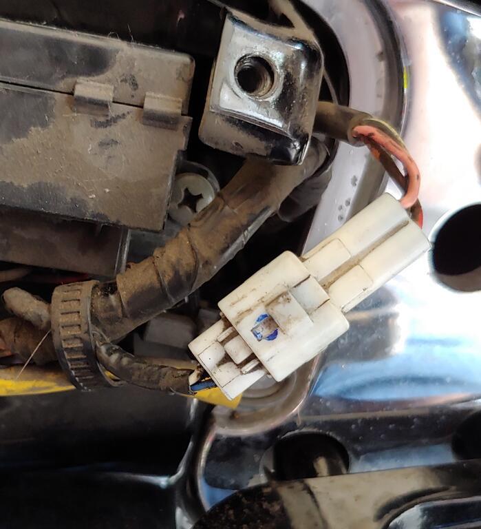

John P Posted August 22, 2020 Author Posted August 22, 2020 Thanks for all the advise! I took the battery over to an auto store and they did a load test and verified it's a ok. So I thought I would do the ohm test on the stator. I took off the left side panel and think I'm staring at the stator wire connection.. three wires in and out right by the fuse box. Can't for the life of me get the male to unmount the female so to speak. Pushing on the little tab. Etc. Does this look like the right connection? Any advise for this novice?

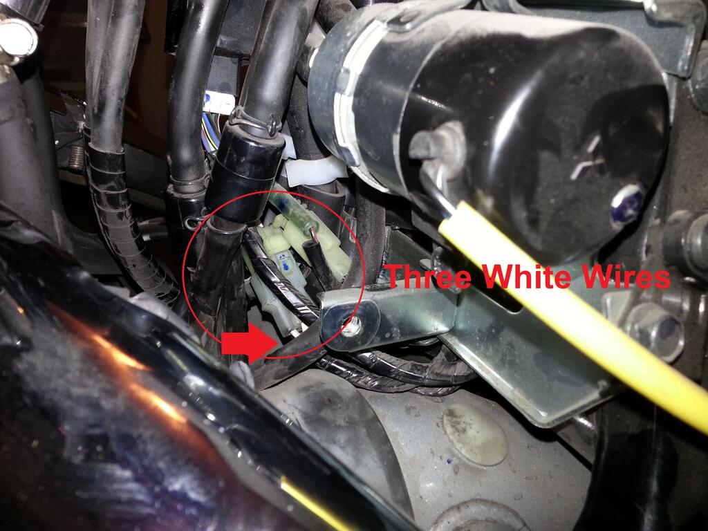

Du-Rron Posted August 23, 2020 Posted August 23, 2020 Thanks for all the advise! I took the battery over to an auto store and they did a load test and verified it's a ok. So I thought I would do the ohm test on the stator. I took off the left side panel and think I'm staring at the stator wire connection.. three wires in and out right by the fuse box. Can't for the life of me get the male to unmount the female so to speak. Pushing on the little tab. Etc. Does this look like the right connection? Any advise for this novice? No, I believe that is the fuel pump connector. I think the one you want is behind the center panel, next to the "left" panel you just removed.
