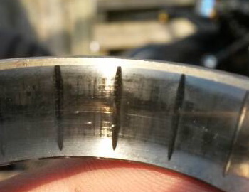

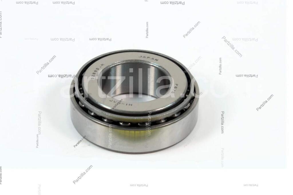

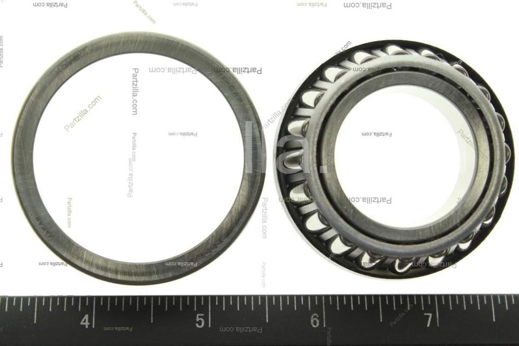

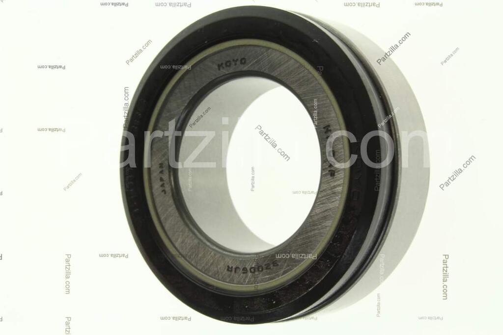

The head bearings are not ball bearings on the Venture. From the factory they are tapered roller bearings.
Personally, I prefer genuine Yamaha parts. And yes, replace the races, they are included; the race is probably dented (brinelled) and is the cause of the "notchy" feel you experience.
Top bearing part number: 93332-00001-00
Bottom bearing part number: 93332-00008-00
93332-00001-00, top bearing.jpg93332-00008-00, bottom bearing.jpg93332-00008-00, bottom bearing .jpgbrinnelled race.jpg
