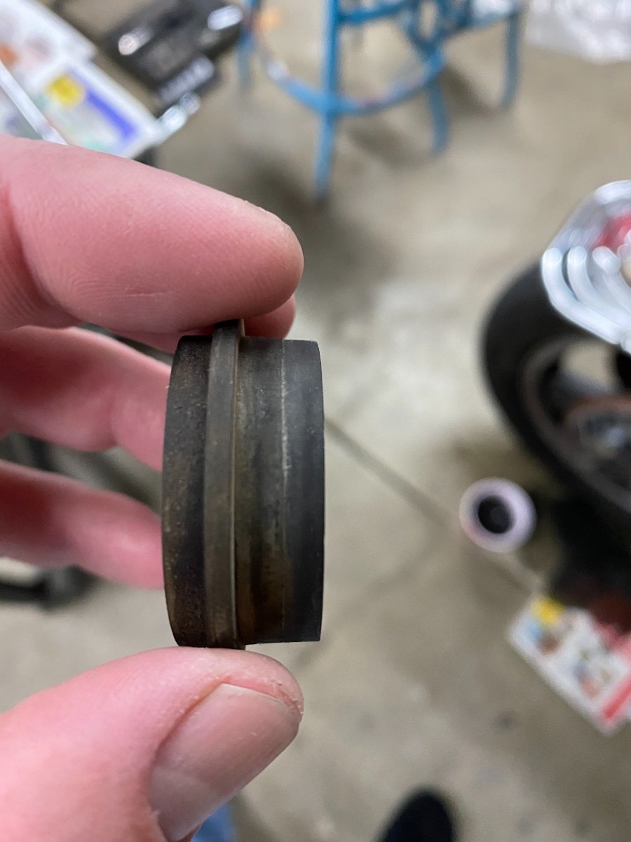

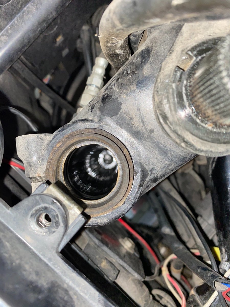

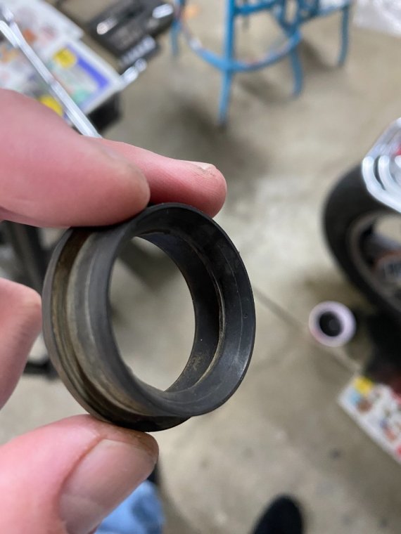

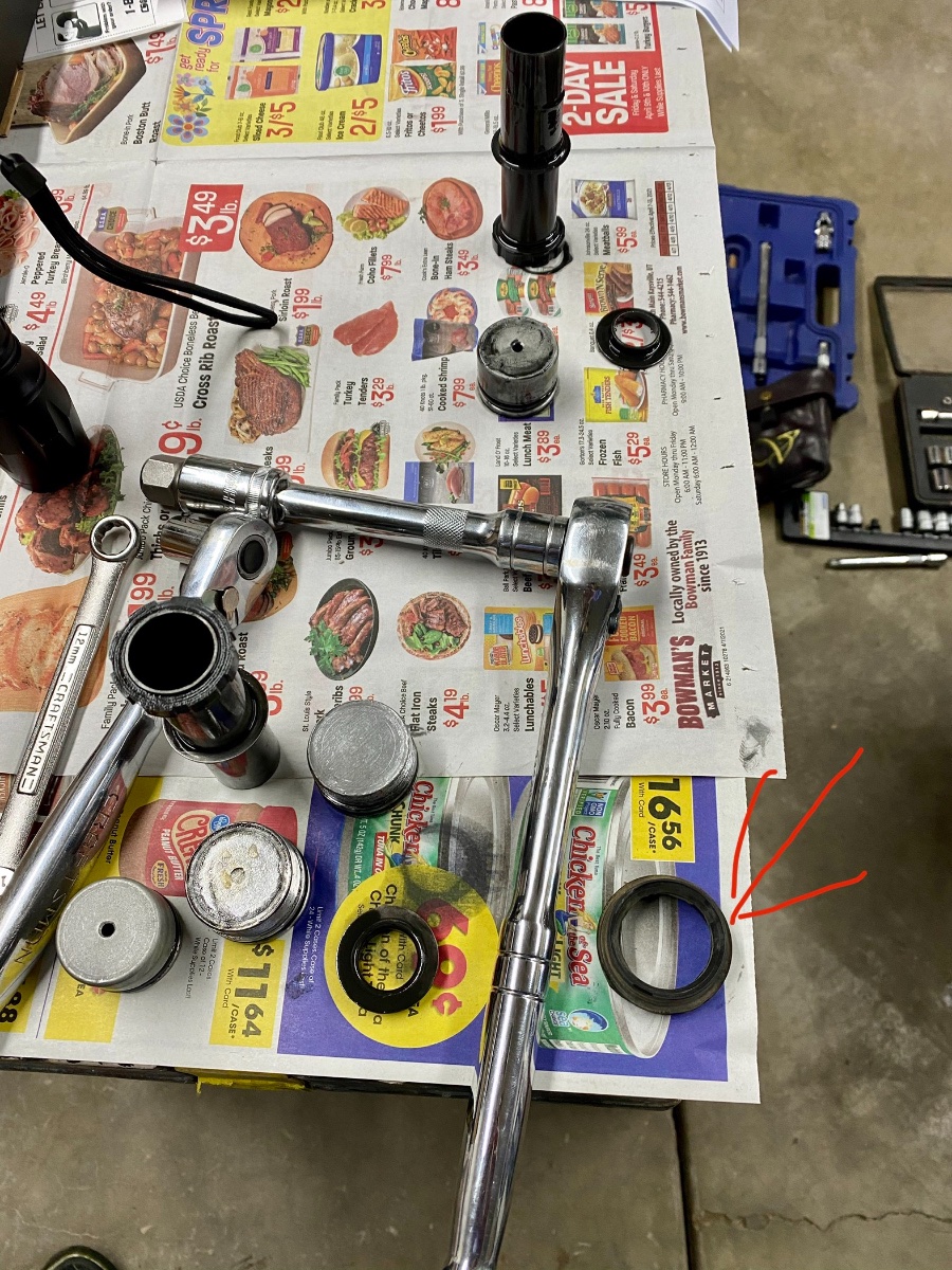

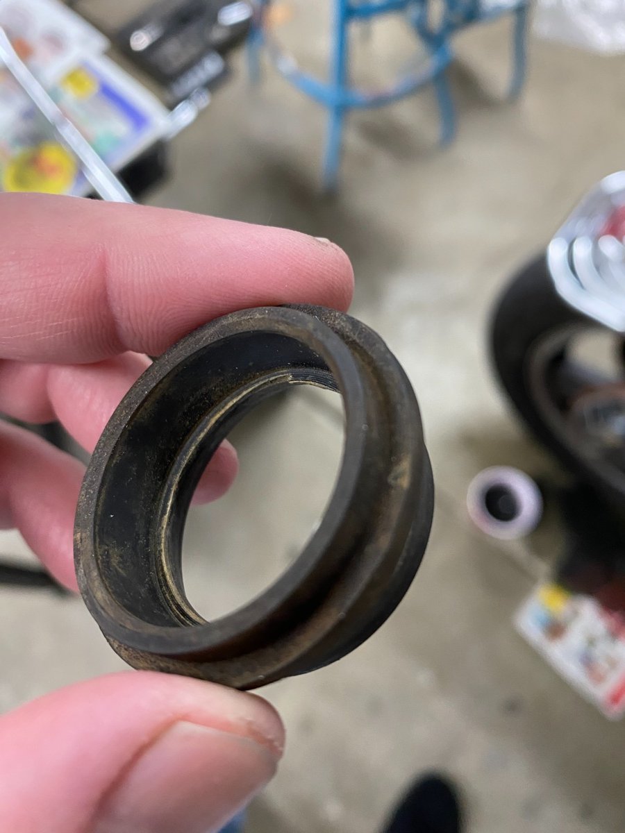

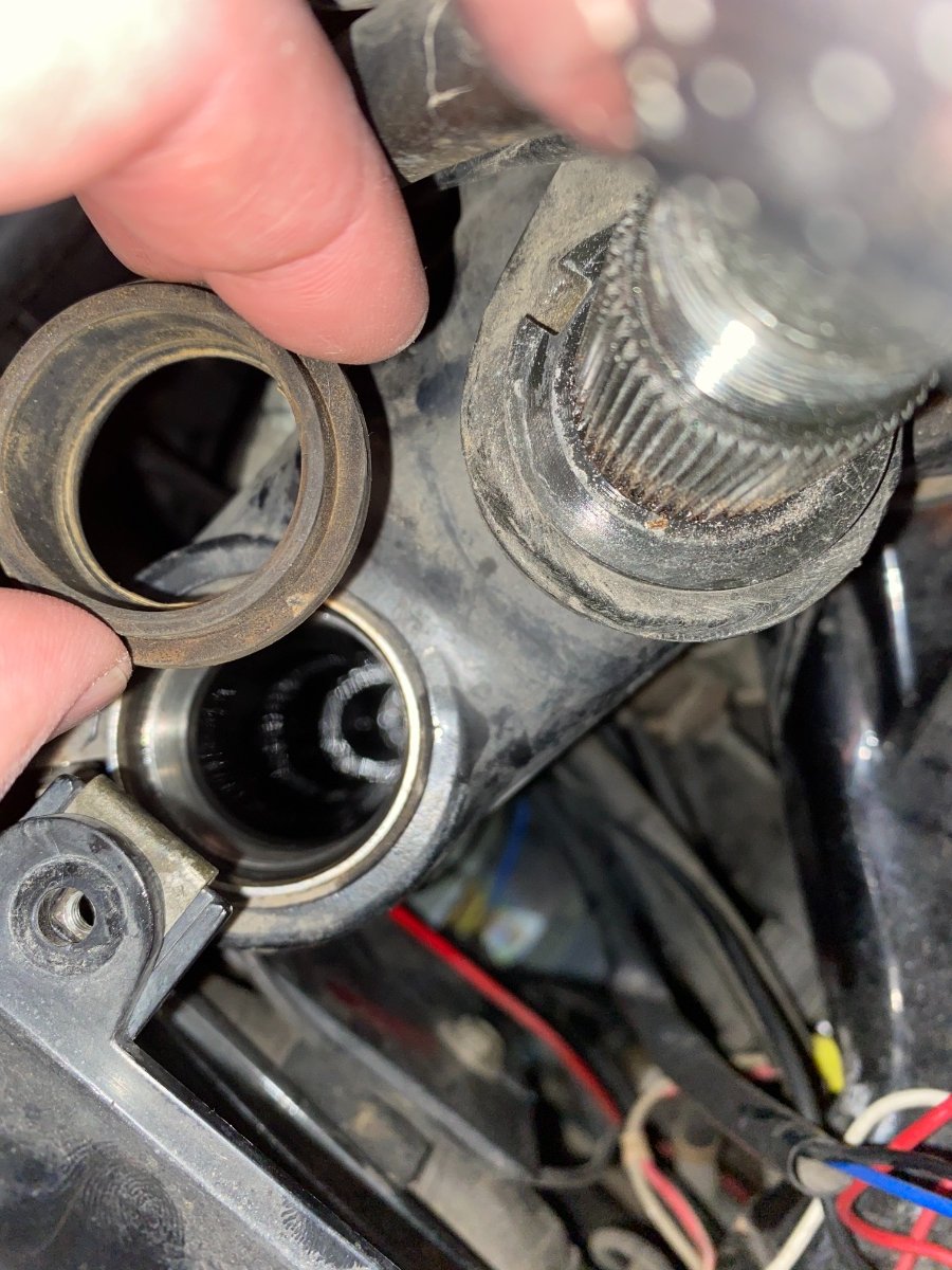

Pasta Burner Posted April 19, 2021 Author #17 Posted April 19, 2021 Where does this piece go? I removed the caps with the 17mm hex, then removed the drain plugs and then wiggled things around a bit and the front end dropped. The left side spit it’s guts out all over the garage, the right side got caught on a trim piece and stayed in place. Using the right side as a template to what all came out and how I took it apart but did not come across this rubber boot. It’s dirty so it was exposed to the elements, not internal but doesn’t seem to fit anywhere.
saddlebum Posted April 19, 2021 #18 Posted April 19, 2021 (edited) Its hard to tell from the picture but it looks like maybe the dust boot from the top of the lower tube. Or the seal you forgot to put on when you serviced the air cleaner on your lawnmower. Edited April 19, 2021 by saddlebum
Pasta Burner Posted April 19, 2021 Author #19 Posted April 19, 2021 (edited) It fits perfectly in the top tube but then the bolt wouldn’t fit and I don’t recall seeing it when I took the caps off. Not the lower dust boot. Could be a random piece that just showed up from another project, but I’ve had nothing else going on. Edited April 19, 2021 by Pasta Burner
saddlebum Posted April 19, 2021 #20 Posted April 19, 2021 Looks like the boot that goes around the ignition switch and sits in the plastic cover. 1
Marcarl Posted April 19, 2021 #21 Posted April 19, 2021 There is a seal that goes on the lower tube before you slide the inner tube in. There is also a seal that goes inside. The one inside seals the 2 tubes and keeps the oil and air in where they belong, the one on top and on the outside is more of a dust and dirt seal, is larger and thicker, and has only a small collar that sits inside the lower tube.
Pasta Burner Posted April 19, 2021 Author #22 Posted April 19, 2021 On 4/19/2021 at 12:19 PM, saddlebum said: Looks like the boot that goes around the ignition switch and sits in the plastic cover. Expand We have a winner!! Thanks @saddlebum I wouldn’t have thought to look there. Springs installed and I was a bit shocked when I poured the new oil and I came out blue. Weather isn’t good for a ride yet but the forks have very minimal movement during a stationary compression.
