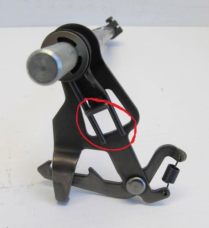

grubsie Posted July 31, 2020 #9 Posted July 31, 2020 Here's a pic of the shifter. The return spring (circled) fits over a pin near the clutch. Very easy to miss getting this spring on the pin if you have never done it before.

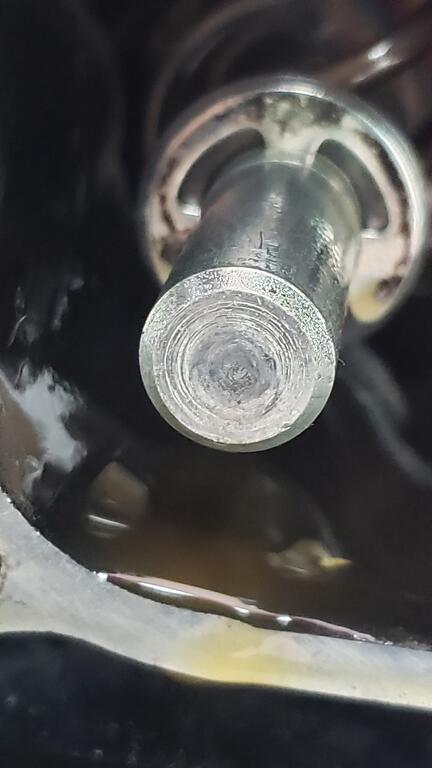

Phrog Posted August 1, 2020 Author #11 Posted August 1, 2020 grubsie said: Here's a pic of the shifter. The return spring (circled) fits over a pin near the clutch. Very easy to miss getting this spring on the pin if you have never done it before. I got to it and the springs were actually in place and good. When I got the clutch cover off, the shifter worked normally. Re-installed and it was working until I tightened the clutch cover. And the end of the shift shaft has friction marks from rubbing on the cover. (pictured) Doesn't seem to be bent/warped. Just too long.
grubsie Posted August 1, 2020 #12 Posted August 1, 2020 Just out of curiosity, are you using a gasket for the clutch cover? If not and just using sealant may cause the cover to get too close to the engine thereby too tight against the end of the shaft. It may need that gasket for a gap.
Condor Posted August 1, 2020 #13 Posted August 1, 2020 Phrog said: I got to it and the springs were actually in place and good. When I got the clutch cover off, the shifter worked normally. Re-installed and it was working until I tightened the clutch cover. And the end of the shift shaft has friction marks from rubbing on the cover. (pictured) Doesn't seem to be bent/warped. Just too long. I wonder if you have the right cover on the clutch?? a 1200 cover isn't as deep as the 1300
Phrog Posted August 1, 2020 Author #14 Posted August 1, 2020 grubsie said: Just out of curiosity, are you using a gasket for the clutch cover? If not and just using sealant may cause the cover to get too close to the engine thereby too tight against the end of the shaft. It may need that gasket for a gap. Yes I'm using a gasket... I actually contemplated doubling up with the old and new gasket to give it just a hair more room, but I ripped the old one pulling it off. Condor said: I wonder if you have the right cover on the clutch?? a 1200 cover isn't as deep as the 1300 Yes, I'm using a 1300 cover, off of my original engine. All of this started because I replaced my engine, so I have spare parts. Chrome on the other cover is corroded, but I'll try it. I can also try swapping out the shift shaft.... Maybe it's just a missing washer or something.
Phrog Posted August 22, 2020 Author #15 Posted August 22, 2020 Has anyone ever run into shift shaft friction on the clutch cover causing no spring return on the shifter? I got everything working and no leaks. :dancefool:I ended up just buying another gasket and using 2. Gave it just enough room for movement and allowed me to tighten the clutch cover with no leaks. Maybe it's not the right answer, but it works and for a $10 fix, and only 30 min of install (yeah, I had to loosen the right side pipe to get to the bottom hex bolts) Any potential problems that I'm not thinking of?

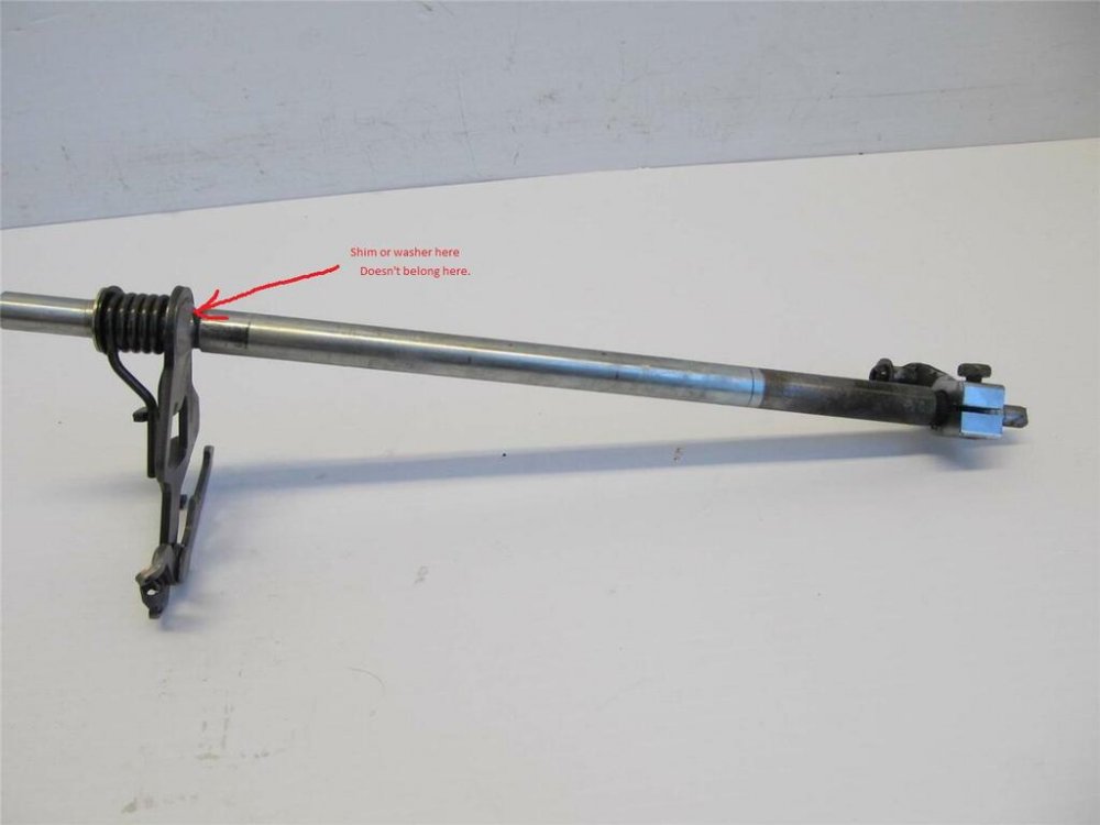

grubsie Posted August 22, 2020 #16 Posted August 22, 2020 Shaft friction could be caused by a washer/shim on the shaft behind the part that holds the spring. That would cause the whole unit to extend too far outwards towards the outer clutch cover. If there is a shim or washer on that side, your better off doing the double gasket instead of removing the clutch and the gear shift linkage on the the other side. I would just monitor for leaks for a while.
Phrog Posted August 22, 2020 Author #17 Posted August 22, 2020 grubsie said: Shaft friction could be caused by a washer/shim on the shaft behind the part that holds the spring. That would cause the whole unit to extend too far outwards towards the outer clutch cover. If there is a shim or washer on that side, your better off doing the double gasket instead of removing the clutch and the gear shift linkage on the the other side. I would just monitor for leaks for a while. Thanks! Thats kinda what I was thinking. I really didn't wanna tear into anything if I didn't have to. I'm just happy to be riding again!!! BTW, its amazing that you just happen to have a shift shaft laying around to take and show pics of!!! Thanks!
grubsie Posted August 22, 2020 #18 Posted August 22, 2020 Phrog said: BTW, its amazing that you just happen to have a shift shaft laying around to take and show pics of!!! Thanks! Not so amazing. I downloaded those pics from ebay and your welcome. Any time.
