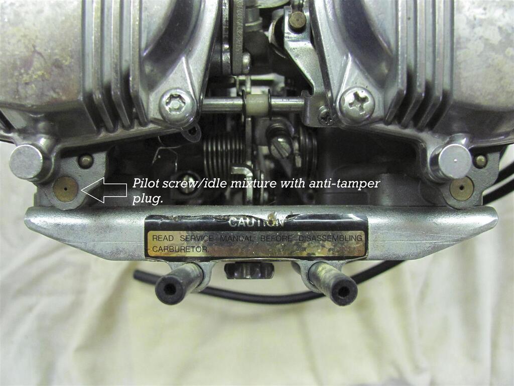

mttoews Posted July 29, 2020 Posted July 29, 2020 Sorry, i have searched for a while for the exact location of the pilot adjustment screws on my 84 VR. Any help or pictures would be helpfull. Thanks.

Condor Posted July 29, 2020 Posted July 29, 2020 They're located right at the underneath of the diaphragm cover. You need to remove the small cover and then a small screwdriver to reach the screw. Gently turn them counter clockwise until they bottom out and then back then out 2 1/4 turns. That should get it....

BlueSky Posted July 30, 2020 Posted July 30, 2020 They're located right at the underneath of the diaphragm cover. You need to remove the small cover and then a small screwdriver to reach the screw. Gently turn them counter clockwise until they bottom out and then back then out 2 1/4 turns. That should get it.... This should say clockwise until they bottom out.
