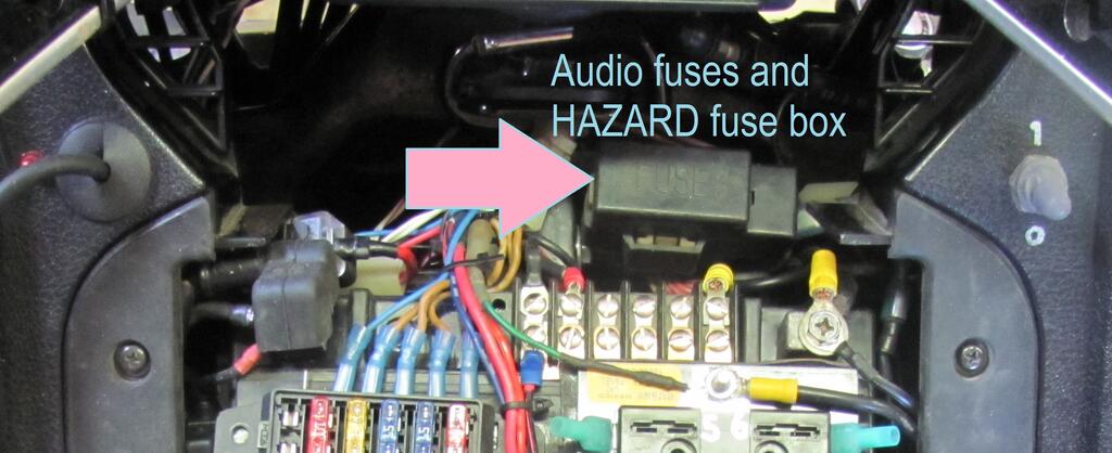

mgdawson Posted July 26, 2020 #1 Posted July 26, 2020 Any ideas why my radio loses presets after a couple days? Thanks
Prairiehammer Posted July 26, 2020 #2 Posted July 26, 2020 Any ideas why my radio loses presets after a couple days? Thanks There is a 5 amp ATC fuse for audio "back up" (memory). Perhaps it is blown?
BratmanXj Posted July 26, 2020 #4 Posted July 26, 2020 If that's not it, my '99 would randomly loose memory when the battery was starting to die. New battery and it's been fine since.
mgdawson Posted July 26, 2020 Author #5 Posted July 26, 2020 If that's not it, my '99 would randomly loose memory when the battery was starting to die. New battery and it's been fine since. Thought about that too but my battery is only a year old and crank the bike fine....fuse that Kevin mentioned was blown But Thanks
