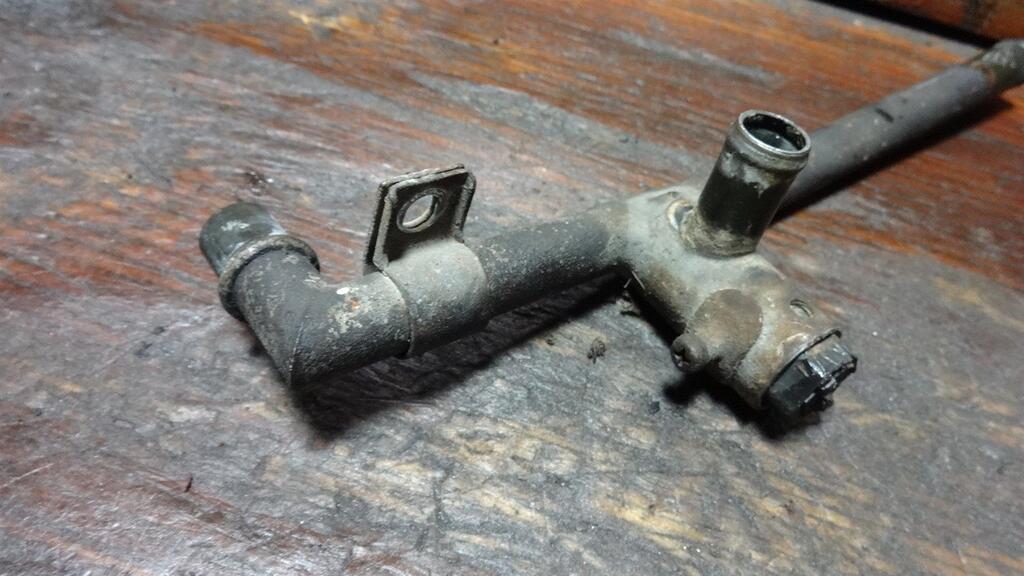

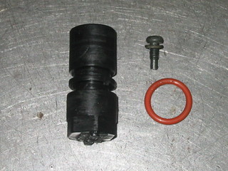

Prairiehammer Posted July 26, 2020 #3 Posted July 26, 2020 There is an O-ring on the "drain cock" (bypass valve) that often weeps coolant, dripping coolant into the lower cowling (chin fairing) where it may evaporate without evidence of the leak.
