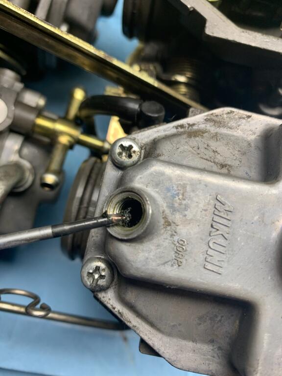

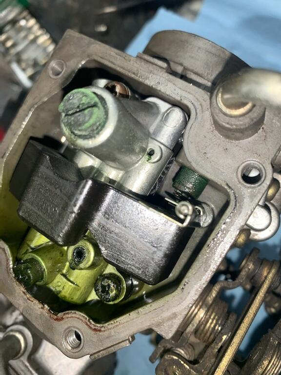

Someone was using gas with ethanol! I only ever use premium 94 gas since it will not have the ethanol in it which will attract water and do that to carbs if they sit. Check the label on the pump and make sure it doesn't say "may contain up to x% ethanol".
How long was the bike sitting for?

Believe me, I understand that at the compression ratio on these bikes it is a waste octane wise. I was suggesting 94 since here in Ontario and I assume other areas as well, 87 and 89 octane fuels pretty much always have ethanol blended in. Usually the 92 and 94 will be ethanol free which will be easier on the carbs and especially the rubber within. I tore apart the carbs on my parts bike which was clearly run with ethanol blend gas and the rubber stoppers on the Jets were crumbling and hard, as well as some other rubber hoses in contact with fuel.
Using the ethanol free fuels, I have never had trouble starting a small engine or bike after an extended time although i usually run the carbs dry before storage each year as well.

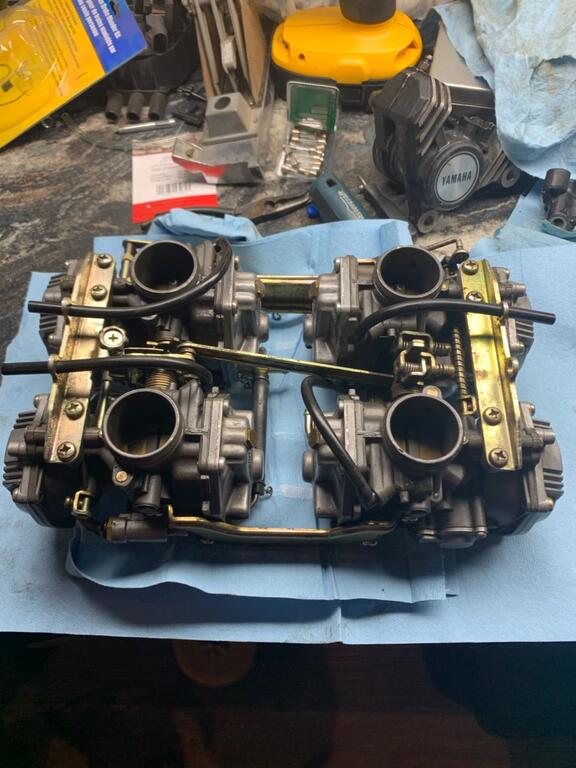

If you end up needing carb parts stick with OEM or K&L. Skip the discounted ebay stuff!
Be careful handling the slides, they are brittle and expensive.
It might need not much more than cleaning out the corn squeezings, reassembly and synchronization.

Also,, looking at the ugly pics of the carb having sit wayyyy to long,,, I have seen similar in 2 strokes indeed but I have also seen similar in 4 strokes that have been stored to long with heavy doses of SeaFoam/other fuel stabilizers. Gasoline will evaporate off over time no matter how much its doped up IMHO..
