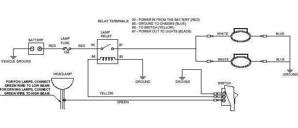

Need Help! Recently bought used 92 Venture Royale. Having issues with the headlight warning. The bulb tests fine so not sure why the Red Warning light (not flashing; just stays lit), and display indicator stay on. I've checked wiring, cleaned terminal blocks. I did redo the driving lights that were on it since one was halogen and other was LED. The display problem was there before redoing driving lights. When I got the bike the battery also showed but installed the resistor inline, since the battery was maintenance free type. The diagram shows the wiring for the driving lights. What am I missing?

I am probably wayyyyy out in left center field on this as usual cause I am far from any form a guru on any of this stuff but that schematic looks to me like a layout for wiring a set of driving/passing/auxillary lights up.. It looks like you are tapping into one of the headlight 12vdc inputs to use as a relay trigger for a relay switch that will send power from the battery to the extra lights when the switch is thrown.. The RLU (reserved lighting unit), in my recollect (dont trust it, it has gotten me into a lot of trouble,,, but has also saved me and others a couple times so I still use it - with warning), would be located upstream of the headlight wiring shown (where the green wire taps in) and would not be applicable to this fairly simple, generic schematic probably supplied with the add on lighting system (not all bikes use an RLU - matter of fact,, in my very limited experience with bikes,, the Yamaha Venture is one of all the bikes I have ever worked on that even uses one)..
I think if I were facing the issues that you @donens ,, I would begin with disconnecting the extra lighting from the headlight wiring and see if the warning light/dash light goes out.. My experience with the RLU is that if it detects any form of voltage or load change out there in the headlight wiring it will fault.. I got a hunch,, if the RLU is still operational, you will solve the question.. Of course, it is also 100% necessary that you maintain non-LED lighting in your headlight system - it also must remain OEM as LED lights pull to small of a load for the RLU to maintain a cleared status..
If, once the extra lights have been disconnected at the headlight wiring and you are using OEM spec incandesent lighting and the RLU still shows a warning/dash light then please come back and let us know..
Also,, if this does work, you will simply have to find another 12vdc source for the trigger coil in the relay being triggered by the switch.. Wiring the lead for the lights from the battery with a fused source is still correct..

Thanks for replies. Just disconnected the auxiliary lights from the headlight/switch and battery power. Still have the Red light and display headlight fault. Not sure which one is the RLU behind cluster.
By the way, there are no LED on the bike, halogen headlight, incandescent on the rest. Auxiliary are halogen, now disconnected.

On another note: Has anyone ever tried to fool the RLU or other safety circuits using diodes for any auxiliary components? In my case, using a diode on the headlight wire before the switch, thereby not allowing the headlight circuit to know there are other lights.
