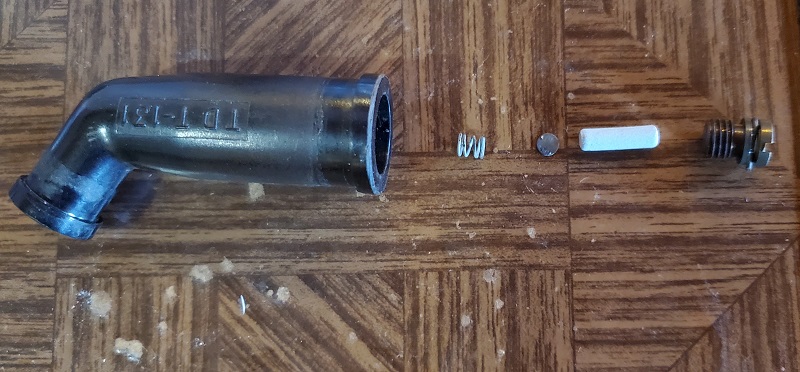

Mach VIII Posted July 16, 2020 Author #6 Posted July 16, 2020 Not a good night in the garage last night. [sigh] I checked the choke plungers and they seem to be operating correctly, so that can be ruled out. Connections to the TCI looked good, but I sprayed with contact cleaner regardless. I next disassembled the plug wire caps/boots. Inside I found: threaded brass plug retainer (for lack of a better name), resistor, spring, and small brass disc. The brass disc was missing from #4 . I cleaned up the parts, but struggled to figure out what order to reassemble the parts, as they did not really come out in a clear order. If someone could confirm 1) that those are ALL the parts I should find inside (excepting of course the missing disc on #4 ), and 2) the correct order of reassembly. After some figuring and fiddling, here's what I ended up doing: plug boot -> spring -> disc -> resistor -> brass plug retainer Also, I took the missing disc from #3 and installed it in the cap/boot for #4 just to see if that would get #4 to fire properly. I saw a picture in another post here a few days ago with all the parts laid out and describing the order of reassembly, but after looking for more than an hour, I cannot find it again. Here's the maddening thing - when I check the resistance with my meter, I get no reading whatsoever. I tried assembling the parts multiple ways, but still no resistance reading on my meter. WTH?! I tried doing the secondary resistance test again on the coil by inserting a probe into the (now assembled and attached) plug cap, but again, nothing. I do not understand how my disassembly, cleaning, and reassembly of the plug boots/caps could have done this. I will say that I did use a wire brush to clean off the resistors, but I can't see how that would matter at all. Just out of curiosity, I tried to check the plug boots for continuity with my meter, but still got nothing. But I don't know, maybe the resistor is too much for the little continuity tester in my meter to overcome???? Not knowing what else to do, I figured I would just plug in the TCI and temporarily hook up the battery to try and start it. Well the starter clutch is now making horrible noises at me and will only occasionally spin the motor over at all. The PO told me that he had JUST replaced the starter clutch because it made horrible noises (but again, gave up on making the bike a runner after realizing the carbs would need to come off). In my time of ownership it has occasionally done this, but mostly when the motor otherwise seems "unhappy." For example, it has done this far less since I removed, cleaned, and reinstalled the carbs. Usually if I wait a couple seconds and try again it will engage properly. Not last night. So now I can't even check to see if I have spark. From doing some reading on the subject, my guess is that the 3 bolts on the starter clutch have backed out. Oh joy. It's a good thing I don't live next to a body of water, or this thing might have ended up at the bottom of it last night I was so frustrated.

Mach VIII Posted July 20, 2020 Author #11 Posted July 20, 2020 Oh yeah, and can anyone tell me the correct order of reassembly for the spark plug boots/caps? As mentioned above, I took them apart to inspect and clean, but because of the way they came apart, I don't know the the correct order of the parts. I've tried multiple configurations but can't seem to get it right, as I no longer get any resistance or even continuity readings in them. I would at least like to get this issue sorted out while I await my starter clutch parts. Thanks!

luvmy40 Posted July 20, 2020 #13 Posted July 20, 2020 Mach VIII said: Oh yeah, and can anyone tell me the correct order of reassembly for the spark plug boots/caps? As mentioned above, I took them apart to inspect and clean, but because of the way they came apart, I don't know the the correct order of the parts. I've tried multiple configurations but can't seem to get it right, as I no longer get any resistance or even continuity readings in them. I would at least like to get this issue sorted out while I await my starter clutch parts. Thanks! Here is the correct assembly

Mach VIII Posted July 20, 2020 Author #15 Posted July 20, 2020 luvmy40 said: Here is the correct assembly https://www.venturerider.org/forum/attachment.php?attachmentid=119256 Perfect. Thank you for posting this. I believe I've got the order correct then. I did just come across an older post from 2010 stating that nothing abrasive should be used to clean the resistor or else it would remove a special coating. Ooooooops. If only I'd found that post about a week ago. I fear I may have just killed these caps (or the resistors anyhow). Looks like I'll be ordering some replacement NGK's as others here have recommended.
