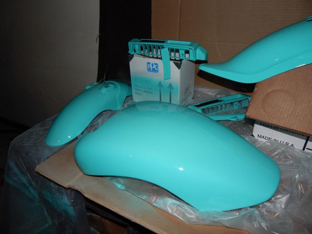

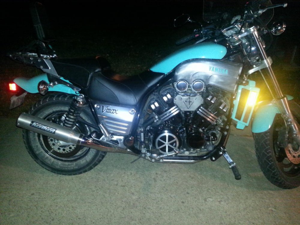

CaseyJ955 Posted July 7, 2020 #10 Posted July 7, 2020 Gray has a lot of range, I'd go that way. Any shades of tan or brown will probably make it look like you sideswiped a 74 LTD Country Squire Woodie. I painted my Vmax for two reasons, first I wanted a safer color than flat black, and I wanted a color that nobody else on the Vmax forum had. I choose a Turquoise and it came out a little lighter than I had hoped, but after I saw it in the sunlight I decided it was just about right. I have never seen a Vmax quite like mine, which was a large part of the point. I have never painted before, not seriously anyway. I went to a body shop and picked out the color and they put it in some spray cans that worked almost eerily well to lay the primer and color down, then I used a can (Probably two cans for a Venture) Eastwood/2k two part clear coat. It comes in the can also but has a bladder inside, when your ready to use it you just hit the button on the bottom to mix the two parts then you have a clock on getting it applied. It worked very well, I'm surprised by the results. Just like on cars, all the work is in the prep. On that clear coat, your going to want to breathe about 0% of that nasty crap, it's wicked toxic so ventilation and a resp would be great ideas for spraying that stuff. All and all it was very easy to work with and although it took a little more time and money than I wanted it's been years and the results are quite lasting. I like the gray idea, IMHO all the Germans have mastered making gray, silver, charcoal and gun metal very sexy exterior colors. Go for it. If you have trouble finding just the right shade try the BMW, MB and VAG (VW-Audi Group) colors. I think it's a great idea.
