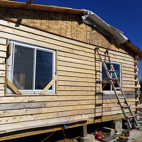

6 in cedar logs slotted and insulated strips on each row. building is 32x20 with the rear being 2 story for a sleeping loft. should be snug stout and safe vrs that stupid shed or my tent..... ya Think?

Snow can be your friend if you know how to use it. the roof deck has 1inch blue foam boards under the metal. walls are sealed between the 6 inch logs top bottom inside and out. inside walls have 1/2inch bubble wrap as a vapor barrier , 1 inch furring strips for the utilities to hide behind.
blue board and then a matching 6 inch plank walls inside. floors 2 inches of foam under the finish floor before I start installing kitchen bath etc.
Its a Basic structure with a lot of serious insulation. its going to require forced air ventilation as it is so tightly built

Oh and the roof Pitch, 3.5/12 2x6s the center beam to inside wall edge 11ft even, it will hold 6 ft of snow, the ridge beam is 6x12 it too aint even gonna move or droop. we snuggly :)

1st the exterior walls only represent R6 so that is not consider high by any current standard.
The 1/2 bubble rap (sliver reflective?) we'll say adds .5R
The air space between finish surfaces adds another .5R
Now I'm adding another 1R value for the double layer BUT it shouldn't be static air in this case but lets say it is...
That only adds to R8...!
True snow and there's plenty up there, heavy and wet the structure as described will hold that load but that is providing you tie the rafters, the 6 X 12" beam will not assist the walls or deflection(s) should the loads spread the walls at the top sill which is what will happen I promise if you are only counting on the ridge which is in compression as a mating plate!! Remember the roof loading aslo must include wind gusts plus snow plus materials: you may view it in simple downward forces but only if you cancel the scissor potential of the rafters!
OK, some will say "well the ceiling joist will take care of that" yes and no; it will depend on how the are tied to the structure, so yes when wind loads smack the broad sides of the walls they will switch to compression and cancel the loads, but not from top loading down! Did I hear you as Why?
