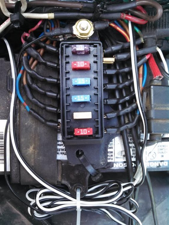

suds Posted May 22, 2020 #26 Posted May 22, 2020 Many others have done a better job than me, but here's what I did. I just picked up a block from Amazon like @saddlebum mentioned. Sent from my SM-G955W using Tapatalk
saddlebum Posted May 22, 2020 #27 Posted May 22, 2020 Same Idea except I replaced the old fuse holder and put my block in the same place were the old one used to be.
Poppa Phill Posted May 23, 2020 Author #28 Posted May 23, 2020 Same Idea except I replaced the old fuse holder and put my block in the same place were the old one used to be. That is exactly what I want to do. I had it all out yesterday whjen I cleaned up the ends to the plug wires which Im going to replace Payday, they are too short and too tight, no slack left. It should be here by tuesday and its not soon enough, nice looking work!
