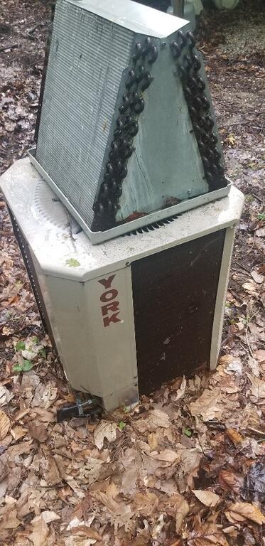

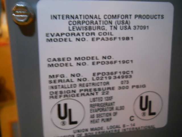

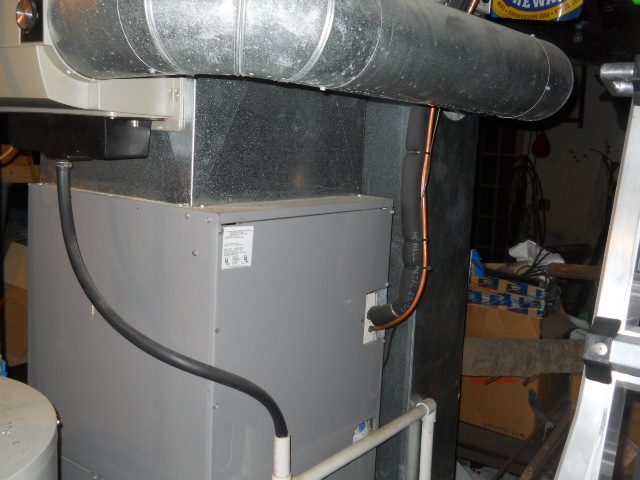

BlueSky Posted May 17, 2020 #3 Posted May 17, 2020 I'm assuming the condenser is in a unit outside and the evaporator is inside under the house or in the attic? How old? What brand? What rating? Does it have R22 refrigerant or something else? I think there is a substitute refrigerant that you can use in the place of R22 but I'm not sure about that. If the units are separate, you could probably buy a replacement outside unit on line and just hire someone to hook it up or hook it up yourself and hire someone to vacuum the lines and place it in service. I think the new outside units come charged with refrigerant. As far as matching the evaporator with the compressor, it seems to me that if they are rated the same it should be okay. Anyhow, My original heat pumps were Rheem (a 2 ton unit for upstairs and a 2 ton for downstairs) and they used R22 refrigerant. After many repairs over 15 yrs, I had them replaced. The main brands were $9k to $10k dollars, Trane, Carrier with everybody I checked with. I found an outfit that would install Goodman units for $6K and that is what I chose. They have been in service for 12 yrs now with one issue. I could have bought the whole system, both units on line for $3k if I could have installed them myself. The main thing to be aware of as far as I know is to make sure the compressors are scroll type. The cheapest units use a cheaper compressor. The one problem with the Goodman units after 9 yrs was the upstairs stopped working and it was diagnosed as a leaky evaporator. I pulled out my original receipt that said all part guaranteed for ten yrs. They said they forgot to register the units and the warranty wasn't validated. I said that sounds like a personal problem because my receipt says it's guaranteed. Anyhow, they replaced the evap in about an hour and charged me $500 for "labor" and refrigerant. They checked the pressures in the downstairs unit and they were a little low but since it was still working ok they didn't troubleshoot it. Just after the 10 yrs lapsed, it quit working. I got my hands on some R402A and found out my old AC gauges that I've had since the 70's fit my heat pumps so I charged it a bit myself and it is still working fine over a year later. So, if you have some auto AC gauges that worked with R12 they will work on the home units too.
cowpuc Posted May 17, 2020 Author #4 Posted May 17, 2020 I'm assuming the condenser is in a unit outside and the evaporator is inside under the house or in the attic? How old? What brand? What rating? Does it have R22 refrigerant or something else? I think there is a substitute refrigerant that you can use in the place of R22 but I'm not sure about that. If the units are separate, you could probably buy a replacement outside unit on line and just hire someone to hook it up or hook it up yourself and hire someone to vacuum the lines and place it in service. I think the new outside units come charged with refrigerant. As far as matching the evaporator with the compressor, it seems to me that if they are rated the same it should be okay. Anyhow, My original heat pumps were Rheem (a 2 ton unit for upstairs and a 2 ton for downstairs) and they used R22 refrigerant. After many repairs over 15 yrs, I had them replaced. The main brands were $9k to $10k dollars, Trane, Carrier with everybody I checked with. I found an outfit that would install Goodman units for $6K and that is what I chose. They have been in service for 12 yrs now with one issue. I could have bought the whole system, both units on line for $3k if I could have installed them myself. The main thing to be aware of as far as I know is to make sure the compressors are scroll type. The cheapest units use a cheaper compressor. The one problem with the Goodman units after 9 yrs was the upstairs stopped working and it was diagnosed as a leaky evaporator. I pulled out my original receipt that said all part guaranteed for ten yrs. They said they forgot to register the units and the warranty wasn't validated. I said that sounds like a personal problem because my receipt says it's guaranteed. Anyhow, they replaced the evap in about an hour and charged me $500 for "labor" and refrigerant. They checked the pressures in the downstairs unit and they were a little low but since it was still working ok they didn't troubleshoot it. Just after the 10 yrs lapsed, it quit working. I got my hands on some R402A and found out my old AC gauges that I've had since the 70's fit my heat pumps so I charged it a bit myself and it is still working fine over a year later. So, if you have some auto AC gauges that worked with R12 they will work on the home units too. House is 15 years old.. The evaporater is inside a plentum above the furnace and the condenser is outside sitting on a concrete slab beside the house.. I am not sure what size it is or what refrigerant it is.. I wonder if there is spec plate on either the condenser itself or maybe somewhere on the furnace.. I know that the plentum also supports and has a humidifier attached to the same area as the internal "A FRAME" evaporator.. I hear what @Marcarl is saying but also know that what you are saying is exactly what I noticed by shopping E-Bay... One of those "Goodman" complete condenser units on there for 600 or 800 bucks looks mighty inviting as a repair unit project.. I just thought I could save some cash and have some fun tinkering with it BUT,, I really dont wanna throw away the cash I could have used to hire it done... You know what I mean Sky,, I KNOW you do, your a do it yourselver too.. Anyway,, thanks to both you lop eared varmints for your advice!! Puc

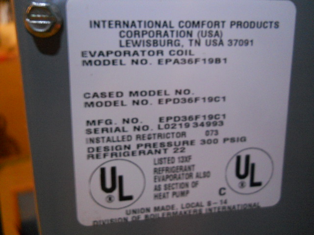

uncledj Posted May 18, 2020 #5 Posted May 18, 2020 (edited) You have a couple of options. First, let me say this has been my career since 1988, so this is the real dope. If your indoor coil is rated for heat pump use, it can be used with a new (R410) condensing unit. The heat pump coils were rated 400psi, while the cooling only coils were rated at 150, which is pushing your luck insofar as running the newer high pressure refrigerant. The older R22 coil (low side) would typically run 60-70 psi while the newer 410A runs around 125. It's been my experience that you've about a 50/50 chance of it being a heat pump rated coil. If you DO use the existing indoor coil you'll need to change the metering device, which could be as difficult as replacing the TXV (Thermostatic expansion valve) or may be as simple as removing a brass nut, easily accessible and replacing the orifice. As far as burn out / oil, if it's a bad burn out, you can flush it with RX flush or the like...not very difficult, but more than I'd like to get into by typing the text. If it's not a bad burn out, you can reuse what you have with no issue. They allow like 5 or 10% of the old mineral oil to remain without requiring a flush. There's usually not much oil in the lines / evaporator. Some...but not much... Beyond that, changing the condensing unit is pretty straighforward. Soldering the new unit to the old lines would be fine, but you should use a silver bearing solder. Stay Brite 8 is my preference. Having a vaccum pump handy would be nice, but you can get away without it....ask me how in a pm. The second and IMHO best option without spending the big bucks would be to replace the existing condensing unit with a good, used older unit that some guy took out of someones home when they wanted to "upgrade" (false) to the new stuff. They can usually be found on Craigslist for anywhere from $100 to $500. Brand doesn't matter, but size does. They're sold in half ton sizes from 1 1/2 on up, typically up to 5 ton for residential. The model number should have some multiple of 6 in it. 12,000 btu being a ton, ...a number of 18 would represent 1 1/2 ton...a number of 24 represents 2 ton...a number 30 represents 2 1/2 ton and so on. Lennox numbers are usually funky and don't stick to that standard. Get your existing unit info to me, and I may even have one out behind the shed that will work that I would offer gratis. Since I did the big cleanout, I got rid of a few of the ones I had, but I did keep a few as well. Last option would be to replace the compressor itself. The old compressors are getting hard to find, but they're still out there if you look. Compressor change isn't that big a deal either, but a new compressor will likely cost ya neighborhood of 5 bills. Get your info to me and I may be able to help. Did a quick Craigslist search from Central, OH and came across this. https://dayton.craigslist.org/app/d/greenville-used-ac-condensers-various/7123224350.html?lang=en&cc=gb Edited May 18, 2020 by uncledj Added link
cowpuc Posted May 18, 2020 Author #6 Posted May 18, 2020 You have a couple of options. First, let me say this has been my career since 1988, so this is the real dope. If your indoor coil is rated for heat pump use, it can be used with a new (R410) condensing unit. The heat pump coils were rated 400psi, while the cooling only coils were rated at 150, which is pushing your luck insofar as running the newer high pressure refrigerant. The older R22 coil (low side) would typically run 60-70 psi while the newer 410A runs around 125. It's been my experience that you've about a 50/50 chance of it being a heat pump rated coil. If you DO use the existing indoor coil you'll need to change the metering device, which could be as difficult as replacing the TXV (Thermostatic expansion valve) or may be as simple as removing a brass nut, easily accessible and replacing the orifice. As far as burn out / oil, if it's a bad burn out, you can flush it with RX flush or the like...not very difficult, but more than I'd like to get into by typing the text. If it's not a bad burn out, you can reuse what you have with no issue. They allow like 5 or 10% of the old mineral oil to remain without requiring a flush. There's usually not much oil in the lines / evaporator. Some...but not much... Beyond that, changing the condensing unit is pretty straighforward. Soldering the new unit to the old lines would be fine, but you should use a silver bearing solder. Stay Brite 8 is my preference. Having a vaccum pump handy would be nice, but you can get away without it....ask me how in a pm. The second and IMHO best option without spending the big bucks would be to replace the existing condensing unit with a good, used older unit that some guy took out of someones home when they wanted to "upgrade" (false) to the new stuff. They can usually be found on Craigslist for anywhere from $100 to $500. Brand doesn't matter, but size does. They're sold in half ton sizes from 1 1/2 on up, typically up to 5 ton for residential. The model number should have some multiple of 6 in it. 12,000 btu being a ton, ...a number of 18 would represent 1 1/2 ton...a number of 24 represents 2 ton...a number 30 represents 2 1/2 ton and so on. Lennox numbers are usually funky and don't stick to that standard. Get you existing unit info to me, and I may even have one out behind the shed that will work that I would offer gratis. Since I did the big cleanout, I got rid of a few of the ones I had, but I did keep a few as well. Last option would be to replace the compressor itself. The old compressors are getting hard to find, but they're still out there if you look. Compressor change isn't that big a deal either, but a new compressor will likely cost ya neighborhood of 5 bills. Get your info to me and I may be able to help. Thanks Unc!! I will get the info to you just as soon as it quits pouring rain so I can meander outside and look for a spec plate,, or two,, or three!! Puc

BlueSky Posted May 18, 2020 #9 Posted May 18, 2020 It looks like from the numbers your AC is a 3 ton or 36,000 BTU unit using R22. I just checked ebay and R22 is available for sale.
uncledj Posted May 18, 2020 #10 Posted May 18, 2020 (edited) Judging by the external appearance,....Indoor setup doesn't look bad at all. I'd definitely try to find a good, 3 ton R22 unit. Swap-out should be pretty quick and easy. Found this one in Toledo https://toledo.craigslist.org/for/d/toledo-central-air-conditioner/7091622616.html?lang=en&cc=gb I'll see what I have sitting out back....will let ya know when I get home from work. Edited May 18, 2020 by uncledj Added link
