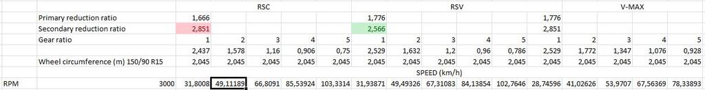

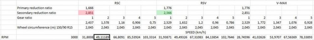

BokoFF Posted May 8, 2020 Posted May 8, 2020 (edited) Hello comrades! Today I made such a table and was at a loss! Why, with a weak engine, did Yamaha Royal Star Classic (97-2001) make such a transmission with high gears ??? After all, it is clearly hard for him to drag it. It seems that Ventura has already fixed it, and her engine is more powerful. Now it’s clear why the Royal Star Classic does not go as it should. Strangled from all sides, both in the engine and in the transmission. There is an option to install a reverse gear from V-max, but it has 1 tooth less, the speed sensor working from these teeth can begin to lie in a smaller direction. [TABLE] [TR] [TD][/TD] [TD]Royal Star Classic[/TD] [TD]Royal Star Venture[/TD] [TD]V-Max with V-Boost[/TD] [/TR] [TR] [TD]Power[/TD] [TD]75 HP / 5000[/TD] [TD]97 HP / 6000[/TD] [TD]140-145 HP / 9000[/TD] [/TR] [TR] [TD]Torque[/TD] [TD]112 Nm / 3500[/TD] [TD]123 Nm/ 4750[/TD] [TD]123,0 Nm / 7500[/TD] [/TR] [TR] [TD]Primary reduction ratio[/TD] [TD]85/51 (1,666)[/TD] [TD]87/49 (1.776)[/TD] [TD]87/49 (1.776)[/TD] [/TR] [TR] [TD]Secondary reduction ratio[/TD] [TD]21/27x33/10(2,566)[/TD] [TD]21/27x33/10(2,566)[/TD] [TD]21/27x33/9 (2.851)[/TD] [/TR] [TR] [TD]Gear ratio[/TD] [TD][/TD] [TD][/TD] [TD][/TD] [/TR] [TR] [TD]1[/TD] [TD]39/19(2,437)[/TD] [TD]43/17(2,529)[/TD] [TD]43/17(2,851)[/TD] [/TR] [TR] [TD]2[/TD] [TD]30/19(1,578)[/TD] [TD]31/19(1,632)[/TD] [TD]39/22(1,772)[/TD] [/TR] [TR] [TD]3[/TD] [TD]29/25(1,160)[/TD] [TD]30/25(1,200)[/TD] [TD]31/23(1,347)[/TD] [/TR] [TR] [TD]4[/TD] [TD]29/32(0,906)[/TD] [TD]24/25(0,960)[/TD] [TD]28/26(1,076)[/TD] [/TR] [TR] [TD]5[/TD] [TD]21/28(0.750)[/TD] [TD]22/28(0,786)[/TD] [TD]26/28(0,928)[/TD] [/TR] [/TABLE] Edited May 8, 2020 by BokoFF

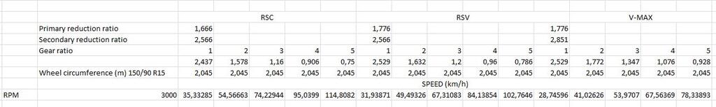

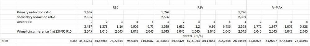

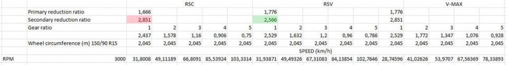

BokoFF Posted May 8, 2020 Author Posted May 8, 2020 I did some calculations at 3000 rpm. Take a look. With a weaker engine, the RSC should give more power to move. It is not clear why this is done.
BokoFF Posted May 8, 2020 Author Posted May 8, 2020 When installing a reverse gear from V-Max to Royal Star Classic, transmission performance is similar to Royal Star Ventura. Is it justified?
