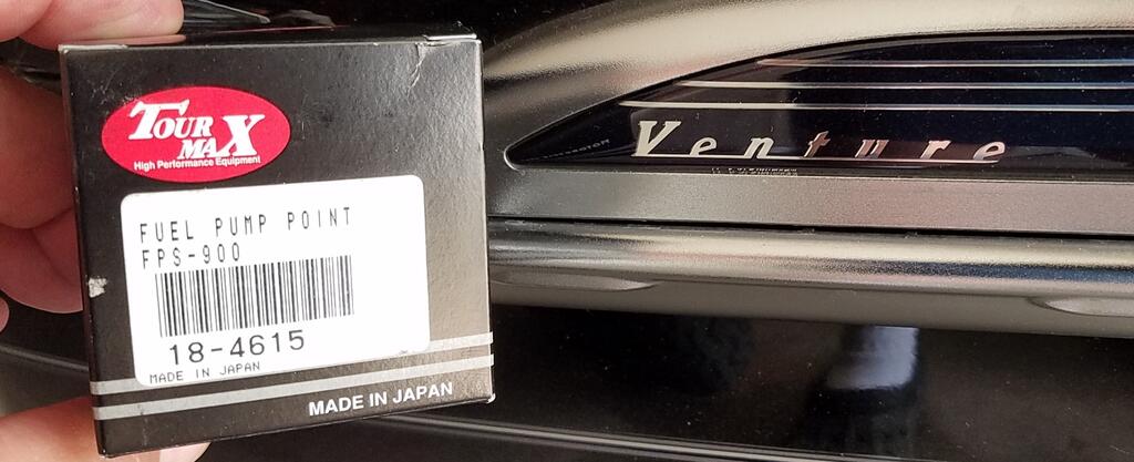

Try replacing the points first.

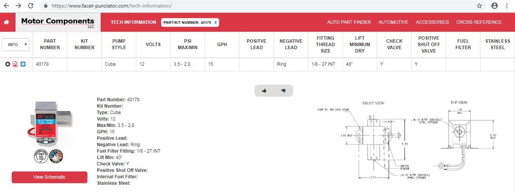

If you have to go electronic, Facet 40178
I did a Mr.Gasket pump. Some worry about the check valve thing. If you can afford it the Facet is a good alternative. Only advantage it has of the MG is a check vavle. I always shut my petcock off at end of day so It wasnt a huge deal for me. Make sure the vent tube is open before you go to far.
