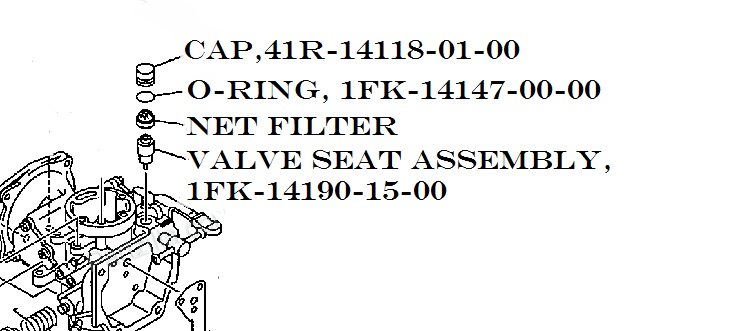

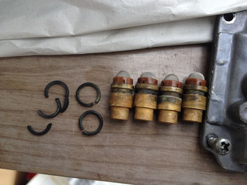

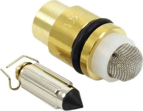

Doogie1982 Posted April 19, 2020 Posted April 19, 2020 I have a 1984 Yamha Venture Royale. I purchased a gas tank from a 1987 Venture Royale. Unfortunately it did not come with a gas cap. Is there any place I can purchase the gas cap? Also, one of the four carburetors does not appear to be getting fuel. I opened the drain screw and no fuel came out. All the other carbs appear to be getting fuel as I opened the drain screws and fuel came out. As a result the bike will not start. I have good spark to all four cylinders. Will the carb problem prevent the bike form starting?

saddlebum Posted April 19, 2020 Posted April 19, 2020 (edited) Sounds like maybe a stuck needle seat or float in the carb. Try gently tapping the carb in the area of the seat maybe even remove the fuel inlet line from the carb and see if you can shoot some carb cleaner in while tapping the carb. You can also try a bit of compressed air at low pressure but here you would need to use extreme caution. Also like Puc say's these things will run On 3 barrels. As a matter of fact they will run so well that unless you give it full throttle or your climbing a grade It is often barely noticeable that it's only running on 3 cyl's. If the bike is not firing at all and you have spark remove the air cleaner and check that the sliding tubes are not sticking which often happens when a bike sits for awhile. I have wet them down with some seafoam and then gently moved them back and forth with a screw drive to get them freed up. Also these guys get stubborn if you flood them. Take the plugs out and let her crank some to air out the cylinders. Be sure to blow around the plugs before you remove them. The area around the plug is a real catch basin for all sorts of stuff you do not want dropping into the cylinder. I once found a screw I thought went missing laying there. If she still wont fire dribble a bit of gas in through each carb opening if she fires then, well you will likely need to remove and service the carbs. Edited April 19, 2020 by saddlebum
