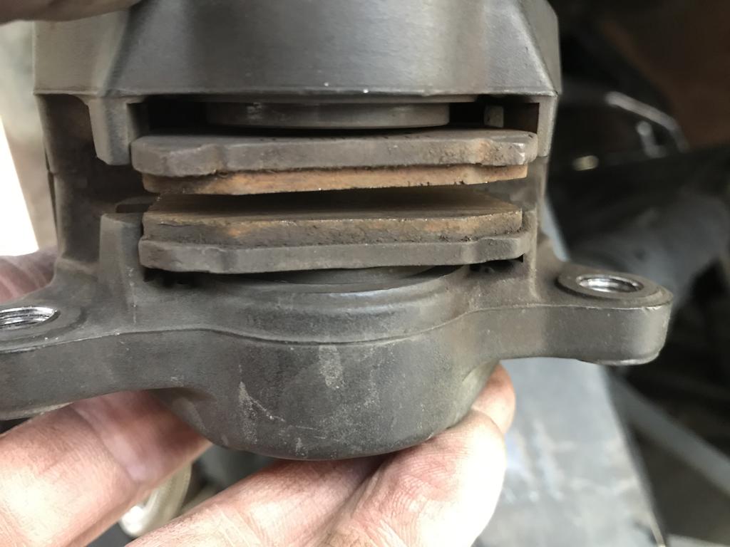

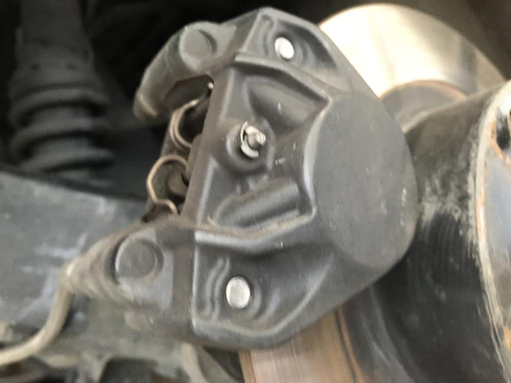

Guest divey Posted April 18, 2020 Posted April 18, 2020 Hoping to get some advice/info from other Hannigan owners here regarding rear brake pads. I've read most of the brake threads going back to 2010 or so but still have some questions. I've got a 2008 RSV with a 2010 Hannigan kit (35th Anniversary Edition if that makes any difference). I'm not the original owner and the dealer is out of business so can't follow up there. It appears about that same time, Hannigan had to replace a number of rear brake systems due to incompatible rotors and pads. I've added pics of what I have now. 1. How do I know if I have the old (incompatible) brake components or the new ones? What was replaced, the rotors or pads or both? 2. A few old posts talk about using EBC FA266 HH pads. Are those still the recommended pads and if so, are they compatible with my system? If not, what is recommended? 3. Does the pin that is held in place with a spring loaded wire on the caliber simply push out in order to remove the pads? Some m/c video's show the pin is threaded but this one simply has a C-clip on the end. I've tried pushing it out with a reasonable amount of force but no luck. Thanks for your help.......Doug

Guest divey Posted April 20, 2020 Posted April 20, 2020 I’ll try to run by the shop Monday and see if they’re closed for the Covid stuff going on. They’re usually pretty good with customer service. I just spoke with Brad at Hannigan Motorsports. Apparently the pad numbers should be on the back side of the old pads. I'll get them out and hopefully be able to order them locally. Turns out I have the old/original setup on mine. If you haven't already paid a visit to them, thank you for offering to do that. Doug

cecdoo Posted April 21, 2020 Posted April 21, 2020 Ok, rear suspension parts are from Honda Civic CRX 84-87 models Brakes are Brembo, Pads are EBC FA 266HH Pre 2012 conversions used 195/60-R15 Tires Aft 2012 conversions used 195/55-R-16 Tires I have a file copy of manual I can email you, my email is my screen name if you want to contact me Craig
