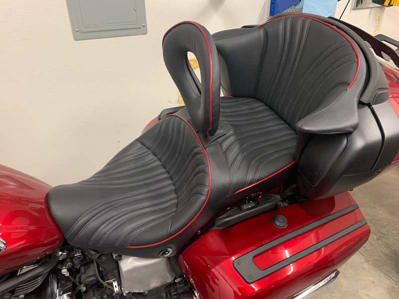

Safety_Don Posted March 21, 2020 Author #6 Posted March 21, 2020 I did receive the seat, heated, not cooled. No big deal for the lack of cooling. It's been dropped from Corbin's website. Install was pretty simple. You disconnect the seat heater harness and it's no longer used. The heat is either, on or off. The controls in the dash are now, "grayed out." I don't have enough miles yet to say it's better or worse than the stock seat. I had ridden 2 hours solid on the stock seat and had no complaints. What I needed was the backrest and I will say the Corbin is the best I've had. I'm 6'3" and the backrest makes the posture better and the ride much more comfortable. Was it worth $1500????? Well, the passenger seat was what was most important to me, but again the stock seat was pretty nice, according to my wife. I do sit one to two inches further back and I like that as well. I'll know more in a couple thousand miles.
RollinWoody Posted April 2, 2020 #7 Posted April 2, 2020 Safety_Don said: I did receive the seat, heated, not cooled. No big deal for the lack of cooling. It's been dropped from Corbin's website. Install was pretty simple. You disconnect the seat heater harness and it's no longer used. The heat is either, on or off. The controls in the dash are now, "grayed out." I don't have enough miles yet to say it's better or worse than the stock seat. I had ridden 2 hours solid on the stock seat and had no complaints. What I needed was the backrest and I will say the Corbin is the best I've had. I'm 6'3" and the backrest makes the posture better and the ride much more comfortable. Was it worth $1500????? Well, the passenger seat was what was most important to me, but again the stock seat was pretty nice, according to my wife. I do sit one to two inches further back and I like that as well. I'll know more in a couple thousand miles. https://www.venturerider.org/forum/attachment.php?attachmentid=118510 That seat sure looks comefy !! I ordered the raised back from Yamaha and will hopefully be installing this weekend , will see if the heated back works well . I had the Corbin on my last ride but the seat had been modified by previous rider and took some getting used too....

gregm Posted April 10, 2020 #9 Posted April 10, 2020 Safety_Don said: I did receive the seat, heated, not cooled. No big deal for the lack of cooling. It's been dropped from Corbin's website. Install was pretty simple. You disconnect the seat heater harness and it's no longer used. The heat is either, on or off. The controls in the dash are now, "grayed out." I don't have enough miles yet to say it's better or worse than the stock seat. I had ridden 2 hours solid on the stock seat and had no complaints. What I needed was the backrest and I will say the Corbin is the best I've had. I'm 6'3" and the backrest makes the posture better and the ride much more comfortable. Was it worth $1500????? Well, the passenger seat was what was most important to me, but again the stock seat was pretty nice, according to my wife. I do sit one to two inches further back and I like that as well. I'll know more in a couple thousand miles. https://www.venturerider.org/forum/attachment.php?attachmentid=118510 Sitting a few more inches back, do you feel the reach to the bars uncomfortably far? I'm the same height as you with a 35" inseam and would like all the legroom I can get but worry my upper back will start to ache if im hunched forward trying to reach the bars
Safety_Don Posted April 10, 2020 Author #10 Posted April 10, 2020 gregm said: Sitting a few more inches back, do you feel the reach to the bars uncomfortably far? I'm the same height as you with a 35" inseam and would like all the legroom I can get but worry my upper back will start to ache if im hunched forward trying to reach the bars The backrest adjusts quite a lot forward & back. It feels great leaning into the rest I can reach perfectly. It sets my posture a bit, I'm a real slouch on a bike and this way I sit back. Don
