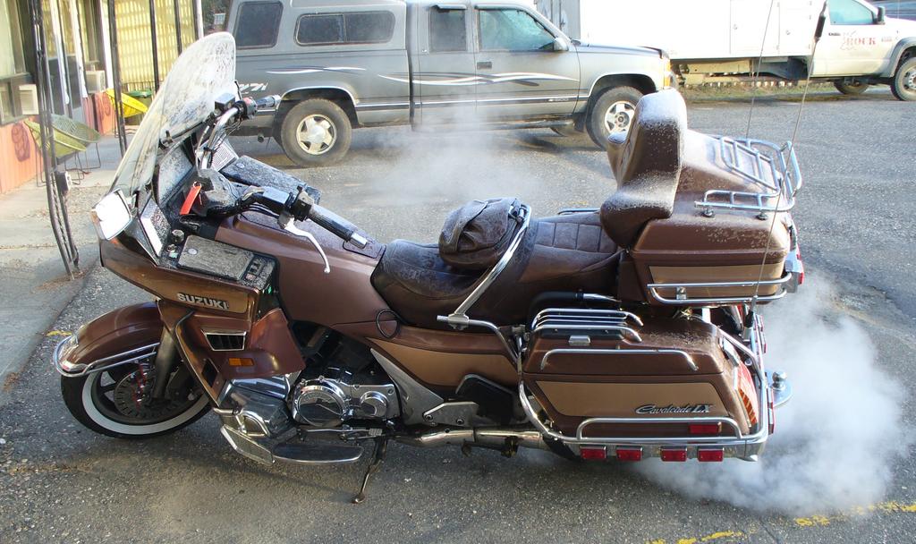

Venture Capitalist Posted February 16, 2020 Author #66 Posted February 16, 2020 "Thanks patch got the exhaust fixed, and it isn't leaking at all anywhere. But it just did something it has never done. Was going up to the store about 5 miles away halfway there the temp gauge hadn't left the very bottom then all of a sudden it started climb all the way to the top quickly. " OK we'll start here: the thermo switch is an inline a unit (at least in my manual) when the engine heats up the flow from the pump drive the hot fluid to the rad and past the switch which is in fact a resistor which alows for more curent to flow thru and feed the meter. If as you say the meter was disturbed then there remains a problem to address? perhaps So I stopped and the radiator was steaming a bit for a few seconds. The rad was still cold as in your mild winter cold, so as it warmed it may have just melted some ice that had accumulated from condensation? Then as it evapped the steam you saw diapered! likely If the engine is overheating then the rad will boil over and the engine will ping like that of a car with loss of power. "What I've done so far is fix the hose, flush the rad and change the tstat. Would a water pump cause that to happen? or could it be something more serious? " Yes the pump will cause over heating issues. Now important to run the correct 50/50 mix or slush will result on the rad, the sudden input of hot coolant transfer will cause a thermo shock and the rad can split. The bypass sounds like you need to verify it is in the correct position, take a look at how it made or shows in the book, mine show OFF not onand there is an alignment mark at 2 o'clock. It needs to allow a constant flow this help control the thermo cycling by maintain a closer consistent combustion temperature near the combustion chambers. In other words we don't want the combustion chamber mass to keep cycling thru ups and downs! Ok, I've checked and triple checked the alignment on the drain valve and yes I have been running it with it in the off position which the book says. The tstat does go in the the large spring end facing the ground correct ? I'm not 100% sure but pretty close that's the way I took the old one out. You know how when you check a car to see if the water pump is working you can just start it with the rad cap off and when it heats up see if the water starts circulating. I suppose the same should be true for a bike? I was look at the manual on water pump disassembly. It says to take off the gear and the impeller shaft and remove all the deposits. I could go that far do you think that might help? I don't have one of those circlip tools but you can use a screwdriver can't you? I would want to go as far as the book on disassembly talks about, into the seals and everything, the seals are probably good anyway, I don't have any oil in my water or any water in my oil and no leaks anywhere

Venture Capitalist Posted February 17, 2020 Author #74 Posted February 17, 2020 well, I was about to just go take the new tstat out and see what happened, but before I did I thought of putting the old one in a pan of boiling water and it opened up and closed when I took it 3 times so I put that back in. I didn't ride it just fired it up and watched the gauge and it came up nice and slowly like it used to. So what could have caused the hose to bust in the first place? While I was watching the temp needle I kept checking to see if the fan had kicked on but it never did. I let it get to about halfway between the halfway mark and the red. Should it have come on by then? At least now it's back to how it was before I blew the hose.
