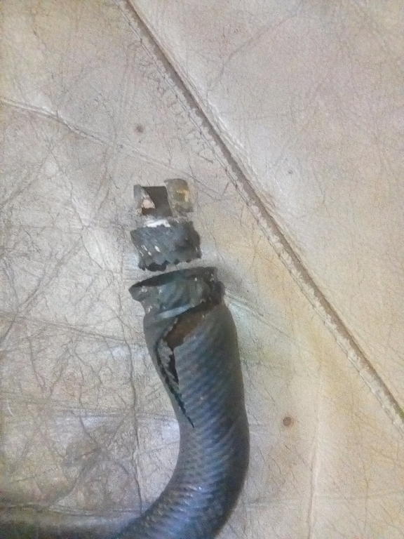

Patch Posted February 7, 2020 #20 Posted February 7, 2020 From here it sounds like you are referring to a "barb fitting" of sorts? Can you post a picture..
SpencerPJ Posted February 7, 2020 #21 Posted February 7, 2020 Yup a picture OR at least look at the part breakdown links from above and give us a better clue. I wouldn't be surprised to find a broken off piece, especially if plain water has been added over the years, corrosive. Even the case, they make self tapping inserts etc, and parts are readily available for these machines. And you are correct, nothing magic about the hoses, but if you can find the correct one, it will have pre-bent corners etc, they do work much nicer. If you can get to a regular size computer screen, looking over the parts diagrams is much easier than if you are on your phone.
RDawson Posted February 7, 2020 #22 Posted February 7, 2020 A trick I use on old hoses is to work a hooked pick between the hose and nipple to break it loose before I pull or twist on it. I know I'm a little late with this but it could save some trouble in the future.
cowpuc Posted February 7, 2020 #23 Posted February 7, 2020 Sounds to me like you pulled the hose nipple from the casing and it is still in the hose? Pictures would help.. If hose connectors are not threaded and screwed in place, IMHO, it is not uncommon for them to be "smudge" fit and fairly easily removed when tugging on hoses.. The simple fix is to take a knife and slice the old hose (unless you are going to reuse hose - in your case you are replacing with new) to remove nipple.. Clean nipple and area in case where nipple was removed. Smear a light coat of YamaBond 5 or other sealant to area on nipple that will meet the wall of the case opening. Start nipple into hole by pushing down on nipple with finger being careful to not get it crooked.. Tap the nipple till you feel it bottom out with a plastic hammer - be careful not to damage it - use finess.. The smudge fit is common in places like carb, petcock and case fittings and as amazing and hard to believe as this sounds,, I have replaced many of them back into thier homes and never had a problem with them leaking and actually very seldom use a sealer when replacing em.. Does any of this make sense:fingers-crossed-emo
Venture Capitalist Posted February 7, 2020 Author #24 Posted February 7, 2020 Yup a picture OR at least look at the part breakdown links from above and give us a better clue. I wouldn't be surprised to find a broken off piece, especially if plain water has been added over the years, corrosive. Even the case, they make self tapping inserts etc, and parts are readily available for these machines. And you are correct, nothing magic about the hoses, but if you can find the correct one, it will have pre-bent corners etc, they do work much nicer. If you can get to a regular size computer screen, looking over the parts diagrams is much easier than if you are on your phone. ok trying to send a pic
Patch Posted February 7, 2020 #25 Posted February 7, 2020 a picture of wherre it connects to the head is needed.
