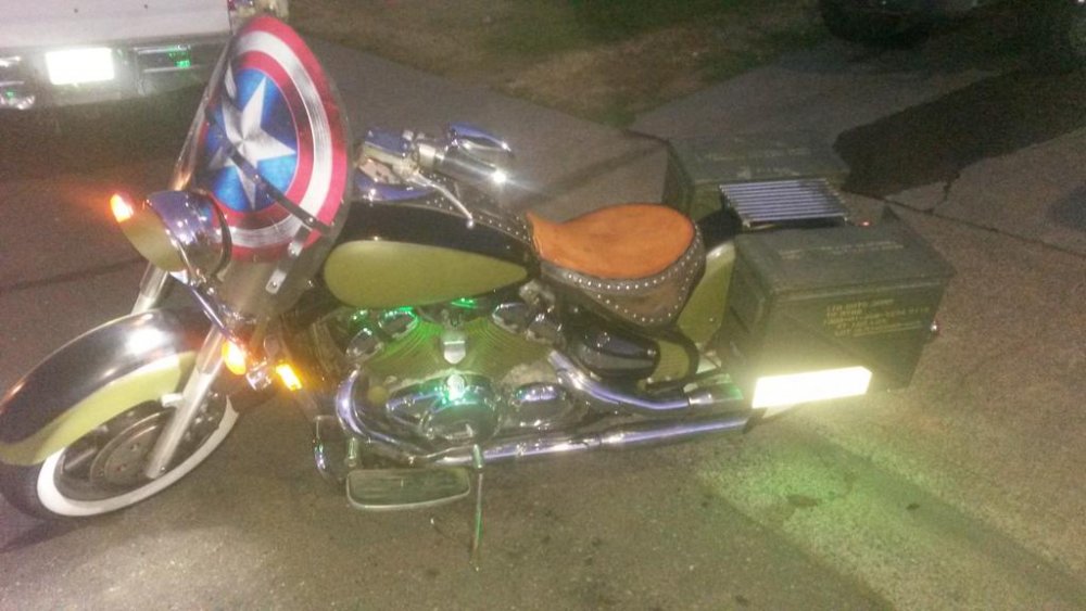

Mojankie Posted January 5, 2020 Posted January 5, 2020 (edited) Was riding down the freeway on my 96 Royal Star a few days ago when I lost all speed and power. Went to to pull it over and as I was getting to the side the rear wheel locked up. Rear tire was completely locked up, would not rotate. Got it home and checked the rear brakes, they were not the problem. Jacked it up and took out the axle bolt, everything there was fine. Dropped the tire and checked the drive shaft and final drive, nothing was locked up. All looked in good shape. She runs fine, when I put her in gear and let out the clutch the transmission acts like its locked up. The bike will stall out if I let the clutch out all the way. Doesn't matter what gear it is in, she dies. My dad is letting me use his account here to get some answers as I have no idea where to go from here. Any idea how to get her back to running would be much appreciated. By the way - I have named her "Peggy". Edited January 5, 2020 by Mojankie Added Picure

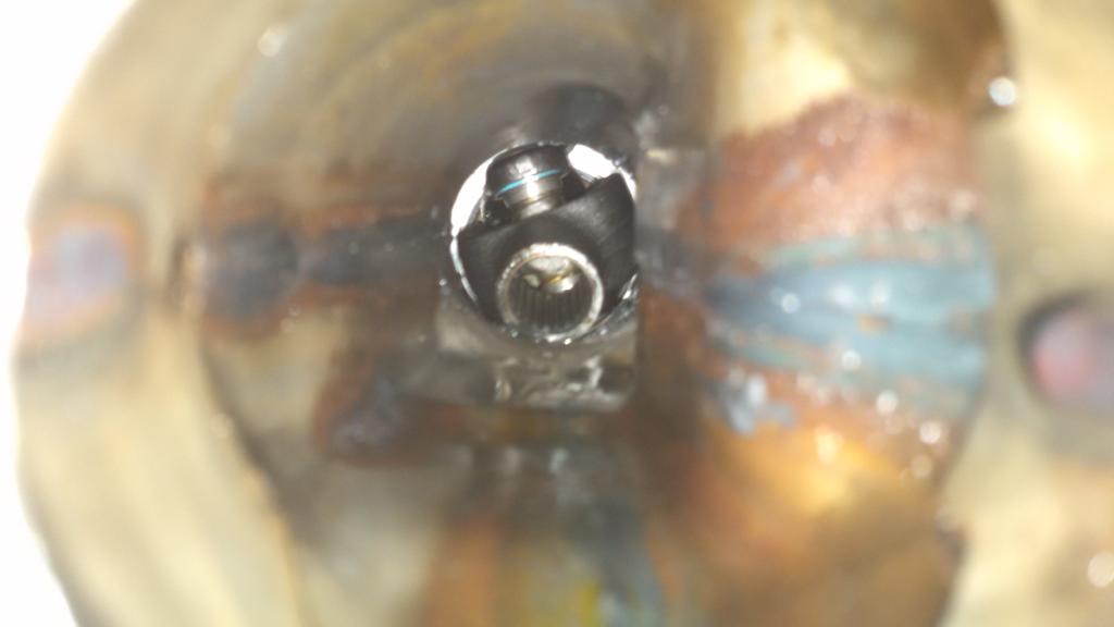

RDawson Posted January 6, 2020 Posted January 6, 2020 In the original post you said you checked the final drive and drive shaft. If you didn't re-install those then you should be able to shine a light in the tube and see the u-joint. If you did re-install the final you have to make sure the driveshaft aligned in the u-joint, that usually takes a little work.
videoarizona Posted January 7, 2020 Posted January 7, 2020 I'm adding my two cents: Look at the U joint. It's easy to get to. If the bolt broke that holds the U joint to the output shaft, it could have locked up the drive train. There were a few years where the bolts weren't treated properly during manufacture...causing them to break after years of service. I would also take the pumpkin apart...the rear end...and look at the end of the drive shaft where it enters the rear end. Look to see if that sheared off as well. Mine did. Though it didn't lock anything up...just created a loud whine when decelerating. These motors are very robust...so it's always best practice to look at the easiest stuff first. This is my U joint looking through the drive shaft tunnel. It moved around but didn't fall anywhere so I knew it was good. This is a shot of my drive shaft broken at the rear end...the thing sheared off.

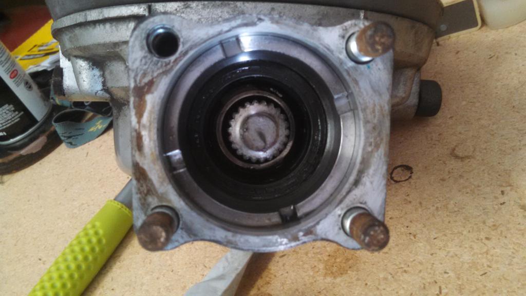

Mojankie Posted January 9, 2020 Author Posted January 9, 2020 (edited) Wow! You guys are awesome!!!! I knew there was a reason I renewed my membership. This is the Dad here now. So, Like he said before, He pulled the rear brake, dropped the rear wheel, pulled the final drive, pulled the clutch basket, everything did not show signs of the problem there. While the basket was out, we were able to look in and see the transmission gears, shifting drum works correctly, minor movement in shaft, gears etc. Concluded that the internal parts were as close to functioning correctly as we could deduce without opening up the case. Next we talked it through, had a conversation with Mike the Guru (diamond cut guy) and headed towards the output shaft. I figured if stuff was turning on the inside, it had to exit somehow - and the output shaft seemed like the first place to start. My son pulled the swingarm and then the output shaft - it is seized. It smells like it got HOT. I even see tempering color at the base of the yoke. I am thinking that is the problem! I assume there is a lubrication problem - Any ideas why? Also, I see the number 61 on the flange. Is that the thickness of the shim? I see an output shaft on ebay that has 73 on the flange. Is there a specific way that you set the pinon tolerance? Again, Thank you guys for all the help and ideas. Edited January 10, 2020 by Mojankie
videoarizona Posted January 9, 2020 Posted January 9, 2020 (edited) My son pulled the swingarm and then the output shaft - it is seized. It smells like it got HOT. I even see tempering color at the base of the yoke. I am thinking that is the problem! I assume there is a lubrication problem - Any ideas why? Also, I see the number 61 on the flange. Is that the thickness of the shim? I see an output shaft on ebay that has 73 on the flange. Is there a specific way that you set the pinon tolerance? +++++++++++++++++++++++++++++ If in the above, you are talking about the middle gear shaft, part 12 on page 4-104, then yes, there is a specific procedure to set the shims for the shaft tolerance. Lubrication here is provided by engine oil. Any issues here will mean major teardown of the engine/transmission. If you are talking about the drive shaft itself...that is located in the swing arm, then no, there isn't any alignment procedure other than lining up the rear end of the driveshaft housing...to the front end of the rear end....a simple procedure. The swing arm provides the alignment of the drive shaft to the output U joint and the rear end. The procedure for aligning the rear end to the drive shaft is done by putting the axle back into the rear end, tightening the 4 acorn nuts that connect the bolts on the rear end to the swing arm equally to spec then making sure the drive shaft can be pulled(moved) easily in and out. This aligns the rear end to the drive shaft assembly. Like I said...really simple stuff. Well documented on this site by others... Page 7-74 gives the breakdown of the shaft drive troubleshooting. The shaft drive connects the output of the transmission at the U joint on the front end of the shaft. Lubrication at that area is provided by grease supplied at the joint by the owners. The rear end of the drive shaft goes into THE rear end and is lubricated by the oil of the rear end itself. If you are talking about the drive shaft being frozen, then either the middle gear shaft is frozen somewhere along it's 90 degree path to the U joint, or the rear end of the bike is locked up. The drive shaft itself "may" cause a lockup at the U joint if not lubricated but that would also show issues with the splines on the U joint itself...and require replacement of that U joint. A major task. Similar lock up "may" occur at the other end of the drive shaft if the rear end is dry....but I would think other parts would be responsible for the lock up...like the final output drive gears or bearings. They are kind of like a reverse of the middle gear...a 90 degree turn from along the bike's axis to the rear wheel. Pages 7-83 and 7-84 diagram the final output drive or "rear end". To download the manuals...go here: https://www.venturerider.org/forum/forumdisplay.php?91-Manuals-Guides-Parts-Diagrams-Etc Download the RSV service manual and the RSV parts manual. These bikes are very well built. So I would recommend you read the manuals to familiarize yourself more...then simply look at what you have going on. Do some more diagnosing and looking around then come back and let us know where you are. I'm heading out of town for a few weeks, but there are a ton of guys and gals here who know far more than I and they will jump in...Good luck! I'll be interested in finding out what you find as major issues with these scoots are not common. P.S. Page 7-77 (I think) shows the entire drive train assembly...just to give you an overview.... Edited January 9, 2020 by videoarizona spelling/add
Patch Posted January 9, 2020 Posted January 9, 2020 Still and if the rear is apart as you mention, I would run the engine place in gear say 2nd, release the clutch and prove it stalls with all the rest of the drive off. In my experience when a bearing seizes it should be blue. Both the shaft and bearing are tempered during manufacturing. Now if the unit is seized then consider the last ride a horseshoe or a 4 leaf clover I bet Kevin has a Yam bulletin if yam put one out?
