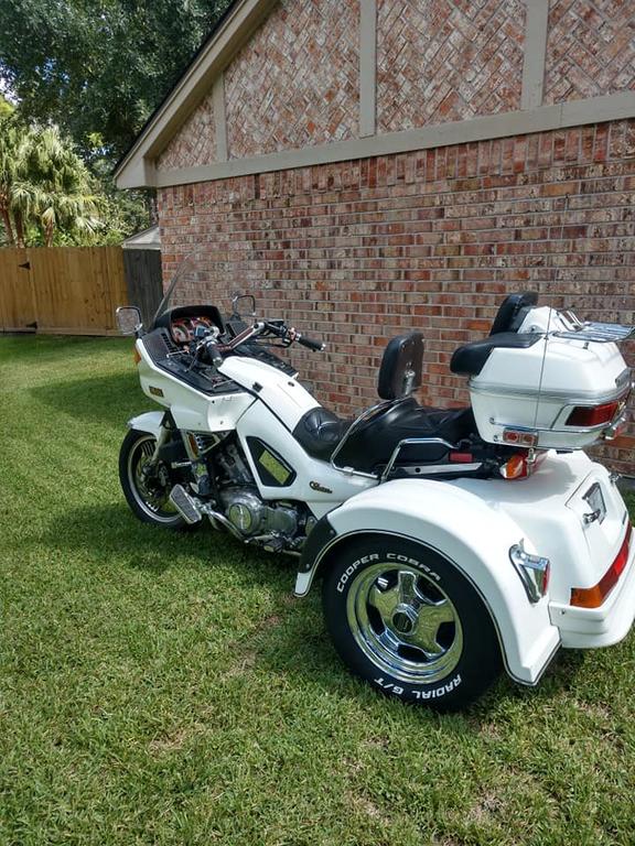

Jcfuzzzyface47 Posted December 22, 2019 #1 Posted December 22, 2019 Hi all, just got a 1989 Yamaha Venture Royal Trike and trying to get in going. Have a dead miss (no compression), have a parts bike with a good engine. Was wondering if anyone does engine swaps?

Jcfuzzzyface47 Posted December 28, 2019 Author #6 Posted December 28, 2019 Not sure where you are with this? If you haven't swapped it yet post the compression results and mileage... Patch The one on bike1,3 & 4 run 140-150 psi, #2 about 20-30 psi. a shot of oil brought 1,3 & 4 up to 165-170. #2 maybe up 5 psi. Not sure of mileage but speedo is about 10,000, sure that's not right extra engine mileage about 40K. Compression on all cylinders are 140-150 shot of oil 185-190. Engine on bike is running but hits only on 2-3 cylinders. John Carman 832 514 9608
