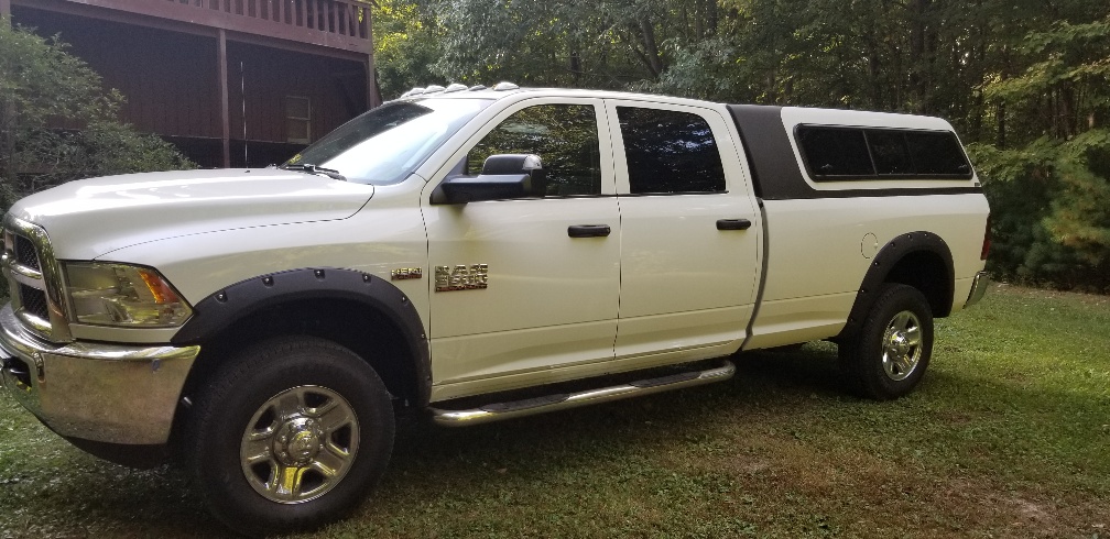

uncledj Posted November 22, 2019 Posted November 22, 2019 I bought a new (to me) pickup. It's a 2017 Ram 2500, crew cab, 4x4 it's a Tradesman, so not a lot of bells and whistles, which is OK by me for a truck. Anyhoo, it's in great shape, low mileage, and after looking at pretty much all the trucks out there 5 yrs old I see a lot of rot...especially around the rear wheel wells. I did a bit of research on how to undercoat, and there's different products out there that people swear by but I decided on Fluid film. I gotta say...I love this stuff. I undercoated the entire vehicle (6 cans) and got the 360 degree spray nozzle on a 3' tube so I could get inside the rockers, doors and wheel wells. A bit smelly for a week or so after treatment, but this stuff creeps like you wouldn't believe. The thing about it is it continues to lubricate as well. On my Expedition, I've the running boards that retract, and they tend to get stuck. (common problem) So, I'd WD40 them every couple of weeks to keep it in check, but if I'd go a month without treating, they'd start sticking again. I treated them with Fluid Film, and it's been over a month with no sticking....not even the hesitation that I'd notice when they started getting tight. I sprayed the coupler on my trailer with it to protect it for winter, and am amazed how smooth it works now. I gotta tell you....Fluid Film is right up there with Seafoam in my book. I'm in no way associated with the company that makes this stuff, but just wanted to share with my Venturerider friends what a great product this stuff is. Take it or leave it, but IMHO this is one of those products that actually works great to protect, or for lasting lubrication.

uncledj Posted November 23, 2019 Author Posted November 23, 2019 Gas. 6.4. Also has the Snow Chief package, which gives it a posi rear end and a 220 amp alternator...both cool with me. I was open to diesel, but couldn't justify the extra $10k, considering I rarely / never tow anything that heavy....with the 6.4 my listed tow capacity is over 14,000 anyway. I bought my last truck in 06 with 30,000 miles on it, and just sold it to a good friend....13 years later....with 95,000 miles on it. Point being, that I don't rack up enough miles on my truck to justify all the miles you supposedly get from a diesel. By my nature, I tend to pick apart things that I buy, but can't find a single thing to complain about with this truck....I've had it for 4 months now and I love it. Great truck.

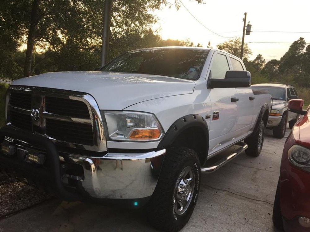

djh3 Posted November 25, 2019 Posted November 25, 2019 I have been looking for awhile now. Just sold my 96 2500 Cummins in like April or so. I was looking for a crew cab probably a year before that. In the price range I wanted to stay in pickings were thin. I ended up with a 2012 Ram 2500 with the 5.7. I would have prefered the 6.4 but I am not really towing anything rite now and if I do get a toy hauler or something we will just stay within our weight, which is like over 12k any ways. 112k on it but its a clean looking truck. Sales man looked at me kinda funny when I crawled under it a few times to look things over. LOL
