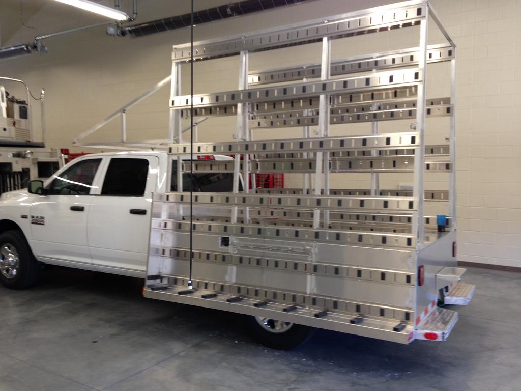

RDawson Posted November 11, 2019 #13 Posted November 11, 2019 Flux core is much more expensive to buy and gas welds are much smoother. CO2 makes a hotter weld but produces more spatter than 75/25. 75/25 is by far my choice unless I'm doing aluminum or stainless when I use straight argon. This is my favorite project I've done using my mig with a spool gun.
djh3 Posted November 11, 2019 #14 Posted November 11, 2019 How do you change a rear tire on that truck?
RDawson Posted November 11, 2019 #15 Posted November 11, 2019 (edited) How do you change a rear tire on that truck? If you look close there is a piano hinge above the tire. You remove two bolts in the ledger board and that door hinges up to get to the tire. They brought me their smaller trucks after this one to add that door, before that they had to remove the glass racks for tires. I built this one from cab n chassis. Edited November 11, 2019 by RDawson
