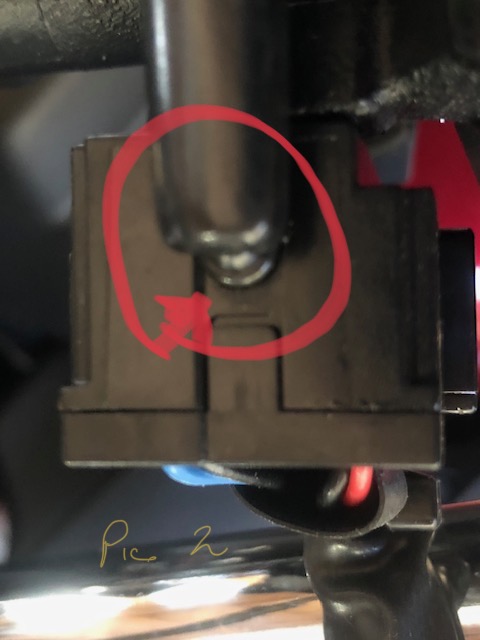

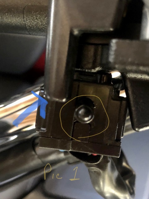

I did some checking on the clutch lever and found a push button switch to be out of alignment. (see pic 1) I put it back into position and it now works. (see pic 2). I have both the gear indication and the cruise control working. Thanks for all the advice, it helped steer me in the right direction.
