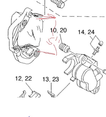

bikerjohn Posted October 24, 2019 Author #13 Posted October 24, 2019 Puc look at my crud drawing I think these will work, i was measuring form bolt to bolt on the outside bots When i got down and looked there is a 3rd bolt that mounts the bracket to the fork That span is 4 inches. I will try it when i get the time and the other caliper in.

BratmanXj Posted October 24, 2019 #15 Posted October 24, 2019 You need to unbolt the caliper AND the bracket from the fork legs and the R1/R6 will bolt directly to the fork legs. I don't have any better photos at this time but can get some more this evening with the old caliper next to the current setup.
