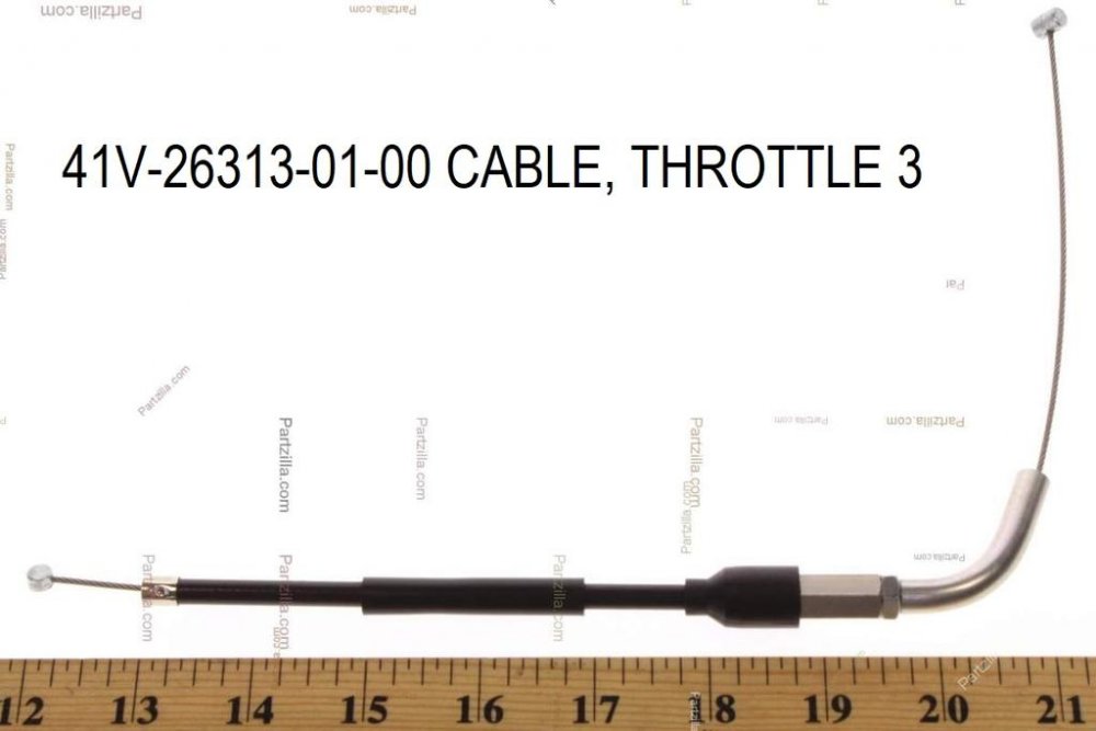

uhfradarwill Posted September 27, 2019 #4 Posted September 27, 2019 I ordered 41V-26313-01-00 from Partzilla when I needed a opening throttle cable for my 89VR. Here is a link: https://www.partzilla.com/search?q=41V-26313-01-00 It fit perfectly. According to web site a 1985 and 1989 use the same cable. Good luck!!

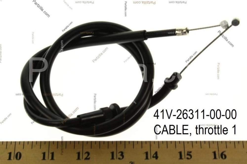

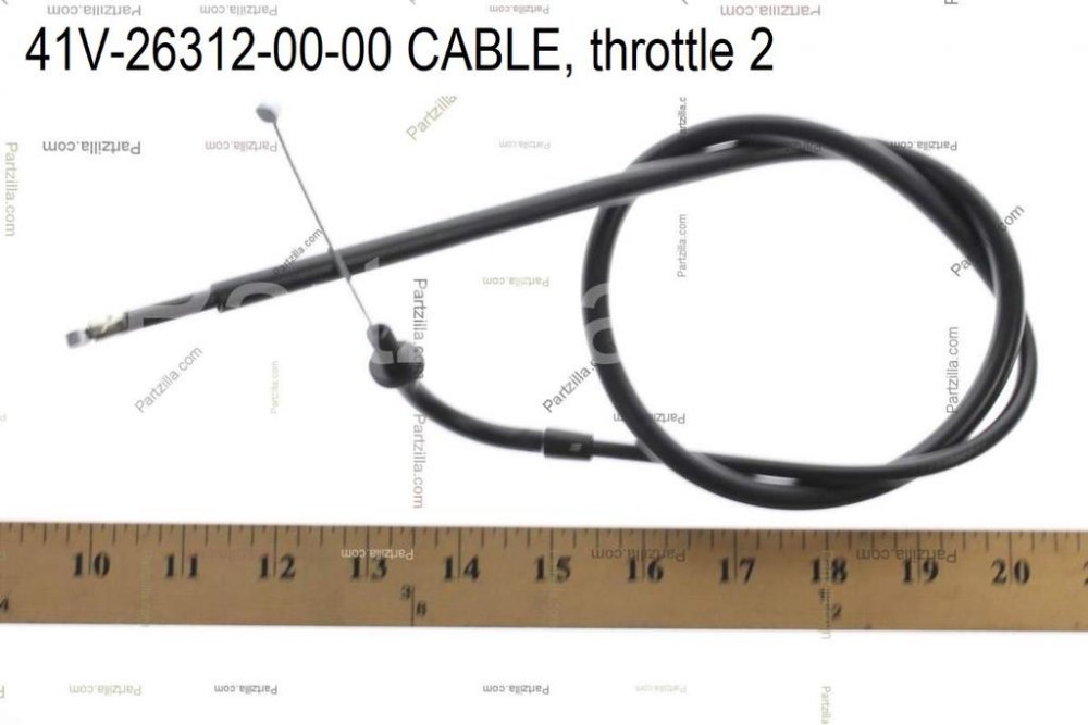

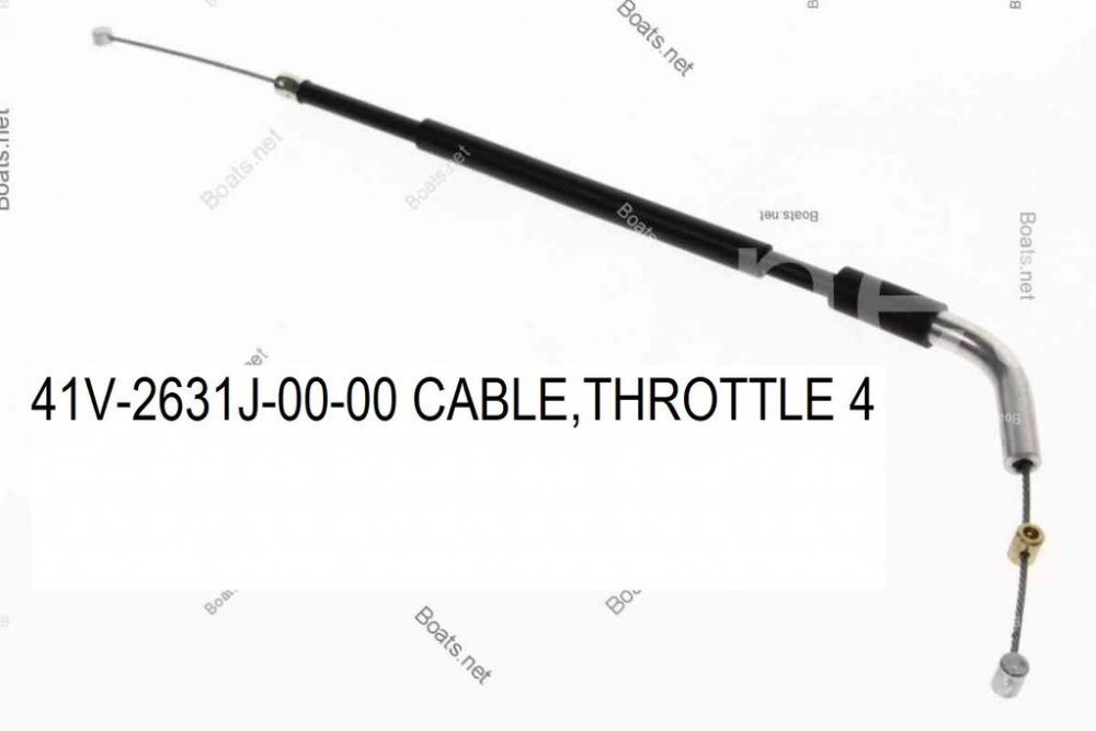

Prairiehammer Posted September 28, 2019 #6 Posted September 28, 2019 I have a 1985 Yamaha Venture Royal that I need a new throttle cable, I have ordered 3 different cables so far and they're all wrong. I am ordering OEM cables too, I tried a few different years. 41V-26312-00-00 41V-26311-00-00 The part numbers on the cable are 41v-00 4j23 and don't match what I ordered. THe angle going into the carburetor is completely different. Any ideas? Thanks!! Part number 41V-26312-00-00, CABLE, throttle 2 and part number 41V-26311-00-00, CABLE, throttle 1 are for the cables from the handlebar to the cable junction. Those cables do not attach to the carburetor. The cables from the cable junction to the carbs are CABLE, THROTTLE 3, 41V-26313-01-00 and CABLE, THROTTLE 4, 41V-2631J-00-00. [h=1][/h]
