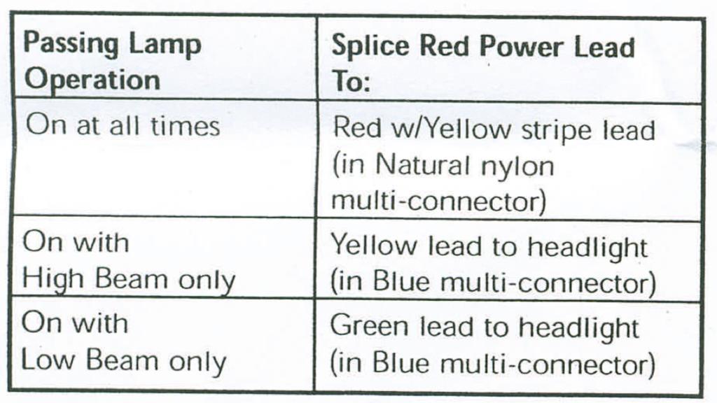

Jthomas Posted September 7, 2019 #1 Posted September 7, 2019 Has anybody modified their lights so that the aux lights operate in low beam instead of just high beam? I would think it would be fairly simple. 07 RSV
Freebird Posted September 7, 2019 #2 Posted September 7, 2019 A lot of us have them, or had them, wired that way. Just open the fairing and change where the wire is connected.
Jthomas Posted September 8, 2019 Author #3 Posted September 8, 2019 Cool. Where are these wires located at?
Rafterd Posted September 9, 2019 #4 Posted September 9, 2019 Mine are on all the time. Low or high beam.
djh3 Posted September 11, 2019 #5 Posted September 11, 2019 Mine were rewired. I looked into wiring them so I could have them on anytimes. When opening it up the system was fused with an old glass fuse, and the holder was melted. So I wired it fused thru a relay and the black push button switch on left lower side. As long as switch was on lights were on.
