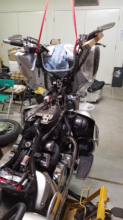

Scribz Posted September 6, 2019 Author Posted September 6, 2019 So... after screwing around for hours trying to get the Mr. Gasket 42S pump to fit in the tight quarters of the location of the original fuel pump, I wired it up and..... dead. It would whine like it was trying to prime, but nothing came out. So I returned it to Autozone, and since they didn't have another one in stock, I went across the street to O'Reily's and spent 20 bucks more on an Edelbrook pump (Mexican made instead of Chinese). Brought it home, and within 5 minutes I had the bike up running. The proof will be when I get it all hardwired on Sunday and take it out for a test ride. I had to modify the sidecover a small amount to get the pump to fit, but it was a small bit of trimming on one of the tabs that the posts on the middle cover fit into. No big deal there..... 1

Scribz Posted September 8, 2019 Author Posted September 8, 2019 Just finished with everything, bolted the cowlings back on and went for a brief ride before rain moved in. The Edelbrock fuel pump seems to be working awesome! I will need to get her out on the road for a long drive to fully test her, but I'm very pleased! Here's everything I did while I had it torn apart: oil and oil filter changed, air filters changed, rear gear case oil drained and changed, all points requiring lubrication done, and spark plugs changed. Outside of carbs cleaned and lubricated and deep-cleaning in the areas normally not accessible done.
