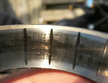

MiCarl Posted July 23, 2019 #4 Posted July 23, 2019 Anyone who has this going on should repair it. It has the potential to start oscillating into an uncontrollable situation known as "death wobble". bingo! That detent is the cause of your wandering. The detent is because of worn (indented) steering head bearings. The race develops an indent where the roller of the bearing is constantly hammering into it. The rollers sometimes develop a flattened surface for the same reason. Replace the steering head bearings. https://www.venturerider.org/forum/attachment.php?attachmentid=117148https://www.venturerider.org/forum/attachment.php?attachmentid=117149

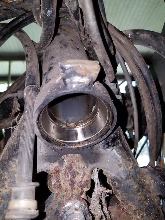

jrich Posted August 11, 2019 Author #8 Posted August 11, 2019 Thanks for everyone's advice, finally got around to working on the steering head. The bearings were solid with old grease and the races were detented. Replace top and bottom bearings and she's steering great. No more wandering. Thanks again!

jrich Posted August 24, 2019 Author #10 Posted August 24, 2019 That's great news, I plan to do mine as well. I'm not super DIY guy, but have found a few videos on the web and instruction on this website. Did you just take front tire off, drop forks and have at it? Where the races difficult to pound out? Yes, took off front tire, then the shocks disassembled easily from the steering head. It was difficult getting the bearings out. The bottom was the easiest, since there are some cut outs in the steering head body that let you get a punch in from the top to drive out the bottom race. The top on the other hand has no such cut outs. I ended up welding a bit nut inside the upper race, then I was able to easily drive it out from the bottom. Good luck, it's not too bad, just go slow, don't get in a hurry, you'll be just fine.
