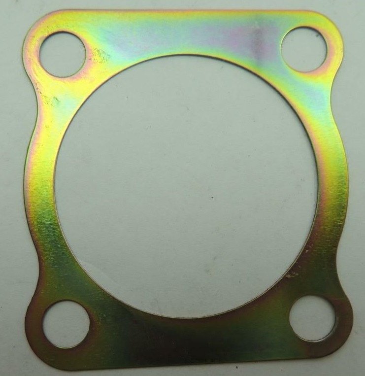

Du-Rron Posted July 20, 2019 Posted July 20, 2019 (edited) Hey @cowpuc Finally found Yamaha Tech Bulletin M83-021 for 1st Gens to use the special TAPERED SHIMS (Yamaha part number 90891-20026-00) to align the rear end. M83-021 M83-022 Rear End Clicking Noise .pdf https://www.ebay.com/itm/90891-20026-00-NOS-Yamaha-Tapered-Shim-XVZ1200-S94a-/312191527142?_trksid=p2349526.m4383.l4275.c1 Edited July 20, 2019 by Du-Rron
cowpuc Posted July 20, 2019 Posted July 20, 2019 Hey cowpuc Finally found Yamaha Tech Bulletin M83-021 for 1st Gens to use the special TAPERED SHIMS (Yamaha part number 90891-20026-00) to align the rear end. https://www.venturerider.org/forum/attachment.php?attachmentid=117104 https://www.ebay.com/itm/90891-20026-00-NOS-Yamaha-Tapered-Shim-XVZ1200-S94a-/312191527142?_trksid=p2349526.m4383.l4275.c1 https://www.venturerider.org/forum/attachment.php?attachmentid=117105 I didn't doubt your indepth knowledge at all brother but am still amazed at this = EXCELLENT find there Duey!! It would be interesting to know how many, if any, of our members purchased those shims, installed them and were successful in their intended application use!! WAYYYYY COOL of Mom Yam to take those corrective actions - this also makes me wonder if there a LOT more folks with scoots with strange brake pad wear through the years (+ other applicable happenings like strange noises and other wear points).. Did Mom Yam only produce this tapered shim for the 1st Gens or is this applicable to the 2nd Gens too? THANKS for the followup Duey = YOU DA MAN!!
Du-Rron Posted July 21, 2019 Posted July 21, 2019 I didn't doubt your indepth knowledge at all brother... Oh I know. But I knew I remembered seeing this and I wanted to find it for me as well. ... Did Mom Yam only produce this tapered shim for the 1st Gens or is this applicable to the 2nd Gens too? There was a different TSB issued for the 2nd Gens's and I didnt have any trouble aligning mine fore/aft when it needed it. If on a 2nd Gen if you needed more of the port/starboard/yaw alignment thing (very rare) , I bet these shims would fit the 2nd Gens. In any event, even with my rear end aligned as per the TSB the pads still wear faster (still flat though) on the right side vs the left side. The rear end is quiet though.
