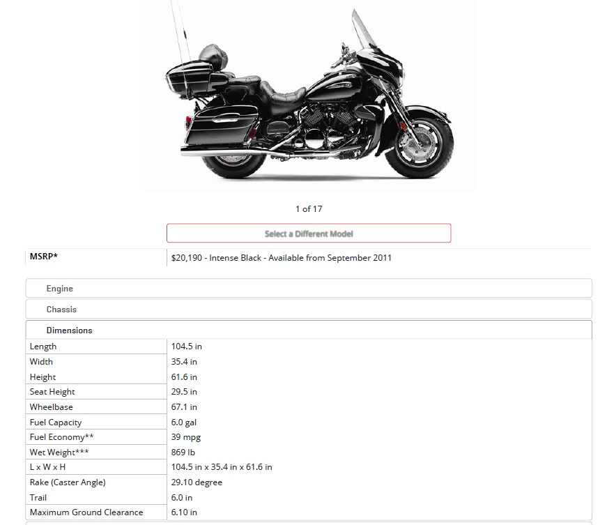

Nope. Your engine and/or clutch is sick and/or your brakes are dragging badly. Standard diagnostics would apply. Yamaha says it will average 39. I get about 31-35 on E10 gas @ 2000 ft above sea level.

When we are on the trike, we are almost always 2 up and towing, with the cargo trailer we average 25-27 MPG, with the camper in tow 20-25 MPG. NO tow 29-32 MPG. We for the most part follow the speed limits. I've found that if you short shift it your fuel mileage will suffer.
