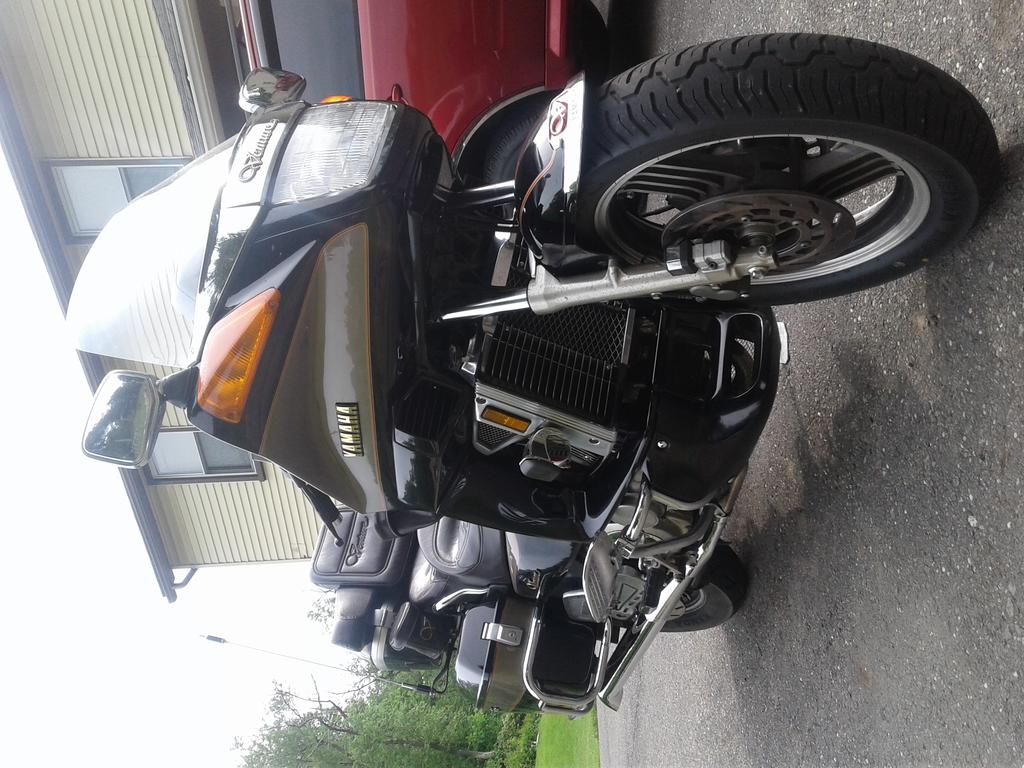

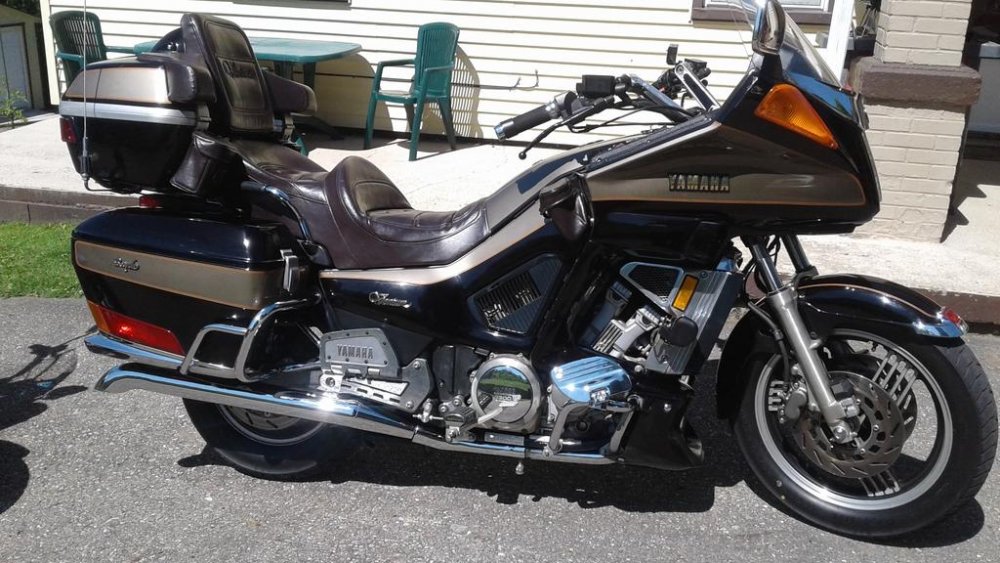

Royale Rider XVZ Posted July 2, 2019 Posted July 2, 2019 Just change front forks seals and found 2 1/2" inch spacers in the tubes!? Why? What is recommended air pressure for the fronts and is there a max psi? any advice on the 1986 VR air ride system ................

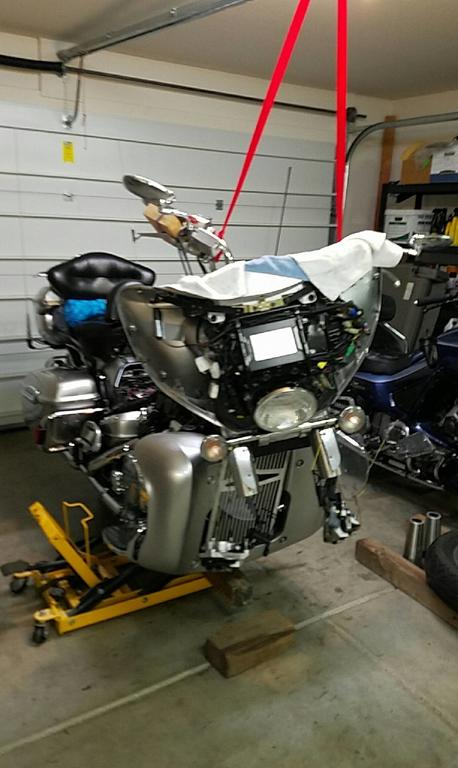

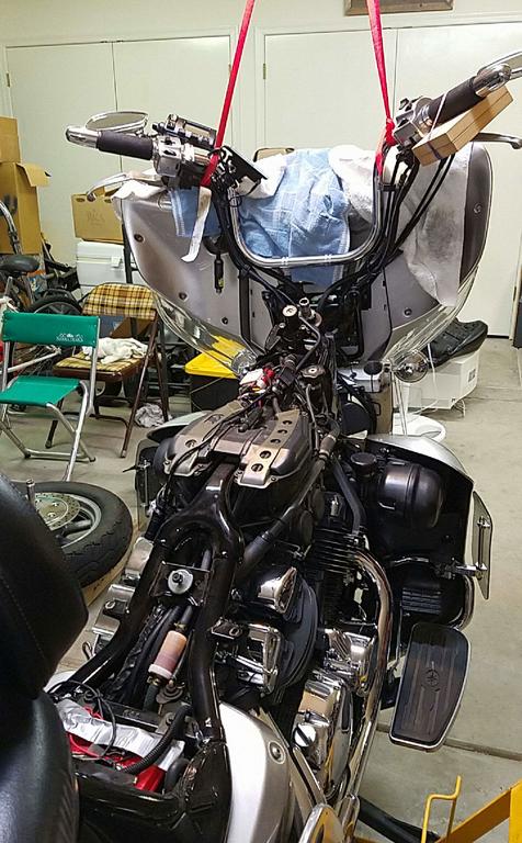

videoarizona Posted July 2, 2019 Posted July 2, 2019 I'm picking up a 27mm spanner on my way home today... See if I can get the top nut loose to do the steering head bearings 'cheat' tighten If that doesn't work (remove the 'wobble') this will be next. I do think it's the head bearings though... Its got the same deceleration wobble my VN1500 had... Steering head bearings were changed on that and it handles great now. I just hope they don't need replacing... My mechanic seems reluctant to do it due to the massive amount of work involved (fairing off ect)... Not that hard at all. I got to mine when I replaced my front fork seals. First time I've ever gone down this far into a bike. Took about 2 hours to get down to the bearings..... Most of the steps I used I got from various posts on this site... Between you and your mechanic...you can do this. Seriously!

Patch Posted July 3, 2019 Posted July 3, 2019 Just change front forks seals and found 2 1/2" inch spacers in the tubes!? Why? What is recommended air pressure for the fronts and is there a max psi? any advice on the 1986 VR air ride system ................ What would serve you best is to post in this forum: https://www.venturerider.org/forum/forumdisplay.php?8-Venture-and-Venture-Royale-Tech-Talk-(-83-93) And the guys will walk you thru all the steps! Patch
