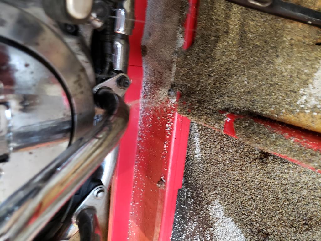

Midicat Posted June 6, 2019 #1 Posted June 6, 2019 So tried (key word here is tried) to start her up today and after many cranks I have fuel pouring out of the carbs. Flooded big time? She just wouldn't catch. Thoughts? Thomas
Midicat Posted June 6, 2019 Author #2 Posted June 6, 2019 Here's where it's dripping out. Sorry pic is sideways. Thomas
rbig1 Posted June 7, 2019 #3 Posted June 7, 2019 drain the float bowls and catch the fuel out of each one separate. See how much crud comes out
BlueSky Posted June 7, 2019 #4 Posted June 7, 2019 Is fuel pouring out of all four carbs? It's probably due to the fuel needle leaking. Be careful. You don't want to hydrolock the engine. I agree with draining the carbs maybe several times to see if the crud under the seat will flush out.
CaseyJ955 Posted June 7, 2019 #5 Posted June 7, 2019 Through the overflow tube? it's hard to see in the pic. I believe even one stuck needle valve will send enough raw fuel through the overflow tubes to overwhelm the other carbs too, aside from leaking out externally. If the above guidance does not get you on the road then you should be able to remove the overflow tube set and see which specific carb/s are actually flooding. That might be handy if you get the carbs out and see nothing to indicate any issues. If the above does not work and the problem persists it may become necessary to slide (see how easy I made that sound) the carb rack out. I would venture to say that if it was stored all winter with ethanol then you may have to manually scrape and blow the crap out of each carb. If no ethanol then maybe a few taps with a screwdriver handle and some fresh fuel/seafoam will loosen her up a bit.

Patch Posted June 8, 2019 #10 Posted June 8, 2019 I may be wrong but I see a spray pattern? If that is so then I would check the tubing from the pump to the carbs.
