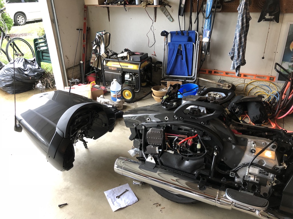

I had mine off for the purpose of installing a trailer hitch. I just looked and found that I didn't take a picture that would help you much. Here is what I have though.

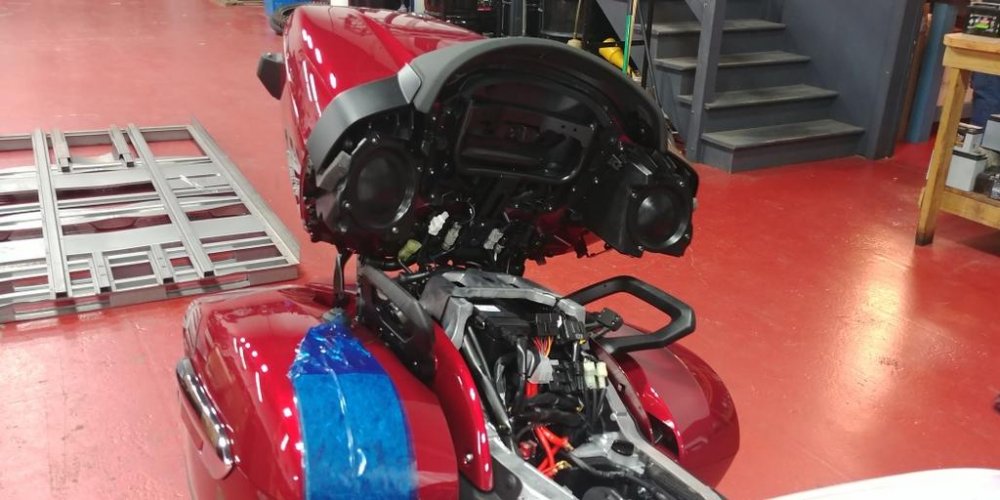

Hi Freebird, been awhile, you are correct, my bike after the crate was removed

This thread is extremely interesting to me, and I am sure others as well. It is good to see the rear fender is not "deformed" to account for the trunk.
Did the bags need to be removed to get to the hardware to remove the trunk?
Did it look as though the wiring would tuck under the seat or would a "cover" need to be devised to tidy the wiring?
Was the seat cleanly finished on the back?
I wonder if performing a modification to the Eluder bracket for the backrest would suffice to allow for a "quicker" release function for the trunk?
Thanks so much for the pics!

The fender is not deformed, and the bracket itself is just a couple bolts. Mine was lowered and installed when I was away, but I do npt think the left saddlebag was removed for that operation...only four bolts and an electrical clip. The issue is that there are seven clips on the back rest and two wires, antenna, I believe that are not in clips. I should think you could hide them all in small bag behind the rear seat, and there may be just enough room to tuck them under it... I think it woild look pretty clean. My dealer laughed and said I was crazy...in a nice way....
