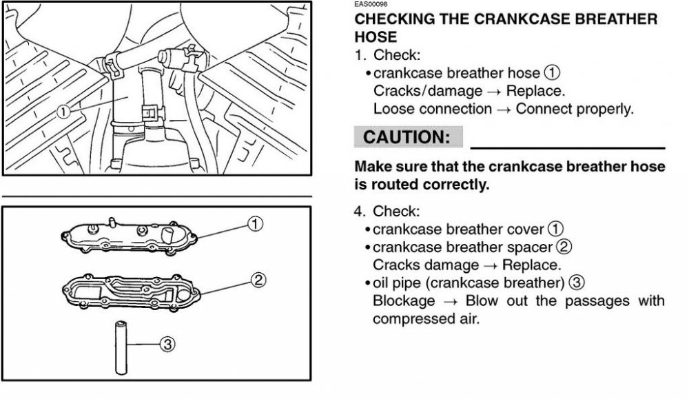

M61A1MECH Posted May 27, 2019 #5 Posted May 27, 2019 Mariner Fan said: Yes, the bike is level when I check the oil level. I’m taking it to the shop anyway but was hoping someone here would have an idea why this is happening Oil fumes are supposed to get sucked up to the airbox with the idea that they will go into the carbs as vapors and be burnt during the combustion process, but during hard running at highway speeds the oil can be "sloshed" around and either more fumes than the system can handle or liquid oil can get sucked up to the air box. The excess fumes will eventually condense back to liquid and run to the low point in the air box where the hose is, and any liquid sucked up will immediately drop to the bottom f the air box and find its way to the drain tube. Checking the air box periodically for liquid oil is a PM sort of thing, I would do mine maybe once a year or so, there was always some liquid oil present and I never over filled my crankcase. If there is an excessive amount of oil then there may be a real problem some where, otherwise I would clean it and motor on and check it at some regular interval to monitor the build up.

cowpuc Posted May 27, 2019 #9 Posted May 27, 2019 All IMHO and just that,, opinion here.. All 4 stroke engines have to vent the crankcase. The amount of oil "gases" being caught up in the vented can change for many reasons and HEAT causing vaporization is very common. Having answered the question of what level you are filling the case to has been answered so no since in doubling back on that = as long as your filling on the site glass while the bike is upright and level. Years ago I sold numerous Chinese Scooters and had a couple catastrohpic failures come back due to long distance running at speed without checking oil consumption at each fuel fill = the case held less then 1 quart of oil and, under certain conditions (heat being one) the little 150cc 4 stroke would ventilate/aspirate the oil to the point the bike would burn down. After learning that some of my customers found checking the oil to be to much of an issue, I started experimenting with variety of oils to see if one brand/weight of oil would vaporize less then others and ended up scoring big time.. I am in the middle of putting together a huge wedding right now and dont have time to dig into shop notes from years ago to figure out which oil(s) proved the best results but can tell you that the answer to the issue may very well be found in just switching to a different oil platform. On my 1st Gens I always noticed a HUGE difference in this just by going to 20/50 weight when chasing the desert regions.. I would try this before defaulting to the thought that the engine needs a rebuild.. Hope ya figure it out Puc

Du-Rron Posted May 27, 2019 #11 Posted May 27, 2019 Mariner Fan said: This only happens when the engine is hot. I pulled the tank and sure enough there is oil residue in and below the air box above the carbs on the drivers side. Any ideas? I’m at a loss. Ok, RESIDUE is what you said. Not liquid oil right? "Residue" is ok. Liquid oil is not. If you have liquid in your airbox I am going with @videoarizona on this one as a blocked air vent. The oil is vaporizing and allowed to go up but when condensed, is slow to go back down. Check for a blockage. I live in Texas so I know a little something about heat. I run 10W-40 and on long trips at cruising speed I will even get a hint of oil mist out the breather tubes to the airfilters and I notice this because I clean the air filters every oil change, (blow off the big bugs at least) . I am talking about "residue", a couple drops, mist that has condensed back to liquid in the tubes and on the foam blockers in the leg guards, when I go slower than warp factor 1. Nothing to write home about. So... if you ride like a nut job in 100 degree heat at Warp 7 like I do, "residue" found inside the airbox every 5 or 10 thousand miles is perfectly ok. Here is how to check the breather. In fact, on some bikes, you have to dump out the LIQUID oil from the airbox reservoir every 4K miles or so and this is part of regular maintenance and applies to bikes that have the correct oil level.

M61A1MECH Posted June 17, 2019 #19 Posted June 17, 2019 Most common problem that causes oil in the coolant is the water pump seals going bad, there is a vent hose for the chamber between the coolant galleries and the oil galleries that may show signs of coolant dripping that would indicate the seals, I had one fail but never had any weeping at the vent.

M61A1MECH Posted September 21, 2019 #21 Posted September 21, 2019 Yes, see my post #19 , I speak from experience it happened to me on my 98 Royal Star Tour Classic. You should start with the oil pump / water pump assembly. The seals on the common shaft can and do fail allowing oil to get into the cooling system. It is a pain to get all of the oil out of the cooling system, some have flushed their cooling systems with a mixture of water and dawn dish soap followed by a couple of flushes of distilled water to remove the soap residue and minerals that the water may have left behind. The twinky is the long oval sapped part that sits between the cylinders has a few hoses on it, it is actually a heat exchanger. This issue has been reported by several here and also on the Delphi Royal Star forums. Good luck , report back how you make out.

M61A1MECH Posted September 22, 2019 #25 Posted September 22, 2019 You may have two different issues here. First oil in the coolant overflow is bad, needs to be corrected as I noted above. Second, there are three drain hoses as I recall under the bike on the left side near the side stand, one of them is a drain hose from the air box, it is quite normal to get some oil fumes up into the air box, that is what the crankcase breather does, suck fumes off the crank case and takes them up to the air box so the fumes can go through the carbs and out the exhaust pipes. If you over fill the crank case or run at high revs for a prolonged period of time the oil can splash around and liquid oil will be sucked up through the crank case ventilation hose and be deposited in the air box. The drain hose for the air box is on the left side so it is naturally on the low side of the air box when the bike is parked on the side stand. If there is an excess of oil accumulated in the air box over time it will run down the drain hose and drip on the ground. Open the air box and clean out any liquid oil n there and dry the drain hose to remove any accumulated liquid, then monitor for further drips from that drain hose. Also make sure the oil is not above the line on the window when the bike is standing straight up.
